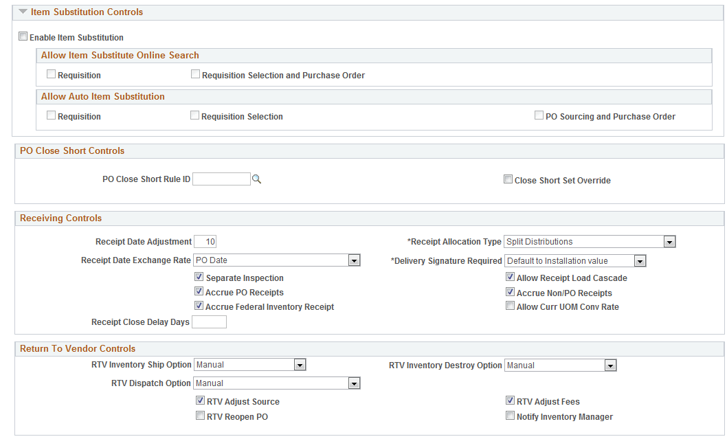

To allow Item Substitution in Procurement, you must enable Item Substitution at the business unit level in order to activate the item substitution functionality. You can then determine the item substitution options that work best for your organization or company. This section discusses how to:
Set up item substitution at the Purchasing business unit level.
Define item substitution priorities at the supplier level.
Define item substitution priorities at the item level.
Designate items for substitution only.
Override auto item substitution.

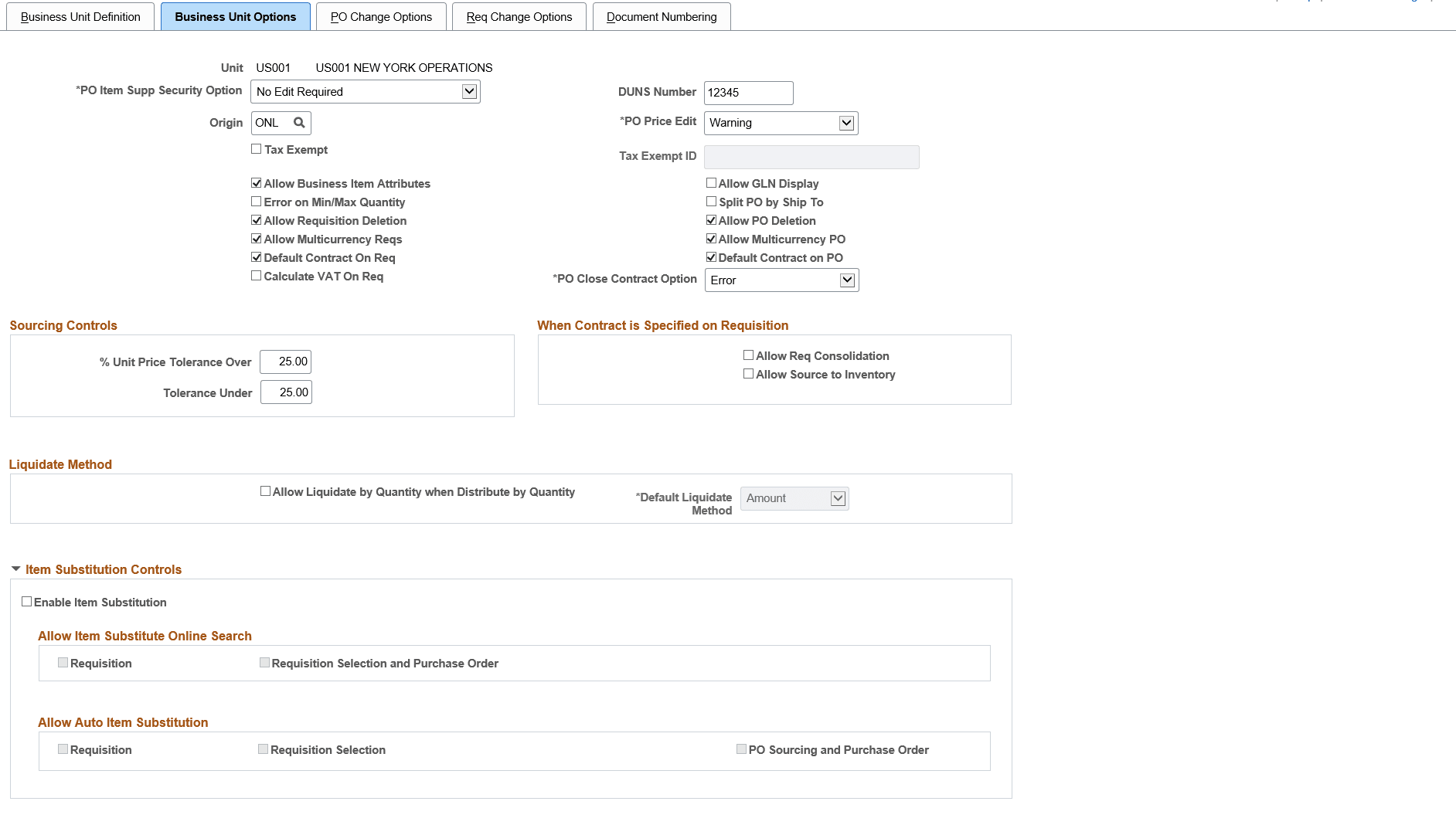

Setting Up Item Substitution at the Purchasing Business Unit Level
Use the Business Unit Options page to set up Item Substitution for a Purchasing Business Unit.
Navigation:
This example illustrates the fields and controls on the Purchasing — Business Unit Options page. The fields and controls that appear in this page are discussed following the examples.
This example illustrates the fields and controls on the Purchasing — Business Unit Options page (2 of 2). The fields and controls that appear on this page are discussed following the examples.
The Business Unit level option controls whether Item Substitution is turned on for the Purchasing business unit. When you select the Enable Item Substitution check box at the Business Unit Options level, the Allow Manual Item Substitution and Allow Auto Item Substitution sections will become available for selection.
If you select check box, all Item Substitute fields will be enabled on the Requisition, the Requisition Selection/Requisition Expediter, the Sourcing Workbench, the purchase order, the receipt, and other applicable components, as needed.
The Requisition check box under the Allow Item Substitution section allows you to enable manual item substitution on the Requisition (core and ePro). The Requisition Selection and check box allows you to enable manual item substitution during Requisition Selection and on the Purchase Order.
The Requisition check box under the Allow Auto Item Substitution section allows you to enable manual automatic item substitution on the Requisition (core and ePro). The Requisition Selection and PO Sourcing and Purchase Order check boxes allow you to enable manual item substitution during Requisition Selection, PO Sourcing, and on the Purchase Order.
Note: While setting up the item substitution controls, you must ensure that you have selected at least one check box in the Allow Item Substitute Online Search and Allow Auto Item Substitution sections.
