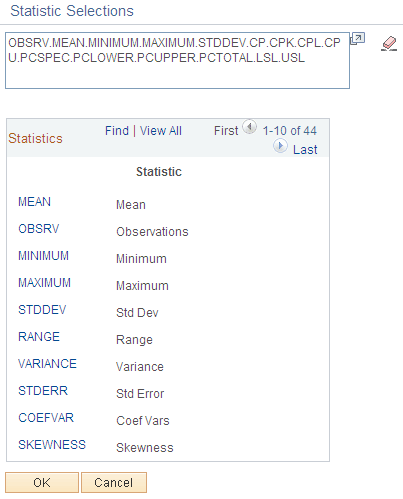

Use the Statistic Selections page (QS_STATSELECT_PNL) to associate statistics with control charts, histograms, or Pareto charts.
Navigation:
Click the Statistics List link on the Define Graph Preferences page.
This example illustrates the fields and controls on the Statistic Selections page. You can find definitions for the fields and controls later on this page.
Use the scroll function to display all statistics and associated descriptions that are available in the Statistics Catalog. Click the different statistics links to select and place them into the list for the graphic or display. The following table shows the 44 statistics that are available on the Statistic Selections page.
