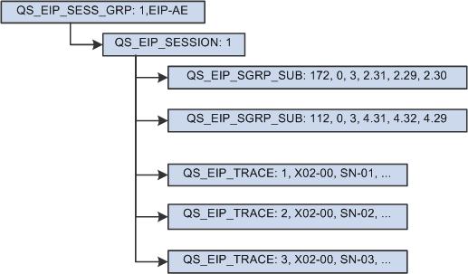

Scenario # 3
A measurement plan that contains variables type characteristics with non-uniform subgroup sample sizes.
Sample |
Lot Number |
Serial Number |
Length |
Width |
1 |
X02-00 |
SN-01 |
2.31 |
4.31 |
2 |
X02-00 |
SN-02 |
2.29 |
4.32 |
3 |
X02-00 |
SN-03 |
2.30 |
4.29 |
4 |
X02-00 |
SN-04 |
none |
4.30 |
5 |
X02-00 |
SN-05 |
none |
4.31 |
This diagram illustrates scenario #3 that has a measurement plan containing variables type characteristics with non-uniform subgroup sample sizes.

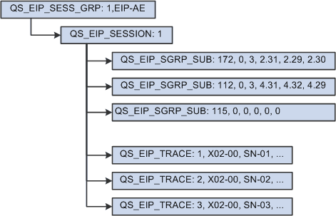

Scenario #4
A measurement plan with variables type characteristics with readings for one of the characteristics that is incomplete. In this scenario, length readings are incomplete.
Sample |
Lot Number |
Serial Number |
Length |
Width |
1 |
X02-00 |
SN-01 |
2.31 |
4.31 |
2 |
X02-00 |
SN-02 |
2.29 |
4.32 |
3 |
X02-00 |
SN-03 |
2.30 |
4.29 |
4 |
X02-00 |
SN-04 |
4.30 |
5 |
X02-00 |
SN-05 |
4.31 |
This diagram illustrates scenario #4 that has a measurement plan containing variables type characteristics with readings for one of the characteristics that is incomplete.

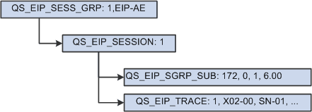

Scenario #5
A simple defectives type sample where the subgroup size is fixed.
Sample |
Lot Number |
Bad Units |
1 |
X02-00 |
6.00 |
This diagram illustrates scenario #5 that has a simple defectives type sample where the subgroup size is fixed.

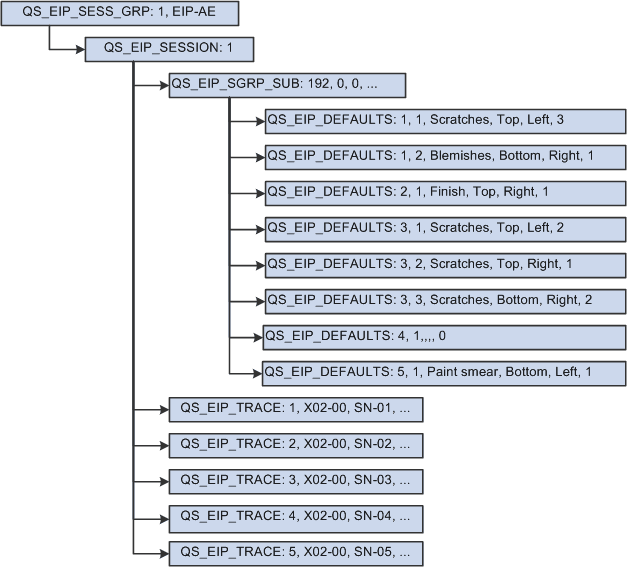

Scenario #8
A measurement plan with defects data type characteristics where the subgroup sample size is fixed or variable.
Sample |
Lot Number |
Serial Number |
Physical Defects * |
1 |
X02-00 |
SN-01 |
3 Scratches, Top, Left 1 Blemishes, Bottom, Right |
2 |
X02-00 |
SN-02 |
1 Finish, Top, Right |
3 |
X02-00 |
SN-03 |
2 Scratches, Top, Left 1 Scratches, Top, Right 2 Scratches, Bottom, Right |
4 |
X02-00 |
SN-04 |
No defects |
5 |
X02-00 |
SN-05 |
1 Paint smear, Bottom, Left |
Note: * Physical Defects is a user-defined characteristic name and not a predefined type.
This diagram illustrates scenario #8 that has a measurement plan with defects data type characteristics where the subgroup sample size is fixed or variable.

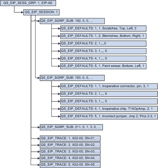

Scenario #9
A measurement plan with two defects data type characteristics where the subgroup sample size is uniform.
Sample |
Lot Number |
Serial Number |
Electrical Defects * |
1 |
X02-00 |
SN-01 |
1 Inoperative connector, pin, 3 |
2 |
X02-00 |
SN-02 |
No defects |
3 |
X02-00 |
SN-03 |
No defects |
4 |
X02-00 |
SN-04 |
No defects |
1 Inoperative chip, 741OpAmp, 2 |
5 |
X02-00 |
SN-05 |
1 Paint Smear, Bottom, Left |
I Incorrect jumper, Jmp 2, Pins 2-3 |
Note: * Physical Defects and Electrical Defects are user-defined characteristic names and not predefined types.
This diagram illustrates scenario #9 that has a measurement plan with two defects data type characteristics where the subgroup sample size is uniform.

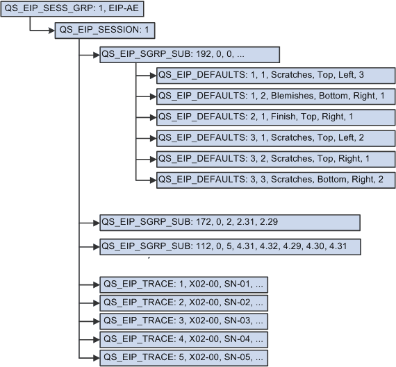

Scenario #10
A measurement plan with variables and defects data type characteristics with a uniform subgroup sample size of 5.
Sample |
Lot Number |
Serial Number |
Length |
Width |
1 |
X02-00 |
SN-01 |
2.31 |
4.31 |
2 |
X02-00 |
SN-02 |
2.29 |
4.32 |
3 |
X02-00 |
SN-03 |
2.30 |
4.29 |
4 |
X02-00 |
SN-04 |
No defects |
2.30 |
4.30 |
5 |
X02-00 |
SN-05 |
2.31 |
4.31 |
This diagram illustrates scenario #10 that has a measurement plan with variables and defects data type characteristics with a uniform subgroup sample size of 5.

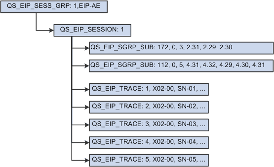

Scenario #11
A measurement plan with variables and defects data type characteristics and a non-uniform subgroup sample size.
Sample |
Lot Number |
Serial Number |
Length |
Width |
1 |
X02-00 |
SN-01 |
2.31 |
4.31 |
2 |
X02-00 |
SN-02 |
2.29 |
4.32 |
3 |
X02-00 |
SN-03 |
none |
4.29 |
4 |
X02-00 |
SN-04 |
none |
none |
4.30 |
5 |
X02-00 |
SN-05 |
none |
none |
4.31 |
his diagram illustrates scenario #11 that has a measurement plan with variables and defects data type characteristics and a non-uniform subgroup sample size.

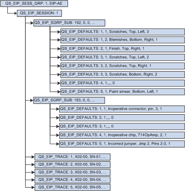

Scenario #12
A measurement plan with two defects and one defectives data type characteristics where the subgroup sample size is uniform.
Sample |
Lot Number |
Serial Number |
Bad Units |
1 |
X02-00 |
SN-01 |
3 |
2 |
X02-00 |
SN-02 |
No defects |
No defects |
none |
3 |
X02-00 |
SN-03 |
No defects |
No defects |
none |
4 |
X02-00 |
SN-04 |
No defects |
none |
5 |
X02-00 |
SN-05 |
1 Incorrect jumper, Jmp 2, Pins 2-3 |
none |
This diagram illustrates scenario #12 that has a measurement plan with two defects and one defectives data type characteristics where the subgroup sample size is uniform.
