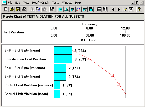

Use the Pareto Chart panel to view attribute data in descending order of frequency of occurrence.
Navigation:
Click the Pareto button.
This example illustrates the fields and controls on the Pareto Chart panel. You can find definitions for the fields and controls later on this page.
A Pareto chart is comprised of multiple graph panes (sections) and includes information about the subset that you are examining. You can resize the sections the same way that you resize histogram sections.
When you click a cell, it becomes crosshatched to highlight it. When you click the Redraw button, the Pareto chart is redrawn with the crosshatched cells removed. This is useful to examine a smaller portion of the data or compare certain attributes only. When you click the Restore button, the Pareto chart is redrawn in its original state. The redraw and restore functions only apply to the Pareto chart that you are currently manipulating and do not affect other Pareto charts.
When you select multiple subsets on the Selector panel and click the Pareto button, the chart that is initially displayed is a composite of all the subsets selected. From there, you can cycle and view the individual Pareto charts (layers) corresponding to each subset. For example, if you selected three subsets on the Selector panel, the system generates four Pareto charts. The first Pareto chart displays a composite of all the subsets, and there is also a Pareto chart for each individual subset.
Note: Each chart is displayed, one at a time, within the existing tool window.
Note: The Attribute column role assignment on the Selector panel determines which attribute appears on the Pareto chart.
Title Section
This section includes a heading that indicates which subset of data and attribute you are currently analyzing. In the previous illustration, the attribute being analyzed is Defects, and the Pareto chart being displayed is for all the subsets that you selected on the Selector panel.
If you filter the attributes, either by clicking a cell or by using the Modify Pareto Chart dialog box, you'll see (Filtered) in the title section.
Scale Section
This section displays the name of the data column that you are analyzing and a scale that exhibits the display limits for the Pareto chart. In the illustrated panel, the data column is Defects and the scale is Frequency.
Chart Section
This section contains the main body of the Pareto chart, including a description of each attribute, the attribute count, and the percentage of the number of defects for which that attribute accounts. The red line represents the cumulative percent line, also known as the Lorenz curve.
Note: Cell values excluded from the graph are local to the active window; the dataset is not altered.
