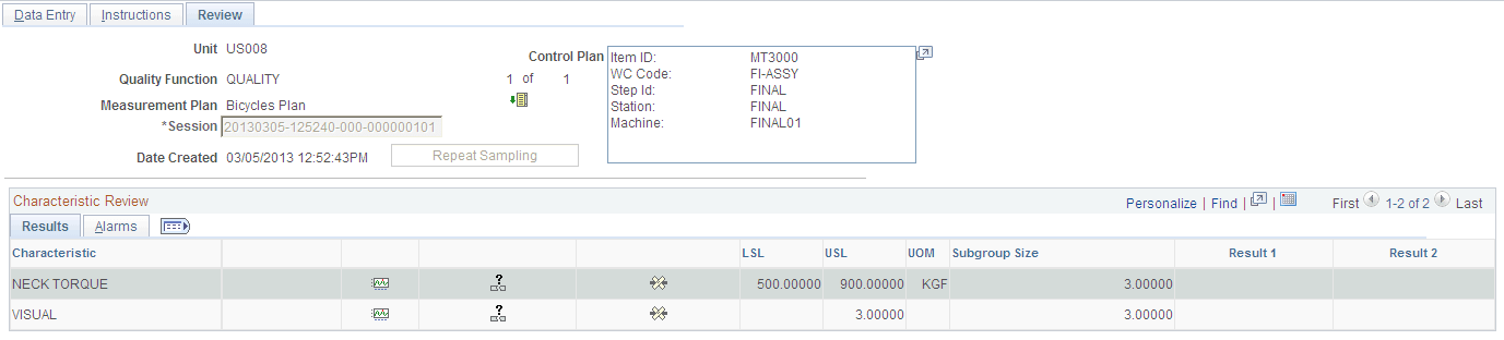

Use the Review page (QS_DE_REVIEW8) to review results and alarms for each characteristic on the control plan.
Navigation:
Click the New Session or Pending Session buttons on the Data Entry From Access List page.
Click the New Session or Pending Session buttons on the Data Entry By Control Plan page.
Click the Pending Session button on the Update Data By Control Plan page.
This example illustrates the fields and controls on the Review page: Results tab. You can find definitions for the fields and controls later on this page.
Control plans usually contain more then one characteristic. As you enter readings for a plan, you can review what has been analyzed. This page displays information and current subgroup results for each characteristic and is the same, whether you enter data for a new session, maintain a pending session, or edit a completed session.
In the upper-right portion of the page, a text box displays the hierarchy fields associated with the control plan. Each control plan characteristic appears in the Characteristic column.
Field or Control |
Description |
LSL (lower specification limit) and USL (upper specification limit) |
Displays the lower and upper specification limits for the characteristic. |
Subgroup Size |
Displays the subgroup size. |
Result 1 and Result 2 |
Displays the subgroup results, based on the associated control chart calculated from the readings. |
