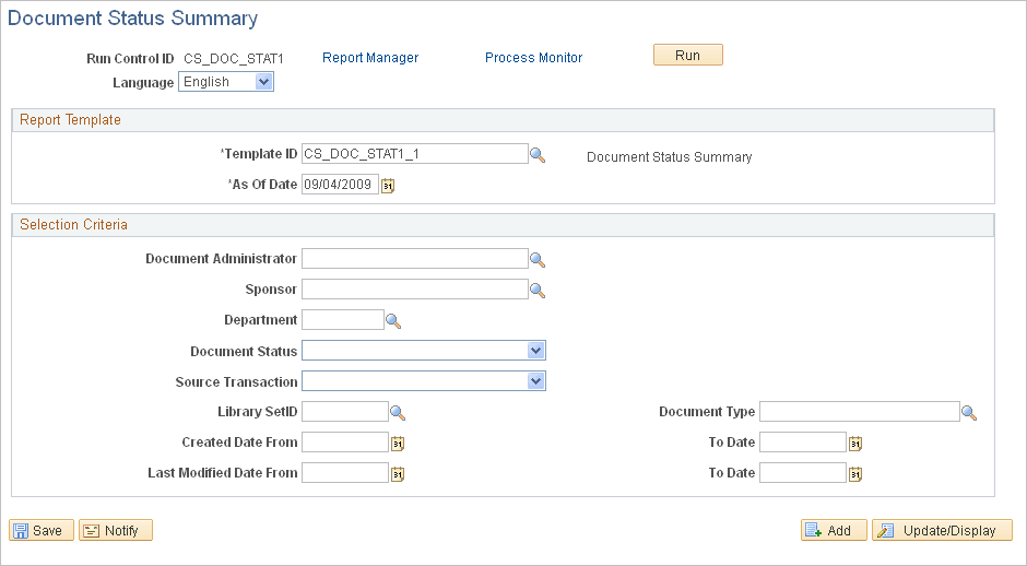

Use the Document Status Summary page (CS_RPT_DSTAT1) to create Document Status Summary reports.
Navigation:
This example illustrates the fields and controls on the Document Status Summary page.
You use this page to run the Document Status Summary report process (CS_DOC_STAT1). This report provides basic document status information for the documents that you select to include in the report. When the system does not locate report data, the report contains a No Data Found line. The last page of a report also has a End of Report line.
The report is sorted by library SetID, then source transaction, document type, administrator, ad hoc SetID/ad hoc ID, contract SetID, contract ID, and purchase order business unit/purchase order ID.
