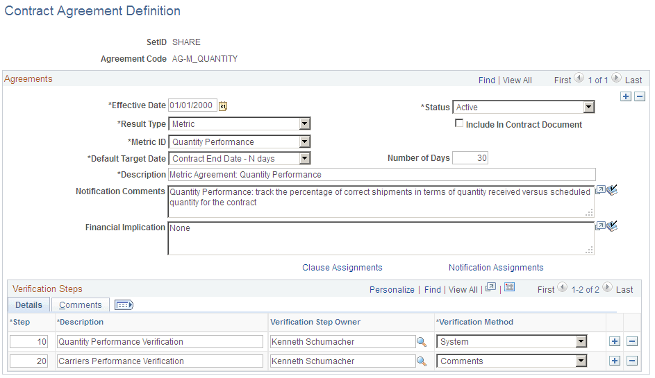

Use the Contract Agreement Definition page (CS_AGREE_HDR) to set up basic agreement information for contract agreements.
Navigation:
This example illustrates the fields and controls on the Contract Agreement Definition page.
Use this page to predefine agreements. After defining the agreement, you can use the agreement code to provide default information from this agreement into a new contract agreement. Agreement codes are defined by SetID. SetID records are the same set control group as the PeopleSoft Supplier Contract Management contract set control group.
Refer to Common Elements Used When Managing Contract Agreements for common field definitions. Those that are not common are defined below.
Field or Control |
Description |
Agreement Code |
Displays the identifier for the agreement that you are adding or maintaining. |
Effective Date |
Select the date on which the agreement is to become effective. The default value is today's date. This date controls when you can use the agreement. |
Status |
Select the state of the agreement. If you select Active, the agreement is available for immediate use with contracts. If you select Inactive, you can create the agreement and define its data, but it is not available for use. |
Result Type |
Select a value that indicates how you are measuring the results of the agreement. The result type you select determines other page elements and system behavior when you assign this predefined agreement to a contract. Note: Some result types are metric-related. See Understanding Agreement Metrics. |
Default Target Date |
Select a method for defining the default target date. The system uses the value defined here to calculate a due date for the agreement when the agreement is specified on a contract. After you add the date, changes to the agreement's default target date does not change the contract's target date on any contract where this agreement code is specified. |
Number of Days |
Enter the number of days by which you want to offset the default target date. For example, if you select Contract Start Date + N days in the Default Contract Date field and you want the default contract date to be seven days after the contract start date, enter 7 in the Number of Days field. |
Verification Steps - Details
Use this section to define the verification steps for this agreement.
Field or Control |
Description |
Step |
When you add data to any of the following fields, the system assumes you are adding verification steps to the agreement and certain fields on the page then become required. If you do not add data to the step, the system assumes there are no verification steps. Verification steps are automatically added to a contract when you specify the agreement on the contract. You can delete steps without affecting existing contracts. You can also delete steps on an existing contract without affecting the predefined agreement. |
Verification Step Owner |
Select a user who will be responsible for this agreement verification step. You can also enter an owner's name. When you select a predefined agreement to use with a contract, the system populates the verification owner information along with due date information for the contract agreement. |
Verification Method |
Select the method by which you want to verify this step. The method defines how a verification owner indicates that a verification step has been completed. This field is required if you are adding steps to the agreement. For a definition of each option, see Common Elements Used When Managing Contract Agreements. |
Verification Steps - Comments
Use this tab to enter comments about the verification step to include the e-mail notification that is sent to the approver, collaborator, or reviewer. You can enter up to 254 characters and you can define separate comments for each verification step.

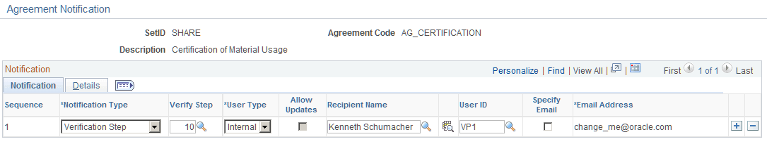

Use the Agreement Notification page (CS_AGREE_WF) to assign notifications for agreements and steps.
Navigation:
Click the Notification Assignments link on the Contract Agreement Definition page.
This example illustrates the fields and controls on the Agreement Notification page.
Use this page to indicate if notifications will be initiated when a change in status occurs for an agreement or step or if you want to notify the recipient about a pending or past due date.
The system uses these notifications as default values on the contract when the agreement is specified on the contract header or line. The recipients you add here are typically those individuals who are always an interested party when this agreement is included in a contract. At the contract level, you can add additional notifications or delete existing ones. If the interested parties are always different for each contract, you do not need to specify any notifications here. Instead, you can set up the notifications when you create the transaction contract.
Field or Control |
Description |
Sequence |
Displays the notification sequence. This is a system-generated number that identifies the notification. |
Notification Type |
Select a notification type. Notification types are triggers for sending notifications to specified recipients, and is a required field. You can add as many recipients as necessary for each notification type. Values are:
Verify Step |
Select a verification step to which this notification applies. The system displays this field when you select Verification Step as the value in the Notification Type field. |
User Type |
Select whether the user is an internal or external user. The system controls the behavior of the remaining fields, depending on your selection. If you select Internal, the system low lights the Allow Updates check box. If you select External, you can indicate if the external user can update the agreement and manually enter users and their email addresses. |
Allow Updates |
Select to allow external users to update the agreement verification step (deliverable) when you have enabled supply-side portal access to update the deliverable. This check box is only available for external users. Suppliers can then update this deliverable at any time, but they are notified to do so based on the notification setup for their user IDs. For more information about external users: See Reviewing and Collaborating on External Documents and Understanding Supplier Information Maintenance |
Recipient Name |
Enter an external user who is not defined to the system. You must also enter an email address when you enter a recipient. You can also select an internal user, but the system does provide the email address automatically. To populate the User ID and Email Address fields automatically, use the Search Recipient button, described next, to select a recipient. |
Click this button to search for users based on either their recipient name, user ID, or email address. The system populates the Recipient Name, User ID, and Email Address fields with your selection. |
User ID |
Select a user ID to use for this notification. |
Specify Email |
Select to activate the Email Address field. You can normally use the address that the system placed in the field which will be the default email address for the user ID, or you can override and manually enter an external email address for cases where simple notification is wanted but a user ID does not exist in the system. |
Email Address |
Enter an email address for the recipient. This field is required and the system uses it to route notifications. The system automatically populates this field from the user ID's default email. If you are sending a notification to an external user, you can manually enter the address. Make sure the Specify Email check box is selected to allow updates to this field. |
