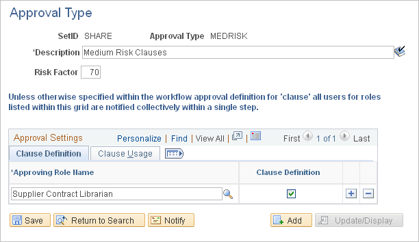

Use the Approval Type page (CS_APPROVAL_TYPE) to define approval types.
Navigation:
This example illustrates the fields and controls on the Approval Type page: Clause Definition tab.
The system uses the approval type that you define on this page for clause approvals. You can include users who are associated with the role name as collaborators in the approval process.
Field or Control |
Description |
Description |
Enter a description for the approval type. This field is required. |
Risk Factor |
Enter the level of risk that this clause brings to the organization if it is included in a contract. You can associate a risk factor with the level of responsibility of a user. For example, senior personnel might need to approve clauses with higher risks. Risks are represented by numeric values from zero to 100. Clauses that are associated with a high-numbered risk factor represent a high level of risk for the organization. The numbers facilitate the use of algorithms that help identify the overall risk of a contract. Note: Risk factors are not incorporated within contract workflow processing. |
Approving Role Name |
Select which roles should be notified when a clause that uses this approval type is added or changed. Each approval type has an associated role name. The system uses the role name to determine the group of users that is pulled into the clause or document approval cycle. All users with this role in their user profile will be included in the approval process. You do not have to select a role name when you initially create the approval type; however, before you define the approval settings, you must define the name. |
Clause Definition |
Select to require that this user role is included for clause approval cycles with which this approval type is associated. |
