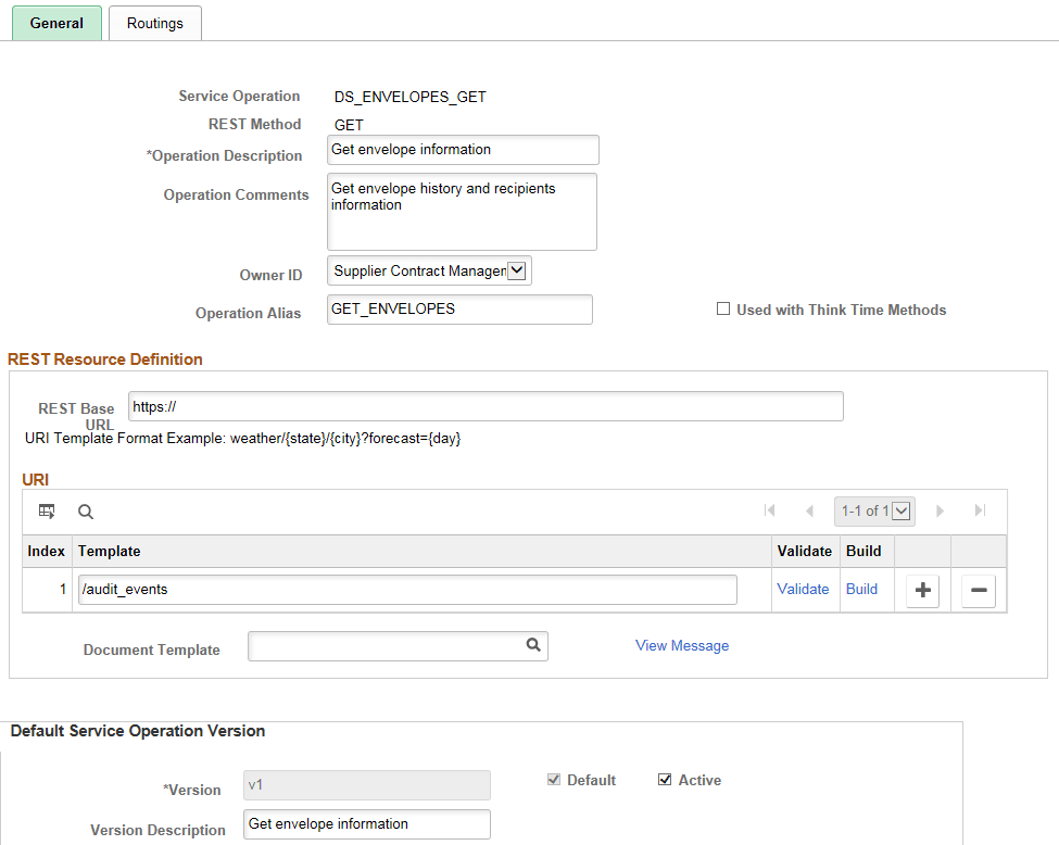

Use the Service Operation — General page (IB_SERVICE_REST) to activate the service operations used for DocuSign REST service (if you choose to use REST APIs for DocuSign) and Adobe Sign.
By default, PeopleSoft uses SOAP APIs to integrate with DocuSign, and the service operations are already activated. Hence no action needs to be taken.
For more information on Service Operations, see the product documentation for PeopleTools: Integration Broker.
Navigation:
This example illustrates the fields and controls on the Service Operation — General page. You can find definitions for the fields and controls later on this page.
Field or Control |
Description |
Service Operation |
Enter the name of the service operation to view, or click the Lookup button to search for and select an operation. The following service operations are available for DocuSign:
The following service operations need to be activated to use with Adobe Sign:
Active |
Select to activate the service operation. |

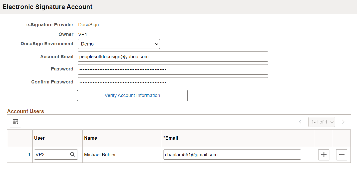

Use the Electronic Signature Account page (CS_ESIGN_SETUP) to specify DocuSign account information.
Note: Oracle PeopleSoft has migrated from SOAP APIs to Adobe Sign REST APIs to manage documents for signing. Users need to review updates from Adobe Sign on deprecation of SOAP APIs. The set up page has been replaced with Configure OAuth page to configure authorization details for Adobe Sign.
Navigation:
Electronic Signature Account page for DocuSign (1 of 2)
Electronic Signature Account page for DocuSign (2 of 2)
Use the DocuSign Environment option to indicate whether the DocuSign account is used with your test or production environment. Options are Demo and Production. When you select the Demo option, documents you create will have a watermark stamped on them to indicate they are used for testing.
Enter the account information for the DocuSign user and click the Verify Account Information button to authenticate account information.
Use the Account Users group box to specify users added to the DocuSign account.
Note: You are not adding users here; users are added in the DocuSign account.
Use the Signing Groups group box to view signing groups associated with the DocuSign account. Select the Group Members link to access the Signing Group Users page and view individual users associated with the signing group. Signing groups are defined in the DocuSign application.

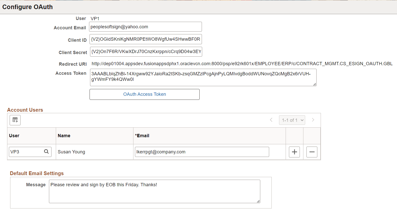

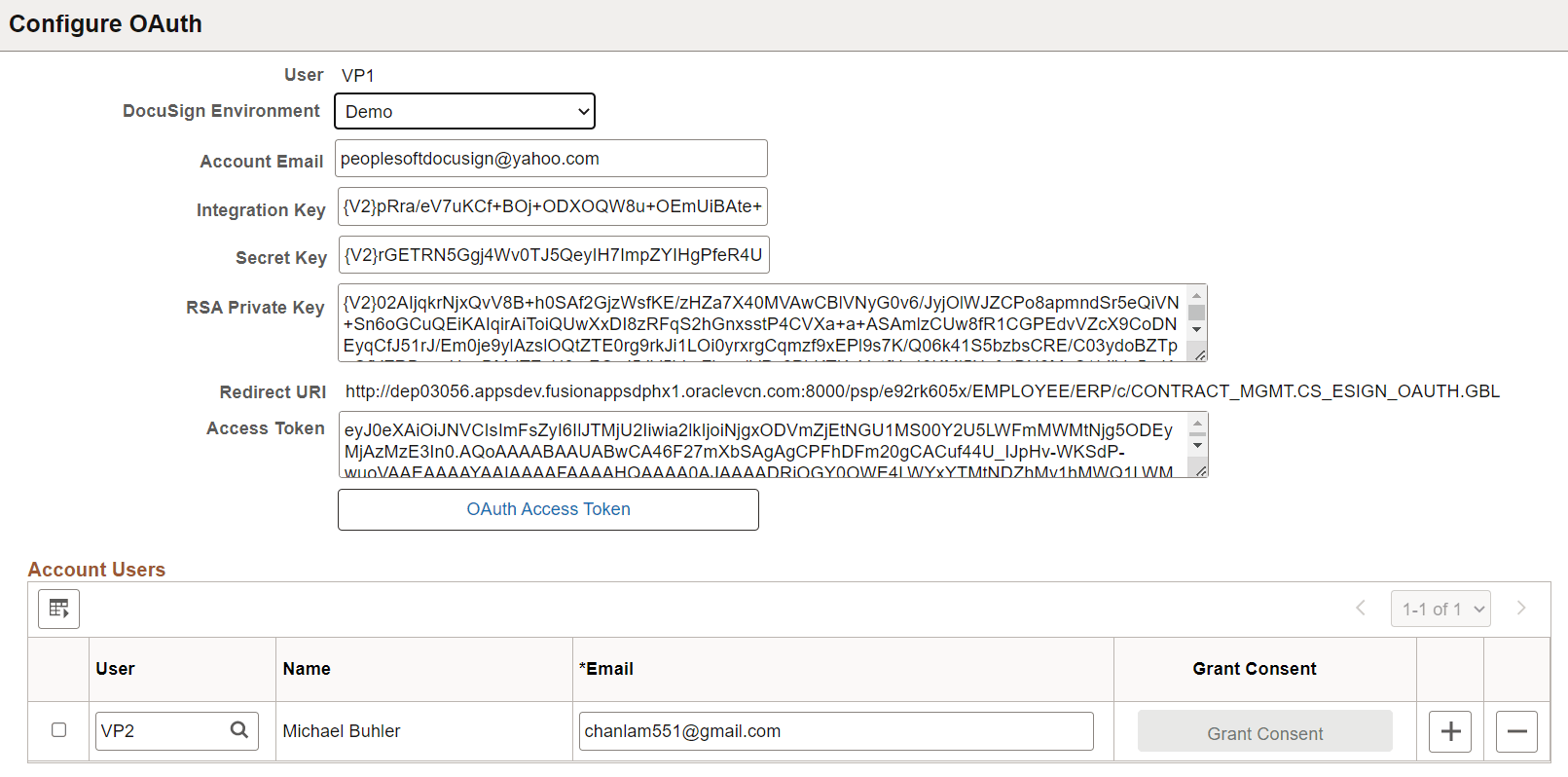

Use the Configure OAuth page (CS_ESIGN_OAUTH) to authorize API access by account administrator. The configuration starts with user authentication by logging into Adobe Sign or DocuSign account and then grant requested permissions to manage documents for signing. At the end of the process, an access token is returned to Configure OAuth page. Administrator will complete the process by entering users in the account, if any, and then save the page.
Note: See document ‘30174722_Installation’ on the PeopleSoft FSCM 9.2: Update Image Documentation My Oracle Support page for instructions to configure OAuth access token for Adobe Sign.
See document '35171314_Installation' in My Oracle Support for OAuth configuration instructions for DocuSign.
Navigation:
This example illustrates the fields and controls on the Configure OAuth page for DocuSign (1 of 2). You can find definitions for the fields and controls later on this page.
This example illustrates the fields and controls on the Configure OAuth page for DocuSign (2 of 2). You can find definitions for the fields and controls later on this page.
This example illustrates the fields and controls on the Configure OAuth page for Adobe Sign. You can find definitions for the fields and controls later on this page.
Field or Control |
Description |
DocuSign Environment (DocuSign only) |
Indicate whether the DocuSign account is used with your test or production environment. Options are Demo and Production. |
Account Email |
Enter Adobe Sign account email ID. |
Integration Key (DocuSign only) |
Enter the integration key obtained from the DocuSign account. |
Client ID (Adobe Sign only) |
Enter Client ID obtained from Adobe Sign. |
Secret Key (DocuSign only) |
Enter secret key obtained from the DocuSign account. |
Client Secret (Adobe Sign only) |
Enter client secret obtained from Adobe Sign. |
RSA Private Key (DocuSign only) |
Enter the RSA private key obtained from the DocuSign account. |
Redirect URI |
Displays URI to redirect user back to the PeopleSoft Configure OAuth page. |
OAuth Access Token |
Click button to get OAuth Access Token. Ensure the Redirect URI matches with Adobe Sign or DocuSign. User will be authenticated and asked to grant permissions for API application to manage documents. Once authorized by user, an authorization code is returned to Configure OAuth and the code can then be used to exchange for an access token and refresh token. When token expires, refresh token is used to get new token to make REST API requests. |
Account Users
Field or Control |
Description |
Account Users |
Associate PeopleSoft user ID to each user added to the Adobe Sign or DocuSign account with permission to manage documents for signing. |
Grant Consent (DocuSign only) |
Click on Grant Consent link to log into your DocuSign account and grant consent for Supplier Contracts applications to send documents for e-signing. |
Email to Get User Consent |
Select this button to send an email to selected users to authenticate with DocuSign and grant consent for Supplier Contracts applications to act on their behalf. |

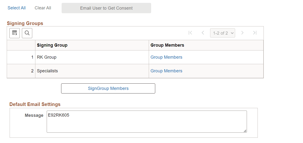

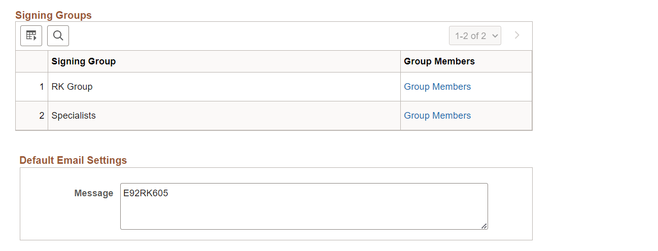

Signing Groups
Field or Control |
Description |
Signing Group |
Displays the signing groups associated with the DocuSign account. Signing groups are defined in the DocuSign application. |
Group Members |
Select the Group Members link to access the Signing Group Users page and view individual users associated with the signing group. |
SignGroup Members |
Select this button to refresh the list of signing groups when you make updates to signing groups in the DocuSign account. |
Default Email Settings
Enter the default text for email message that will be used in the email notifications sent to signatories.
