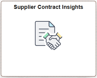

This example illustrates the Supplier Contract Insights tile
Supplier Contract Insights Tile
