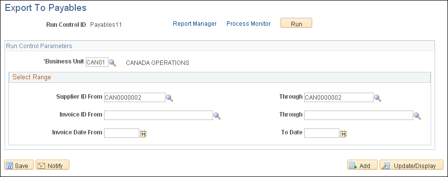

Use the Export To Payables page (SPA_GEN_INV_EXPORT) to export invoicing data to a PeopleSoft Payables staging table or to a flat file.
Navigation:
This example illustrates the fields and controls on the Export To Payables page.
Enter the run control parameters for exporting invoicing data.
