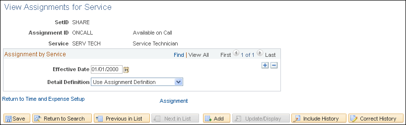

SPB_ASGN_BY_SRV |
View or modify assignments that are associated with a specific service. |

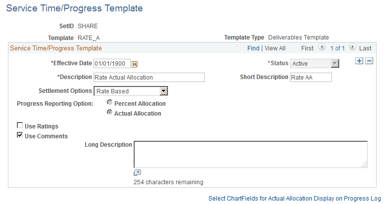

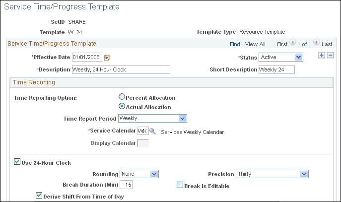

SPA_TIME_TMPL_PG |
Create services templates. Enter or modify options used in a timesheet to enter time and expense information and progress information. |

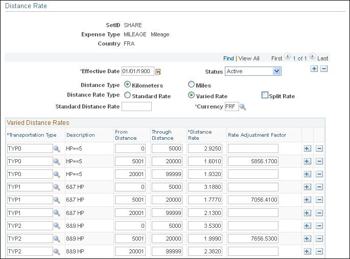

EX_AUTO_RT_TBL |
Define expense distance rates. |

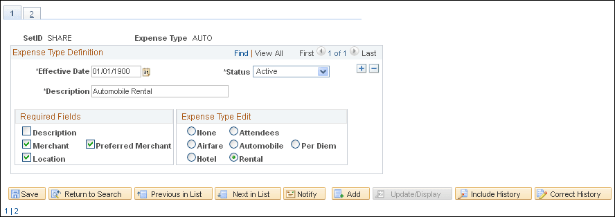

SPA_EXPENSE_TYPES1 |
Define expense types. |
SPA_EXPENSE_TYPES3 |

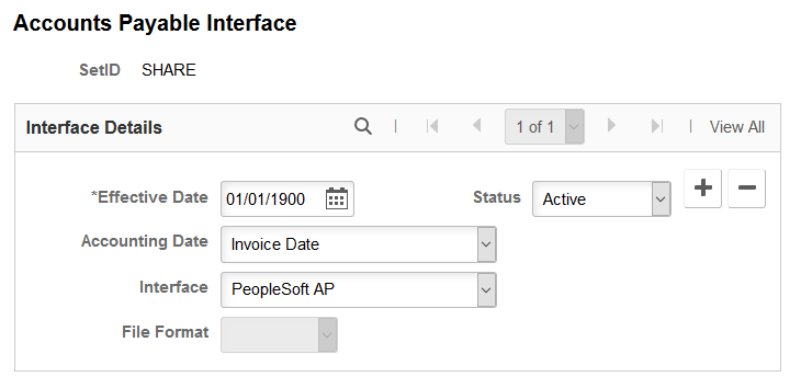

SPA_AP_INTRFACE |
Define accounts payable application interface information. |

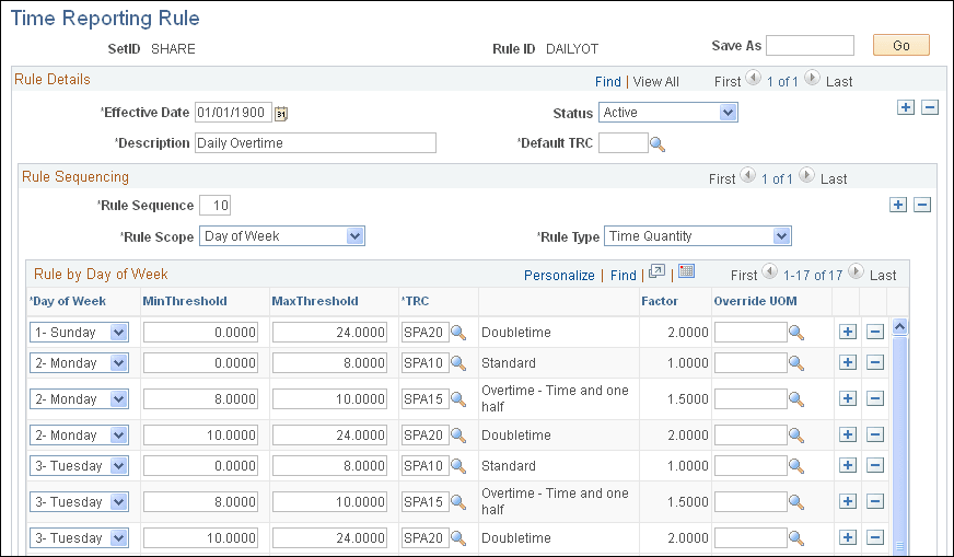

Use the Time Reporting Rule page (SPA_TIMERPT_RUL) to define rules for reporting time.
Navigation:
This example illustrates the fields and controls on the Time Reporting Rule page.
Rule Details
Field or Control |
Description |
Description |
Enter a long description to identify the time reporting rule. |
Default TRC (default time reporting code) |
Select a default TRC to use when the time reporting rule does not meet the rule criteria. |
Rule Sequence
Field or Control |
Description |
Rule Sequence |
Enter a rule sequence number. This value is used to determine the order the system validates and applies the rule criteria to a timesheet. Since the rule sequence numbers are incremental, be sure to prioritize the rule in the order in which you want the system to evaluate and validate the TRC codes to use for time reporting. Note: Always identify the most important rules at the lowest rule sequence to ensure that the system picks up those rules first. If you define a priority rule at higher sequence number and the system validates another rule that qualifies at a lower sequence number, the system uses the lowest rule sequence to populate the timesheet. For example, if you create a rule with specific capture dates (as in the case of holidays), always be sure to define those dates first. The system starts at the most current rule sequence and works its way down the list. Also, if you want to be sure that there is always a valid rule in place, identify the "catch-all" rule as the last rule in the sequence. That way, you are always sure that there is a valid rule in the sequence. |
Rule Scope |
Select the time scope that this rule sequence covers. Values include Date, Day of the Week, and Time Period. |
Rule Type |
Select the type for this rule sequence. Values include Time Quantity and TRC List. |
Rules by Date
Field or Control |
Description |
Date |
Enter the date for which this rule applies. |
Min Threshold (minimum threshold) |
Enter minimum quantity of hours for this rule. |
Max Threshold (maximum threshold) |
Enter the maximum quantity of hours fro this rule. |
TRC (time reporting code) |
Select a value to use with this time reporting rule. |
Override UOM (override unit of measure) |
Select an alternative UOM to use as an override on the work order. Use this UOM to calculate a different rate on the work order. |
Blackout |
Select to prevent time from being entered for the specified day. Note: This option is only available for the rule type of TRC List. |
Rules by Day of the Week
Field or Control |
Description |
Day of Week |
Enter a day of the week to create a time reporting rule. Values include:
Rules by Time Period
Field or Control |
Description |
Time Period |
Enter a time period to create a time reporting rule. Values include Bi-Monthly, Daily, Monthly, Semi-Monthly, and Weekly. |

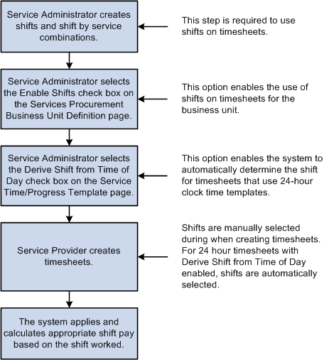

The following diagram illustrates the steps involved in defining shifts that can be used on timesheets:
Steps to define shifts that can be used on timesheets

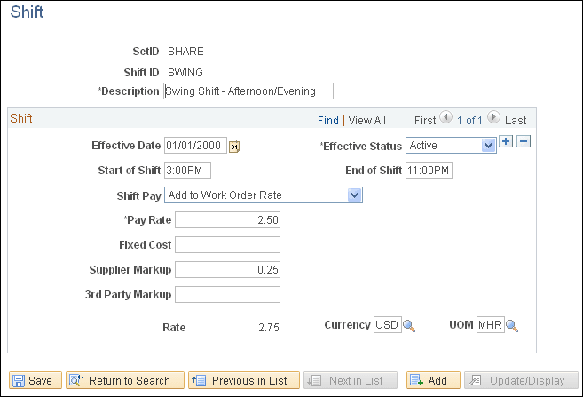

Use the Shift page (SPB_SHIFT) to define shifts to be used on timesheets.
Navigation:
This example illustrates the fields and controls on the Shift page.
Note: These settings are defined at the SetID level.
Note: The fields that appear on this page depend upon the value selected for the Shift Pay field.
Note: The Document Service and Service Type labels will differ if Enterprise Human Capital Management is installed.
Field or Control |
Description |
SetID |
Select the SetID that will be able to use this shift. |
Shift ID |
Enter a name for the shift. |
Description |
Enter a description for the shift. This is a required field. |
Effective Date |
Enter the date that the shift will become effective. The current date is the default value. This is a required field. Add effective-dated rows for each Shift Pay type as required. |
Effective Status |
Select Active (default) or Inactive. This determines if this shift will be available for use on timesheets. Only shifts with a status of Active will be available for use. This is a required field. Note: If you change an Active shift to Inactive, the system will issue a warning message if there are any existing shift and service combinations for the effective-dated shift. |
Shift Start Time and Shift End Time |
(Optional) Enter the start and end times for the shift. Shift pay is paid for work performed during this time period. You can leave this blank and the system will automatically select the shift based on the start and end times entered on the timesheet. Note: Start and stop times are for informational purposes only. If the 24-hour clock time template is used and the Derive Shift Based From Time of Day option is selected, then the system automatically populates the default time values in this fields. However, these start and stop times can still be modified at the template definition level. |
Shift Pay |
Select a value to indicate the basis for the shift pay calculation:
Shift Pay Rate Percentage |
Enter a negative or positive percent value for the shift pay rate. This is a required field and is used with the Add % of Work Order Rate value. |
Shift Pay Rate Amount |
Enter a negative or positive amount. If pay types are not selected, then this is a single rate. If pay types are selected, this rate must be broken out into the Pay Rate, Fixed Cost, Supplier Markup, and Third-Party Markup fields that appear. This is a required field and is used with the Add to Work Order Rate or Substitute Work Order Rate values. |
Shift Pay Rate Currency |
Enter the currency code for this shift pay rate. This field works with the Add to Work Order Rate or Substitute Work Order Rate values. |
Shift Pay Rate UOM (unit of measure) |
Enter the unit of measure for this shift pay rate. This field works with the Add to Work Order Rate or Substitute Work Order Rate values. |

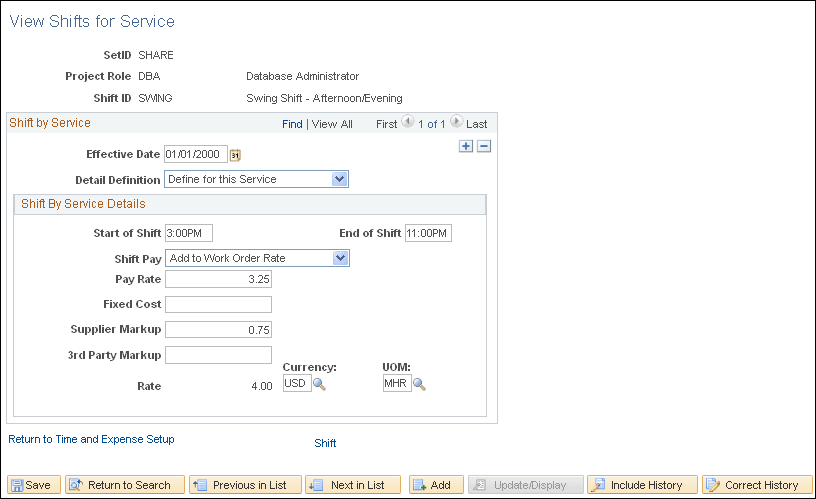

Use the Shifts by Service page (SPB_SHFT_BY_SRV) to view and modify valid shifts that are associated with a specific service.
Navigation:
This example illustrates the fields and controls on the Shifts for Service page.
This page identifies the shifts that are valid for a particular service. Only shifts associated to the service can be associated to time reported against a work order for that service. In addition, for 24-hour clock time entry, only shifts that are associated to the time template can be associated to the time reported.
Shift by Service Details
Field or Control |
Description |
Project Role |
Select a value for this service (job) code. |
Shift ID |
Select the shift to be associated with this service. |
Effective Date |
Enter the effective date for this service. This is a required field. |
Detail Definition |
Select a method to use for defining details of the shift. Values are:
Description
Field or Control |
Description |
Start of Shift and End of Shift |
(Optional) Enter the beginning and ending times for the shift. Note: Start and stop times are for informational purposes only. If the 24-hour clock time plate is used and the Derive Shift Based From Time of Day option is selected, then the system automatically places default time values on this fields. However, these start and stop times can still be modified at the template definition level. |
Shift Pay |
The default values come from the Shift definition page but you can modify it here. Values are:
Pay Rate |
This required field is available if you select Add to Work Order Rate or Substitute Work Order Rate.If you selected the Add to Work Order Rate, you must enter a positive or a negative amount in this field, If you selected the Substitute Work Order Rate value, you must enter a positive amount. If pay types are not selected, then this is a single rate. If pay types are selected, this rate must be broken out into the Pay Rate, Fixed Cost, Supplier Markup, and Third-Party Markup fields that appear. |
Shift Percent |
You must enter a positive or a negative percent in this field if you selected the Add % of Work Order Rate value. This is a required field. |
Currency |
You must enter a value in this field if you selected the Add to Work Order Rate or Substitute Work Order Rate option. |
This field is available if you select the Add to Work Order Rate or Substitute Work Order Rate value. This is a required field. |
Shift |
Click this link to access the Shift definition page for this specific shift. |

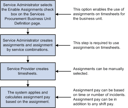

The following diagram illustrates the steps involved to define assignments that can be used on timesheets:
Define assignments that can be used on timesheets

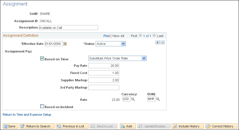

Use the Assignment page (SPB_ASSIGNMENT) to define assignments to be used on timesheets.
Navigation:
This example illustrates the fields and controls on the Assignment page.
Note: The fields that appear on this page depend upon the value selected for the Assignment Pay field.
Field or Control |
Description |
SetID |
Select the SetID that will be able to use this assignment. |
Assignment ID |
Enter a name for the assignment. |
Description |
Enter a description for the assignment. |
Assignment Definition
Field or Control |
Description |
Effective Date |
Enter the date that the assignment will become effective. The current date is the default value. This is a required field. Add effective-dated rows for each Assignment Pay type as required. |
Status |
Select Active (default) or Inactive. This determines if this assignment will be available for use on timesheets. Only assignments with a status of Active will be available to associate with services or on timesheets. This is a required field. Note: If you change an Active assignment to Inactive, the system will issue a warning message if there are any existing assignment and service combinations for the effective-dated assignment. |
Assignment Pay |
Select the value on which the assignment pay calculation should be based. Values are Based on Time or Based on Incident.
If you select Based on Time, select a value as the basis for time associated with the assignment:
Rate |
This display-only field shows the total of the Pay Rate, Fixed Cost, Supplier Markup, and 3rd Party Markup fields. |

If you select Based on Incident, you must break down the assignment pay amount into these fields.
Note: The total of these fields should add up to the total assignment pay amount.
Pay Rate
Fixed Cost
Supplier Markup
3rd Party Markup

Use the Assignments by Service page (SPB_ASGN_BY_SRV) to view or modify assignments that are associated with a specific service.
Navigation:
This example illustrates the fields and controls on the Assignments by Service page.
Field or Control |
Description |
Assignment ID |
Enter a description for this assignment by service. |
Service |
Enter the service code. |
Assignment by Service
Field or Control |
Description |
Effective Date |
Detail Definition |
Select a method to use for defining details of the assignment by service combination. Values are:
Description
Field or Control |
Description |
Assignment Pay |
Select the method on which to base the assignment pay. Values are:
Pay Rate |
This required field is available if you select Add to Work Order Rate or Substitute Work Order Rate. If you selected the Add to Work Order Rate, you must enter a positive or a negative amount in this field, If you selected Substitute Work Order Rate, you must enter a positive amount. If pay types are not selected, then this is a single rate. If pay types are selected, this rate must be broken out into the Pay Rate, Fixed Cost, Supplier Markup, and Third-Party Markup fields that appear. |
Percent |
Currency |
Assignment |
Click this link to access the Assignment definition page for this specific assignment. |

Enable Shifts |
Select this check box if you want to use shifts on timesheets. |
Enable Assignments |
Select this check box if you want to use assignments on timesheets. |

Time Reporting
Field or Control |
Description |
Time Reporting Option |
Use this option to determine whether a resource based work order requires the service provider to report time against specific ChartFields, or whether the total time is entered and distribution percentages automatically split time or progress according to the ChartField distribution defined for the work order. Values are:
Time Reporting Period |
Select a period that indicates how often service providers enter their work hours. The default value is Weekly. Other values are Daily, Bi-Weekly, Semi-Monthly, and Monthly. Note: When you select a the monthly time reporting option, the Display Calendar field is editable. You must select a display calendar to chunk monthly reporting properly. |
Service Calendar |
Select a service calendar for the time reporting period. Use this calendar as a detail for how the organization reports time during the calendar year. Values are:
Display Calendar |
Select an appropriate calendar display option. Use this option to determine how the calendar is displayed for the time reporting period. For example, if you select Monthly as the time reporting option, you may want to display the calendar on a weekly basis. |
Use 24-Hour Clock |
Select this option if you want time logged using the 24-hour clock. You select this check box if you want to pay providers shift differential using shifts. If you select to use a 24-hour clock, the system disables other entry fields. |
Rounding |
Select whether you want to round up or down to the hour. Select None if you do not want to round the minutes. |
Precision |
Select the number of precise minutes for rounding. Values are Six, Twelve, Fifteen, Twenty, and Thirty. |
Break Duration (Mins) (break duration - minutes) |
Enter the break duration in number of minutes. The break duration is subtracted from the total time difference between the start and end dates. For example, if you have a start time of 8:00 a.m. and end time of 5:00 p.m. with a 30-minute break duration, 8.5 hours are recorded for the day. |
Break is Editable |
Select to indicate that the break is not mandatory. |
Derive Shift From Time of Day |
Select this option if you want the system to automatically derive the shift depending upon the time of day. This option is used with 24-hour clocks only. You use the Derive Shift From Time of Day check box in conjunction with the shift and assignments functionality. |
Shifts |
This group box appears when you select Derive Shift From Time of Day. Use this group box to associate specific shifts with this time service template. Note: Start and stop times are for informational purposes only. If the 24-hour clock time plate is used and the Derive Shift Based From Time of Day option is selected, then the system automatically places default time values on this fields. However, these start and stop times can still be modified at the template definition level. |
These default values come from the Shift definition page, but you can override the values here. These are required fields. Note: Start and end times cannot fall within the ranges for another shift for the sample template. |
Allow for more than 24 hours |
Select if a service provider is enabled to enter more than 24 hours for a single project, work order, activity, and day. You can use this option for team reporting instead of individual reporting. Note: When you select this option, the Rounding, Default Start Time, Default Stop Time, Break Duration, Precision, and Break is Editable fields are available. |
Manually enter TimeSheet TRCs(manually enter timesheet time reporting codes) |
Select this check box to indicate that you want to manually enter TRCs for timesheets. The check box controls whether time reporting codes are assigned manually by the service provider during time entry or automatically assigned by the system based on predefined rules. You cannot assign a time-reporting rule to a template if this check box is selected. The Derive Shift From Time of Day check box is available if you do not select to manually enter timesheet TRCs. If you select to manually enter timesheet TRCs, the check box is not available. Note: When editing an existing time template, you cannot change the setting of the Manually enter Timesheet TRCs check box if there are already timesheets associated to the template. When a template is already in use, the system low-lights entry fields. |
Time Reporting Rule ID |
Select a time reporting rule to use for calculating different payouts. This field is not available if you select the Manually enter Timesheet TRCs check box. Note: To use this feature, you must first define the time reporting rules on the Time Reporting Rules page. |
View Time Reporting Rules |
Click to view the time reporting rule associated with this service template. |
Overtime Permitted |
Select to indicate if a requisition allows overtime. This is an informational field only. |
Use Ratings |
Select if the performance of a service provider during the time period is to be rated. Note: This check box is only accessible if the Use Ratings check box on the Services Procurement Business Unit Definition page is selected. |
Use Comments |
Select to enable service providers and provider contacts to enter comments or concerns on the timesheet and progress log. |
Select ChartFields for Actual Allocation Display on Timesheets |
Select the ChartFields to display on the timesheet. The values from the selected ChartFields will be used to allocate time on distribution lines. Note: This option is only available when you select Actual Allocation as the time reporting option. |
Service Time/Progress Template
This example illustrates the fields and controls on the Service Time/Progress Template page. You can find definitions for the fields and controls later on this page.
Field or Control |
Description |
Settlement Options |
View the settlement method for a work order, which is based on the service selected. Progress will be recorded based on the method defined. Values include:
Progress Reporting Option |
Use this option to associate the reporting options (Percentage/Actual) with Progress templates for each Settlement Option . This field is available only for Deliverable template type. The reporting options selected here controls the Template you select in a Work order. |
Use the Distance Rate page (EX_AUTO_RT_TBL) to define expense distance rates.
Navigation:
This example illustrates the fields and controls on the Distance Rate page.
You can set up standard and varied distance rates in different base currencies with each combination tied to an expense type. When service providers use their automobiles for business purposes, you can reimburse them based on how far they must drive.
Field or Control |
Description |
Distance Rate Type |
Select Standard Rate to indicate a uniform reimbursement rate regardless of transportation type. Select Varied Rate to indicate reimbursement rates that depend on the transportation type. |
Standard Distance Rate |
Enter the monetary amount that is to be reimbursed per unit driven, if you selected Standard Rate. |
Varied Distance Rates
Field or Control |
Description |
Transportation Type and Distance Rate |
If you selected Varied Rate, enter a distance rate to define the monetary amount that is reimbursed for the transportation type per unit driven. |
Rate Adjustment Factor |
Enter an adjustment factor that the system applies for the transportation type. |
Use the Expense Types - Expense Types1 page (SPA_EXPENSE_TYPES1) to define expense types.
Navigation:
This example illustrates the fields and controls on the Expense Types1 page.
Required Fields
Field or Control |
Description |
Description, Merchant, Preferred Merchant, and Location |
Select each option to appear as a required field on the expense sheet that a service provider completes for the expense type. To define an expense location amount for this expense type, select the Location check box to make it a required field on the expense sheet. |

Use the Accounts Payables Interface page (SPA_AP_INTRFACE) to define accounts payable application interface information.
Navigation:
This example illustrates the fields and controls on the Accounts Payable Interface page. You can find definitions for the fields and controls later on this page.
Field or Control |
Description |
Accounting Date |
Select an Accounting Date.
Interface |
Select Other to indicate a third-party application. Select PeopleSoft AP to indicate that you use PeopleSoft Payables. |
File Format |
PeopleSoft Services Procurement uses comma-separated values as its only file format. If you select Other as the interface, the system exports invoice data to a flat file using this format, which you can use to export to your accounts payable system for invoice voucher generation. If you select PeopleSoft AP as the interface, this field is disabled, because it is not applicable. |
