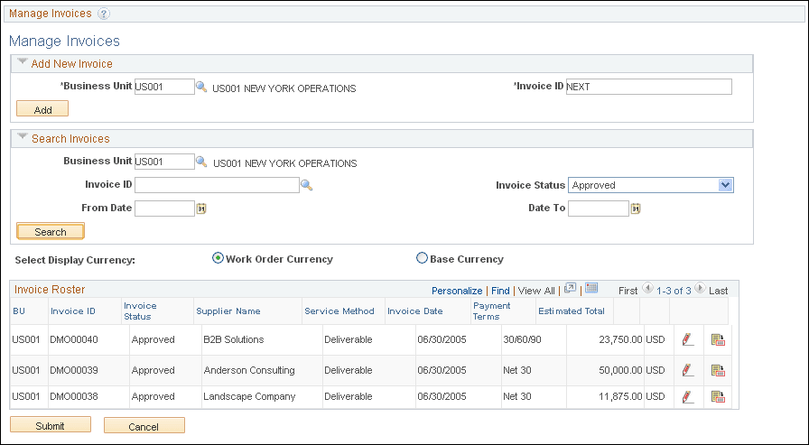

Use the Manage Invoices page (SPF_INV_MANAGE) to add invoices, search existing invoices, submit invoices, or cancel invoices.
Navigation:
This example illustrates the fields and controls on the Manage Invoices page. You can find definitions for the fields and controls later on this page.
You can access this page when you sign in as the PeopleSoft Services Procurement invoice manager.
Search Invoices
Enter search criteria to use to retrieve, edit, and view invoices.
Select Currency
Displays amounts in either base or work-order currency. The Select Currency field is available only if Allow Multicurrency is selected on the Services Procurement business unit page.
See Setting Up Business Unit Definitions.
Note: Invoices are generated in both base and work-order currency.
Invoice Roster
Field or Control |
Description |
Estimated Total |
Displays the estimated total, including expenses and estimated prorated tax. Note: The sales and use tax (SUT) included in the estimated total includes only the sales tax. The use tax is displayed as a separate line item on the Invoice Detail page. |
Click the Edit icon to access the Manage Invoice Line Summary page, where you can review and edit invoice lines. |
Click the View Entry icon to access the Invoice Process Detail page, where you can review invoice processing information. |
Submit |
Click to submit selected invoices for approval. |
Cancel |
Click to cancel selected invoices. Canceling invoices releases the time sheet, progress log, or expense associated with that invoice so that it can be invoiced again. |
Note: You can adjust invoices by adjusting the associated time sheets, progress logs, or expense amounts. If the adjusted time sheet, progress log, or expense is included in an invoice, the status of the invoice line associated with the adjustment is changed to Canceled and the invoice header status is changed to Adjusted. You can also adjust invoices after the invoice has been generated by adjusting the amounts on the Manage Invoice Line Detail page. Adjusting invoices in this manner does not change existing time sheets, progress logs, or expenses. Adjustments can be made prior to invoices being approved by either the supplier invoice approver or the enterprise invoice approver.

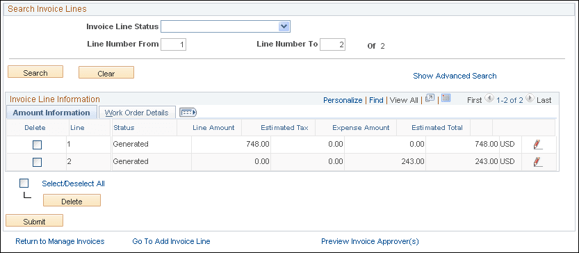

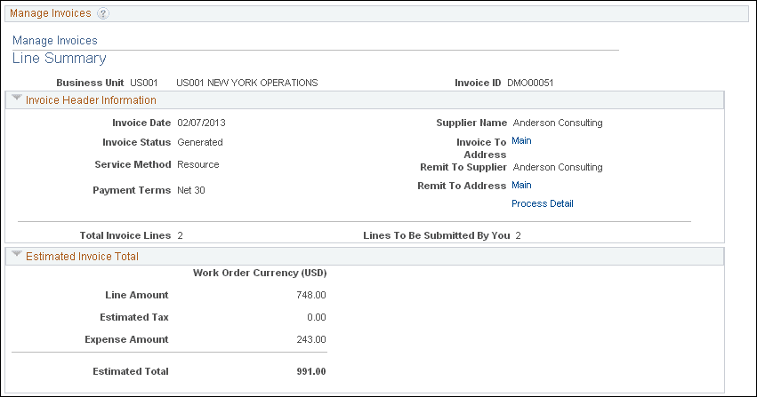

Use the Manage Invoices - Line Summary page (SPF_INV_LN_DTLS) to modify the selected invoice.
Navigation:
Click the Edit button for an invoice on the Manage Invoices page.
This example illustrates the fields and controls on the Manage Invoice - Line Summary page (1 of 2). You can find definitions for the fields and controls later on this page.
This example illustrates the fields and controls on the Manage Invoice - Line Summary page (2 of 2). You can find definitions for the fields and controls later on this page.
The data appearing in the Invoice Header Information and Estimated Invoice Total sections depends on whether the invoice is for VMS services.
Field or Control |
Description |
Business Unit |
Displays the business unit associated with the invoice. |
Invoice ID |
Displays the number automatically or manually assigned to the invoice when it is created. |
Field or Control |
Description |
Invoice Date |
Displays the creation date of the invoice. |
Invoice Status |
Displays the current status of the invoice. Values are:
Payment Terms |
Displays the payment terms assigned to the invoice. |
Supplier |
Displays the end supplier who performed the service. This option appears only in the Invoice Header Information section when invoices are not VMS-managed. The supplier appears at the line level when invoices are VMS-managed. |
VMS Suppler |
Displays the VMS supplier that manages the work orders for time and progress invoices. This option appears only in the Invoice Header Information section for VMS invoices. |
Field or Control |
Description |
Line Amount |
Displays the total invoice amount in base or work-order currency. Any assignment pay based on time is included with the base pay in the line amount. Any assignment pay based on number of incidents is displayed in the Time/Expense Details group box, and is not included in the line amount. |
Estimated Tax |
Displays the total estimated tax for the invoice. |
Expense Amount |
Displays the total expense amount in base or work-order currency. |
Estimated Total |
Displays the estimated total for the invoice. |
VMS Fee |
Displays the amount paid to the VMS suppler for managing the service. The data appearing in the Invoice Line Information grid depends on the selected service method and whether the invoice is for VMS services. Select the Base Currency or Work Order Currency option to display amounts. View the estimated tax and estimated total amount for the invoice. Note: This option appears and is included only in the Estimated Invoice Total for VMS invoices. |
MSP Fee |
Displays the amount paid to the MSP supplier for managing the service. Note: This option appears and is included in the estimated invoice total only if MSP is installed and the supplier is an internal supplier. External suppliers can view MSP fees; however, the fee is not included in the estimated total. |
Invoice Line Information: Amount Information
Select the Amount Information tab.
Field or Control |
Description |
Click the Line Details icon to access the line details. |

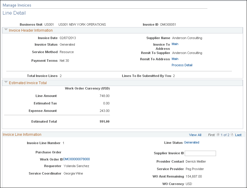

Use the Manage Invoices - Line Detail page (SPF_INV_TIME_DTL) to view invoice line details, make adjustments, or both.
Navigation:
For resource-based invoices, click the Edit button on the Manage Invoices - Line Summary page.
This example illustrates the fields and controls on the Manage Invoices - Line Detail page (1 of 2). You can find definitions for the fields and controls later on this page.
This example illustrates the fields and controls on the Manage Invoices - Line Detail page (2 of 2). You can find definitions for the fields and controls later on this page.
The information appearing on this page depends on the selected service method. Click the View Adjustments link to access details about the adjustments that have been made to an invoice line.
For multi-resource work orders, this page displays only the header work order ID in the invoice line information section. You can click the Parent Work Order ID link to access the work order header page. Click the Work Order ID link to access the lower-level service associated to the work order for an invoice line.
Field or Control |
Description |
Invoice Line Number |
Displays the number automatically assigned to the invoice line when it is created. Allows adjustments to the progress log line amount. |
Line Status |
Displays the current status of the invoice line. Values are:
Purchase Order |
Click to view the purchase order assigned to the work order associated with the services included on the invoice line. Note: The button is available only if the PO Work Order Integration (purchase order work order integration) check box is selected on the Services Procurement Installation Options page. |
Supplier Invoice ID |
Enter the supplier's invoice ID for each invoice line. This field is for reference only in the event that the supplier uses a different invoice ID. |
Work Order ID |
Click to view the work order associated with the services included on the invoice line. |
Provider Contact |
Displays the provider contact assigned to the work order associated with the services included on the invoice line. |
Requester |
Displays the requester assigned to the work order associated with the services included on the invoice line. |
WO Amount Remaining (work order amount remaining) |
Displays the amount still available for the work order. This amount is updated when invoices are approved. This field does not appear for multi-resource work orders. |
Service Provider |
Displays the name of the individual service provider associated with the services included on the invoice line. Note: This value displays for resource-based engagements only. |
