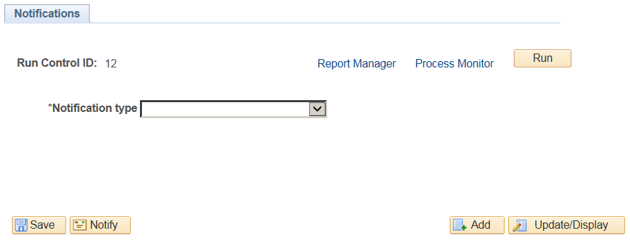

Use the Discussion Notification page (EOFD_EML_RUN) to schedule notifications.

This example illustrates the fields and controls on the Discussion Notification Page.

Access Discussion Notification page.
Enter the Run Control ID.
Click Add. This displays the Discussion Notifications page.
Select an appropriate value from the Notification Type field.

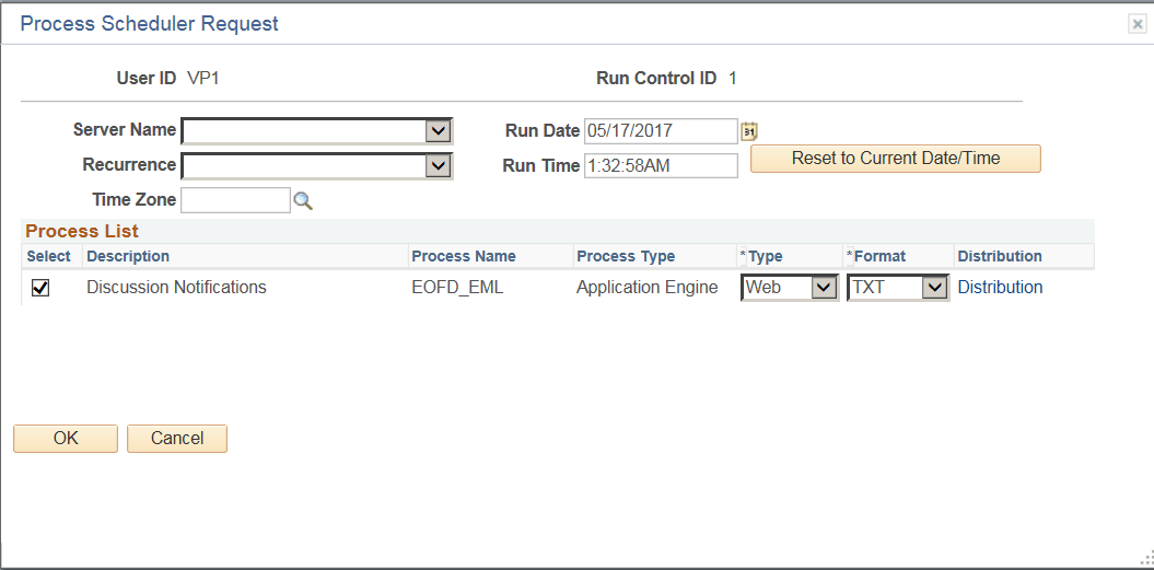

Click Run to process the notification request. This displays the Process Scheduler Request modal window as shown.
Note: It is recommended to set different frequencies for email and push notifications. For instance, push notifications could be as frequent as every hour or every 5 minutes. Email notifications would be less frequent, say once a day or week.
