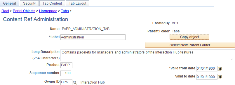

The Administration tab and the Investor tab are delivered as disabled. This was accomplished by setting the Valid To date in the content reference definition to 01/01/1900.
To enable a homepage tab that has been disabled:
- Access the Structure and Content page (PeopleTools, Portal, Structure and Content .
- Click the Portal Objects link.
- Click the Homepage link.
- Click the Tabs link.
- Click the link for the tab definition that you want to modify.
- Clear the 01/01/1900 date from the Valid to date field: - The following example displays a portion of the Content Ref Administration page for a disabled homepage tab definition.
- Save the definition.
