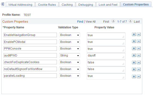

The EnableNavigationGroup custom property must be added in the portal system, the core application system, and in the participating instances. This custom property must be added in the default web profile of the portal system, the core application system, and the participating instances.
Use the Custom Properties tab of Web Profile Configuration page to add the EnableNavigationGroup custom property in the default web profile.
Navigation:
and click the Custom Properties tab.
This example illustrates the fields and controls on the Web Profile Configuration - Custom Properties page.
Field or Control |
Description |
Property Name |
Enter EnableNavigationGroup. |
Validation Type |
Select validation type as Boolean. |
Property Value |
Select property value as true. |
Note: By default, navigation group is not enabled in the PeopleSoft Interaction Hub. If you want to set up multiple instances, you must enable the EnableNavigationGroup property in the Web Profile Configuration page.

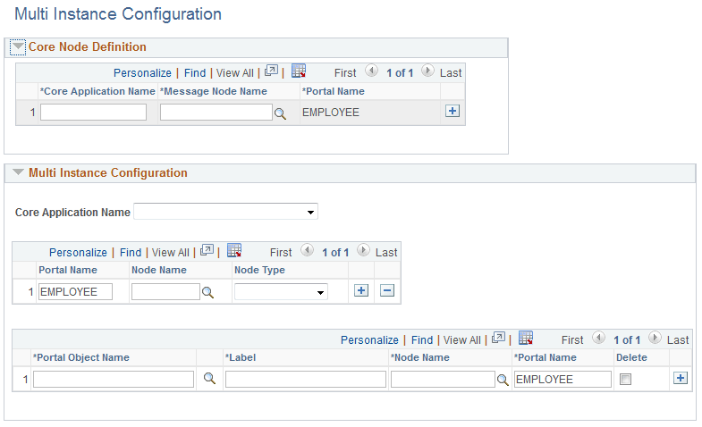

Use the Multi Instance Configuration page to define the core application and the participating instances.
Navigation:
This example illustrates the fields and controls on the Multi Instance Configuration Page. You can find definitions for the fields and controls later on this page.
Core Node Definition
Field or Control |
Description |
Core Application Name |
The name of the core application for which you need to set up multiple instances. The core application is the content provider system in unified navigation. |
Message Node Name |
The message node of the core application. For example, HRMS. |
Portal Name |
The portal on which the unified navigation cluster is created. The portal name is populated by default based on your unified navigation configuration. On clicking Save, the core application information is saved and is available for selection in the Multi Instance Configuration section. |
Field or Control |
Description |
The core application name entered in the Core Node Definition section is available for selection. |
Portal Name |
The portal on which the unified navigation cluster is created. The portal name is populated by default based on your unified navigation configuration. |
Node Name |
Select a node. For example, select HRMS, |
Node Type |
Choose a node type from the following: Participant - the node that represents the participating instances, for example, HRMS_RECRUIT, Portal - the node that represents the portal system, for example, EMPL. Primary - the node that represents the core application, for example, HRMS. |
Portal Object Name |
The application instance that you want to include in the multi-instance setup. For example, HC_TIME_AND_LABOR. |
Label |
The label entered here is visible on the folder structure. For example, Time and Labor EMEA. |
Node Name |
The node applicable for the instance. For example, HRMS_EMEA. |

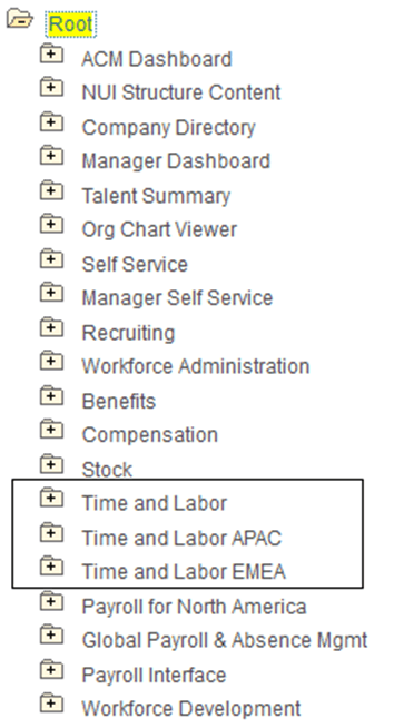

Navigation Group Based on User Level Split
In a user-level split, you direct a user to an appropriate instance.
For example, two instances of Time and Labor are set up in the multi-instance system based on geographical location (EMEA and APAC) and user is directed to the appropriate instance based on the geographical location.
This example illustrates the folder structure when you create navigation group based on user-level split.
