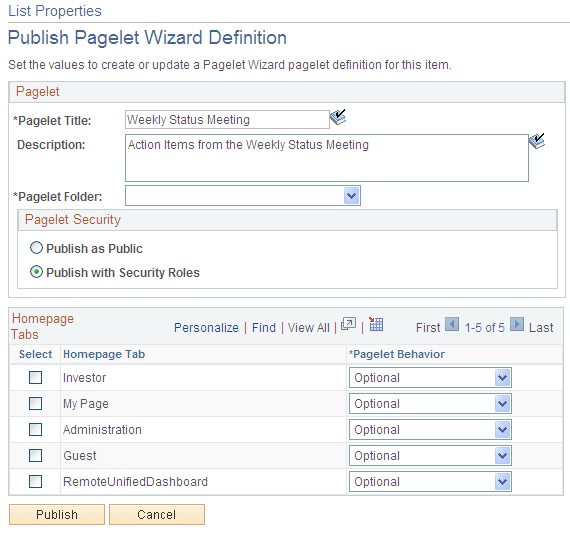

Use the List Properties - Publish Pagelet Wizard Definition page (EPPPB_PGLT_PUB) to create a pagelet definition for an action item list.
Navigation:
My Content, My Action Item Lists
Click the Properties link for the action item list.
Click the Publish as Pagelet link on the List Properties page.
Click the Add Pagelet button or the Edit button on the List Properties - Publish as Pagelet page.
The following example illustrates the List Properties - Publish Pagelet Wizard Definition page. Access the List Properties - Publish Pagelet Wizard Definition page (click the Publish as Pagelet link on the List Properties page) as shown below.
Use the List Properties - Publish Pagelet Wizard Definition page to create a pagelet definition for an action item list.
Pagelet
The pagelet title and description from the List Properties page appear in the Pagelet group box. You can edit these two fields, if necessary.
Field or Control |
Description |
Pagelet Title |
Displays the title for the action item list, which can be edited as the title for the pagelet. |
Description |
Displays the description for the action item list, which can be edited as the description for the pagelet. |
Pagelet Folder |
Select a folder to publish to. Only folders from the current site are available to select. |
Pagelet Security |
Select the security options for viewing the pagelet. Available options are: Publish as Public, which enables all users to view the pagelet. Publish with Security Roles, which uses the roles defined on the List Security page when publishing the pagelet. Note: If there are no roles defined on the List Security page, the system automatically selects to publish the pagelet as public. |
Homepage Tabs
Use this group box to define the homepage tab labels and behavior for the pagelet.
Field or Control |
Description |
Homepage Tab |
Select the tabs that will display the pagelet. |
Pagelet Behavior |
Select the behavior options for the pagelet. Optional. The pagelet will not automatically appear on the homepage. However, it is available for selection when users personalize their homepages. This setting should not be used for guest homepage pagelets because guest users do not have personalization privileges. Optional-Default. The pagelet will appear on all user homepages if they have access to the pagelet. The pagelet can be removed when users personalize their homepages. This setting should not be used for guest homepage pagelets because guest users do not have personalization privileges. Required-Fixed. The pagelet will appear on all user homepages if they have access to the pagelet. The placement of the pagelet cannot be changed and the pagelet cannot be removed from the homepage. Required. The pagelet will appear on all user homepages if they have access to the pagelet. The placement of the pagelet can be changed, but it cannot be removed from the homepage. |
Publish |
Click the Publish button to publish this pagelet and display the List Properties - Publish as Pagelet page, on which you can review or edit the pagelet definition |

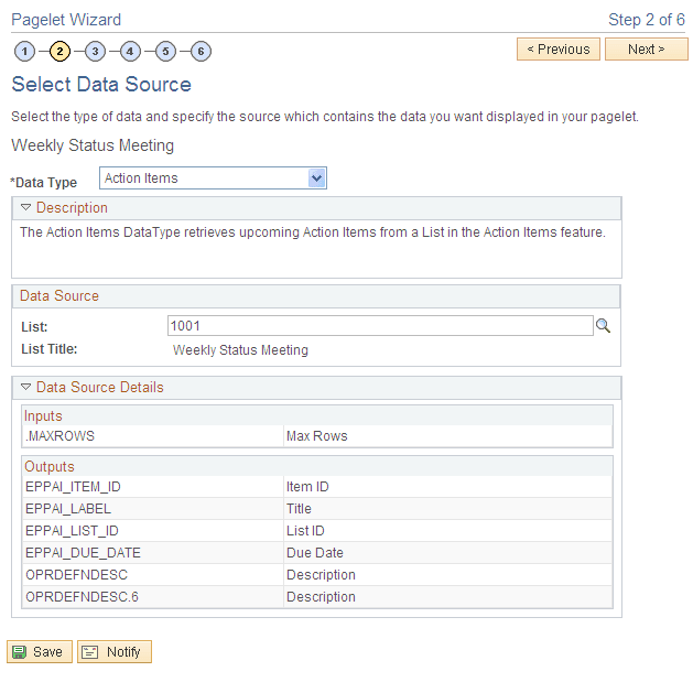

Step 2: Selecting a Pagelet Data Source
Use the Pagelet Wizard - Select Data Source page (PTPPB_WIZ_DATASRC) to select the type of data source for the pagelet.
Navigation:
Click the Next button on the Pagelet Wizard - Specify Pagelet Information page.
Click the Data Type button from any page in the wizard.
The following example illustrates the Pagelet Wizard - Select Data Source page (action items data type).
Use the Pagelet Wizard - Select Data Source page to select the Pagelet Wizard data source type.
Field or Control |
Description |
Data Type |
For action item lists, select Action Items. |
List |
Select the action item list to display in the pagelet. |
Inputs |
Displays the data source parameters that are used to retrieve data for the pagelet. |
Outputs |
Displays the data source parameter fields that are displayed as output in the pagelet. |

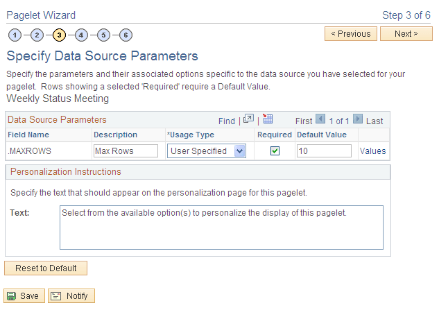

Step 3: Specifying Data Source Parameters
Use the Pagelet Wizard - Specify Data Source Parameters page (PTPPB_WIZ_DATAPRMS) to configure the data source parameters that are required for data to be displayed in the pagelet.
Navigation:
Click the Next button on the Pagelet Wizard - Select Data Source page.
Click the Data Source Parameters button from any page in the wizard.
The following example illustrates the Pagelet Wizard - Specify Data Source Parameters page (action items data source).
Use the Pagelet Wizard - Specify Data Source Parameters page to configure the data source parameters that are required for data to be displayed in the pagelet.
Note: This page is accessible only when you are building a pagelet with a data source that allows modification of associated parameters.
Field or Control |
Description |
Field Name |
Displays the name of the data source parameter. For action item lists, the following data source parameters can be defined: MAXROWS — Limits the number of entries displayed in the pagelet |
Description |
Displays a description of the data source parameter. |
Usage Type |
Select the type of accessibility that you want to grant for the data source parameter when it appears in the pagelet. Options are:
Required |
This check box is selected and disabled for parameters specified as administrator-specified, context-sensitive, fixed, and system variable; otherwise, it is selected but enabled for user-specified parameters. |
Default Value |
You can enter a value that includes the % and * wildcards at the beginning or end of a value in the Default Value field. Note the following about default values:
Values |
If you select User Specified or Admin Specified as the usage type, click Values to access the Pagelet Wizard - Specify Data Source Parameter Values page. |
Text |
Use the Personalization Instructions group box to enter custom personalization instructions for the pagelet. These personalization instructions appear on the personalization page of the pagelet. Note: Personalization instructions must be translatable. |

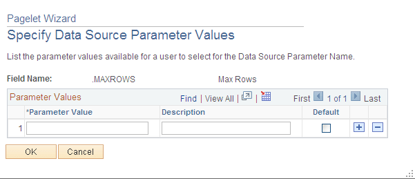

Specifying Prompt Values for Data Source Parameters
Use the Pagelet Wizard - Specify Data Source Parameter Values page (PTPPB_WIZ_PRMVALS) to specify prompt values for the end user to select from when personalizing the pagelet.
Navigation:
Click the Values link on the Pagelet Wizard - Specify Data Source Parameters page.
The following example illustrates the Pagelet Wizard - Specify Data Source Parameter Values page (action items data source).
Use the Pagelet Wizard - Specify Data Source Parameter Values page to specify the prompt values, which are displayed to users when they personalize the pagelet. In addition, specify the default value for the parameter.
Field or Control |
Description |
Parameter Value |
Specify the parameter value. |
Field or Control |
Description |
Description |
Provide an optional description of the parameter value. |
Field or Control |
Description |
Default |
Select one value as the default value. If the parameter is required, then a default value is required; otherwise, it is optional. |

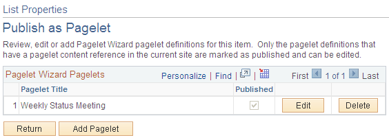

Use the List Properties - Publish as Pagelet page (EPPPB_PGLT_LST) to administer pagelet definitions for an action item list.
Navigation:
Click the Publish button on the List Properties - Publish Pagelet Wizard Definition page.
If this action item list has already been published as a pagelet, click the Publish as Pagelet link on the List Properties page.
The following example illustrates the List Properties - Publish as Pagelet page.
Use the List Properties - Publish as Pagelet page to review, edit, or add Pagelet Wizard pagelet definitions for this action item list. To edit a pagelet definition, it must be marked as published and have a content reference in the current site.
Note: Pagelets for this action item list published directly from Pagelet Wizard also appear in this list.
Field or Control |
Description |
Edit |
Displays the List Properties - Publish Pagelet Wizard Definition page on which you can make changes to the pagelet definition. |
Delete |
Deletes this pagelet definition and the published pagelet content references in all sites. |
Add Pagelet |
Adds a new pagelet definition based on the current action item list. |
