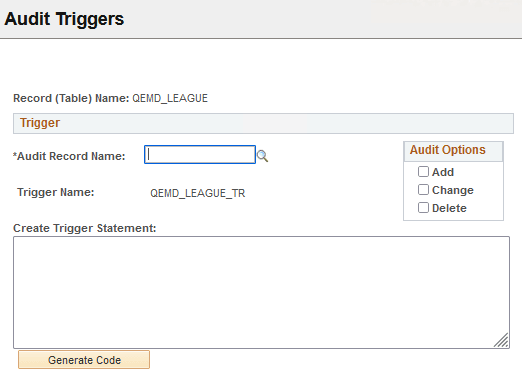

Select PeopleTools > Utilities > Audit > Maintain Audit Triggers, and search by Record (Table) Name, Audit Record Name, or Trigger Name to access the Audit Triggers page.
This example illustrates the fields and controls on the Audit Triggers page.
Audit Triggers page
Field or Control
Description
Audit Record Name
Use the Browse button to search the PSRECDEFN table. The Audit name must exist before a trigger can be created.
Trigger Name
By default, the system names audit triggers by using the following naming convention <base record>_TR, for example, ABSENCE_HIST_TR.
Audit Options
Select from the options Add, Change or Delete.
Create Trigger Statement
The statement is populated when the Generate Code button is clicked. You can customize the script if you need to. It depends on your preference. One of the following sections contains RDBMS information to help you view the contents of the script.
Generate Code
Click this button when you complete the previous fields to generate the Trigger Statement.
