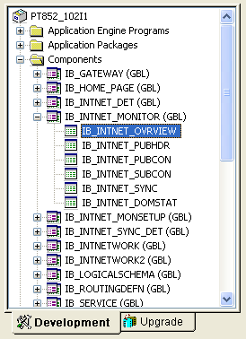

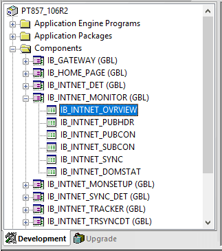

This table describes the six main elements that comprise the PeopleSoft Application Designer user interface:
Element |
Description |
Title bar |
Displays the name of the database, the active project (optional), and the active definition (optional) in the following format:
Menu |
Provides access to PeopleSoft Application Designer items and features. |
Toolbar |
Displays buttons that are useful in editing the active definition. |
Project workspace |
Provides a graphical representation of the components that are contained in a project. The project workspace has two folder tabs:
Definition workspace |
Displays individual definitions that you open. |
Output window |
Contains the output text from PeopleSoft Application Designer operations, such as Build (SQL Create and Alter), Find Definition References, Upgrade, Results, Validate, and PeopleCode Log. |

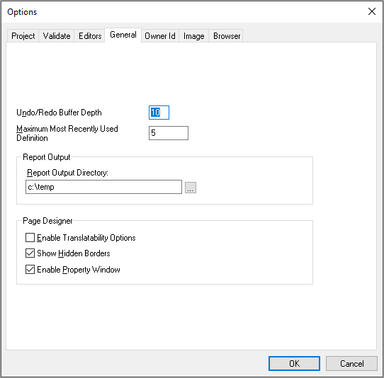

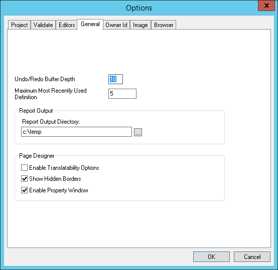

Options |
Select commands specifying insertion commands, definition language preference, validating options, PeopleCode fonts, definition owner ID, and more. |

Project Workspace
View projects and their associated definitions in the project workspace. A project organizes a collection of definitions in logical groups for easier development, adaptation, maintenance, and upgrade.
This example illustrates the fields and controls on the Project workspace shown with a project open. You can find definitions for the fields and controls later on this page.
Work with a development project or an upgrade project by selecting either the Development tab or the Upgrade tab at the bottom of the project workspace.
The text on the Development and Upgrade tabs might not appear if your monitor is not large enough to display it.

You can set preferences for various features in the Options dialog box. Select to access the Options dialog box. Seven tabs appear on the dialog box and each tab features configurable options for different areas of PeopleSoft Application Designer. Most of these options are described in further detail in other, more relevant areas of the product documentation. The following topics provides a general description of each tab and a link to further details about the options:

General
This example illustrates the fields and controls on the Options dialog box: General tab. You can find definitions for the fields and controls later on this page.
Field or Control |
Description |
Undo/Redo Buffer Depth |
Enter the number of most recently performed actions for PeopleSoft Application Designer to store in memory. The default value is 10, which mean that you can undo up to 10 immediately previous actions, such as adding or deleting page fields from a page. |
Maximum Most Recently Used Definition |
Enter the number of recently opened definitions to appear in a list at the bottom of the File menu in PeopleSoft Application Designer. The default value is 5. |
Report Output Directory |
Enter the output destination of the reports that you run in PeopleSoft Application Designer. Reports include upgrade, build, and definition reference reports. |
Enable Translatability Options |
Select to enable the following translatability options:
Note: Translation warnings only appear when your base language value in Configuration Manager is English. |
Show Hidden Borders |
Select to enable the borders of hidden group boxes and frames to appear as dashed lines indicating the boundary of all hidden group box and frame page control types. |
Enable Property Window |
Select to enable the property window for page controls. See Using the Property Window for more information. Note: You must close and restart Application Designer for this setting to take effect. |
