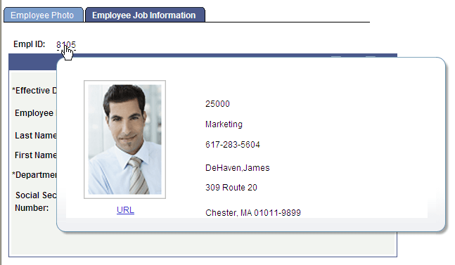

Context-Sensitive Pop-up Page Example
In this example, you see a User Details pop-up page. This page is associated with a view, which retrieves information so that the page displays the employee's name, photo, department, phone number, address, and web site URL.
This example illustrates the fields and controls on the User Details pop-up page. You can find definitions for the fields and controls later on this page.
The fields on the pop-up page reference PS_EMPL_VW. The key field of PS_EMPL_VW is EMPLID, which requires that the EMPLID field exist on the main page.
The field to which the pop-up page is linked is at level 0, which requires that EMPLID be at level 0 also.
Note: EMPLID is a key field on the PS_EMPL_VW record that the pop-up page references. While EMPLID also happens to be a key field on the PS_EMPL_JOB record that the transaction page references, it is not a requirement.

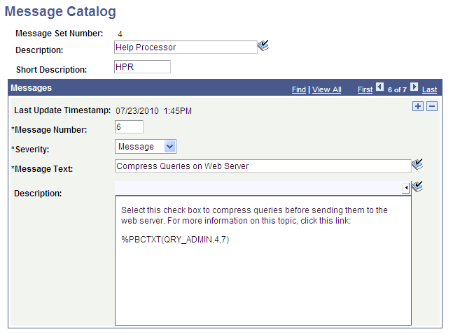

Embedding Links to Context-Sensitive Help in Pop-up Pages
You can add variables to a message to embed links to context-sensitive online help.
Note: You must correctly configure and implement PeopleSoft online help.
To add variables to messages to embed links to context-sensitive help:
Access the Message Catalog (PeopleTools, Utilities, Administration, Message Catalog to access the Message Catalog).
Select an existing message or create a new message.
Enter an explanation and place the variable in the Explanation field.
The table in the next section describes the variables and their usage.
Note: The text in the Message Text field appears as the pop-up page header. The text in the Explanation field appears in the pop-up page body.
Enable the pop-up page on the desired edit box control.

Example
In this example, the %PBCTXT variable
uses QRY_ADMIN as a CONTEXT_ID that references the Query Administration
page in PeopleBooks:
This example illustrates the fields and controls on the Message Catalog page with context-sensitive variable embedded in text. You can find definitions for the fields and controls later on this page.
In the Description field, the 4, 7 parameters refer to Message Catalog entry (4,7), which contains the label to use for the generated link.
This example illustrates the fields and controls on the Message Catalog page showing Query Administration label in the Message Text field. You can find definitions for the fields and controls later on this page.

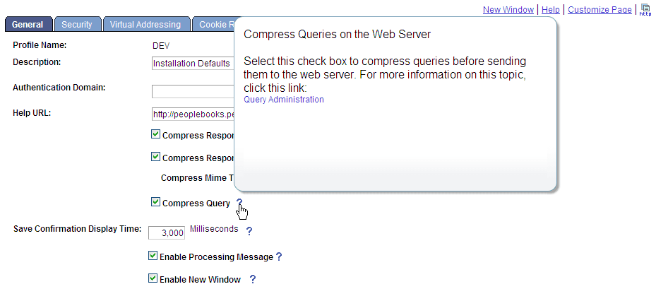

On the Web Profile Configuration page at runtime, mouse over the selected control to see the generated pop-up page:
This example illustrates the fields and controls on the Web Profile - General page showing the message catalog pop-up page. You can find definitions for the fields and controls later on this page.
Notice that the pop-up text comes from Message Catalog entry (4,6) and the link label, Query Administration, defined by the %PBCTXT(QRY_ADMIN, 4, 7) function comes from Message Catalog entry 4,7. Click the Query Administration link, and the system accesses the PeopleBooks entry for the QRY_ADMIN CONTEXT_ID using that Help URL entry to ascertain the PeopleBooks location on the web server.
