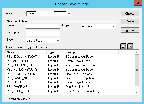

This section describes the layout pages you can use as the basis for any new fluid pages. Layout pages can be compared to templates. They provide a basic structure to get you started with a fluid page.
Important! Do not include a layout page in any component definition. Layout pages are templates only for the generation of a new fluid page definition.
This example illustrates the layout page options provided by the Choose Layout Page dialog box.
In your new page definition, you may add or remove elements as needed for your purposes. However, make sure to examine the template pages so that you understand how any existing PeopleCode or CSS styles affect the interface.
Important! Not all of the delivered layout pages are intended for external usage.
Recommended Layout Pages
This table describes the layout pages suitable for fluid application development.
