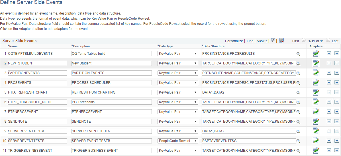

Use the Define Server Side Events page to define the data type and data structure for state changes that occur on the server. Examples of state changes include:
Process Scheduler process or job status change.
Approval notification for a workflow.
A custom state change such as adding or updating a row in an application data table.
Navigation:
The following example shows the Server Side Events grid where you add server side events.
Field or Control |
Description |
Name |
Enter a unique name for the event. |
Description |
Enter a description of the event. |
Data Type |
Select between KeyValue Pair or PeopleCode Rowset. The data type defines how the system structures the event data while publishing the event. The value you assign determines what you enter for a data structure. |
Data Structure |
Enter the Data Structure value, depending on the Data Type selected.
Use delivered PeopleCode application classes to set event data (in the form of key-value pairs or record field data) when publishing the event. |
Adapters |
Note: Mobile Application Framework (MAF) has been desupported as of PeopleTools 8.59.03. While the documentation of this feature has been removed at this time, the feature remains available in the PeopleSoft system. MAF will be fully removed in a future PeopleTools release. Adapters are used for sending push notifications to mobile applications running in the Oracle Mobile Application Framework (MAF). An adapter is associated with a server side event. |

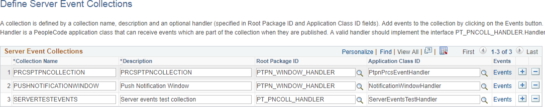

Use the Define Server Event Collections page to define event collections and add defined events to a collection.
Navigation:
This example illustrates the fields and controls on the Define Server Event Collections Page. You can find definitions for the fields and controls later on this page.
Field or Control |
Description |
Collection Name |
Enter the unique name for the event collection. |
Description |
Enter a description of the event collection. |
Root Package ID |
Select the PeopleCode application package that contains the application class that is the handler for this collection. |
Application Class ID |
Select the PeopleCode application class that handles the events that are part of the event collection when they are published. A valid handler class implements the PT_PNCOLL_HANDLER:Handler interface. |
Events |
Click the Events link to maintain the events for the event collection using the Add Events page. If an endpoint is subscribed to the collection, then it will receive the push notifications for each of the events listed in this page. |

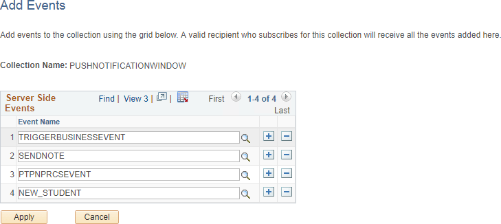

Add Events Page
Use the Add Events page to maintain the events associated with an event collection.
This example illustrates the fields and controls on the Add Events page.

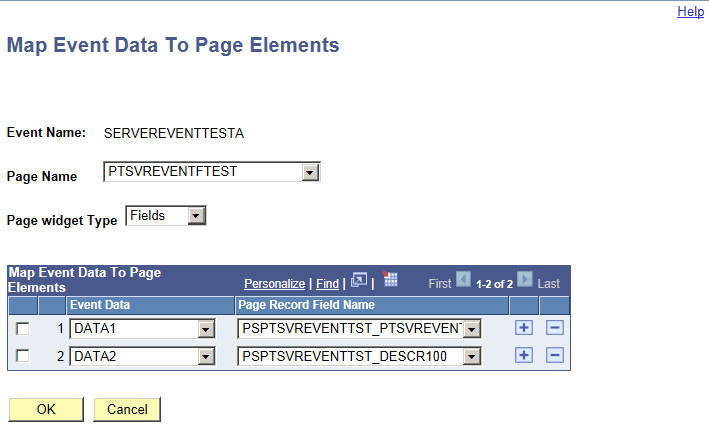

Subscribing to an Event Using Interwindow Communication (IWC)
Use IWC to subscribe a PeopleSoft page to a published event, where the event model is mapped to page elements, such as fields and grids. Creating a subscription does not require any changes to the page. When the event is published from the server, the page is updated automatically with the event data.
To subscribe to an event through IWC:
In the browser, select .
Navigate through the portal registry folders and select the content reference definition for the component.
Click theIWC Message Events link on the Content Ref Administration page.
Select the Add a New Value tab, and click Add.
Add a new row on the IWC Message Events page, specifying these values:
Event Name: Enter the name of a defined event.
Message Event Type: Select Server Sub.
Click the Map to display the Map Events Data to Page Elements page.
On the Map Events Data To Page Elements page you can map the data of a defined event to a page element.
Field or Control |
Description |
Event Name |
Displays the event name that was entered on the Content Reference Message Events page. |
Page Name |
Select the page where you want the event subscription added. |
Page widget Type |
Select either Fields or Grid. |
Event Data |
Select one of the data elements defined for the event. The drop-down will display key values if the event data type is KeyValue Pair and record fields if the event data type is PeopleCode Rowset. |
Page Record Field Name |
Select the page record field name for the page element to be updated. |

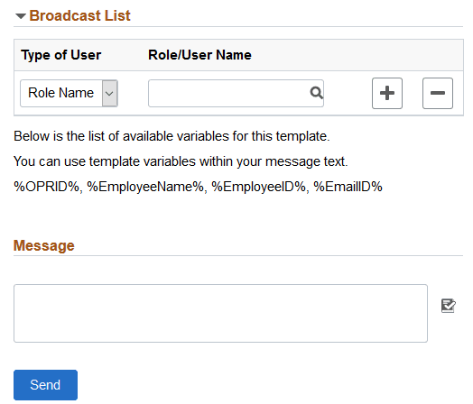

Use the Broadcast Message page as a testing utility to send broadcast messages to selected users by role or user ID.
Navigation:
This example illustrates the fields and controls on the Broadcast Message page. You can find definitions for the fields and controls later on this page.
Field or Control |
Description |
Type of User |
Select from these types:
Role/User Name |
Select the role or user ID to be the recipient of the broadcast message. |
Message |
Enter the message as free-form text. You can use the following variables within the message body:
