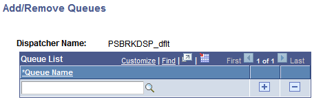

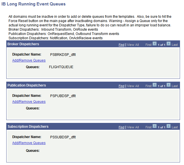

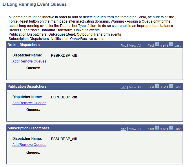

Adding and Removing Dispatcher Queues from Template Secondary Domains
This section applies only to asynchronous secondary templates.

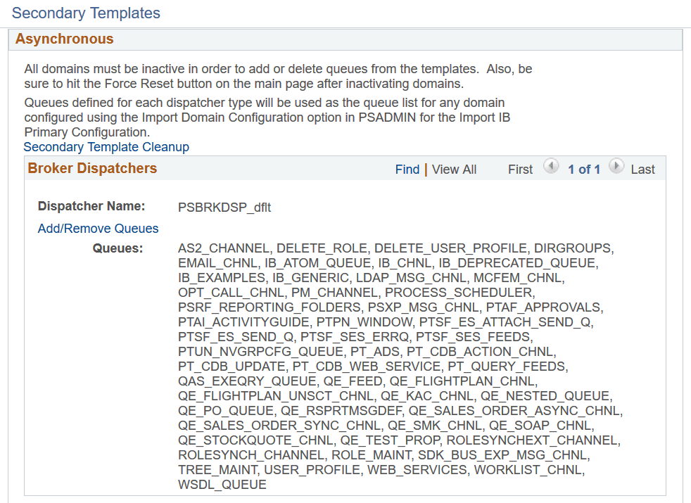

Template secondary domains contain all of the dispatcher queues that exist on the domain on which it is based. However, you can add and remove queues to configure the template secondary domain to suit your requirements.
Note: Before you can add or remove queues from a template secondary, you must inactivate all domains.
The Secondary Templates page (IB_DOMAIN2_SEC) lists the dispatcher queues assigned to each dispatcher process of the template secondary.
This example illustrates the Secondary Templates page. Use this page to view the queues assigned to each dispatcher process of a template secondary.

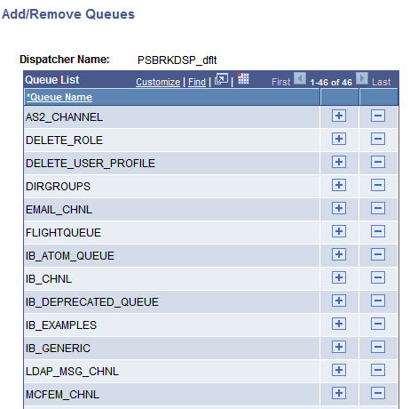

From the Secondary Templates page, you can use the Add/Remove Queues link located under each dispatcher process name to access the Add/Remove Queues page to add or remove queues assigned to the dispatcher.
This example illustrates the Add/Remove Queues page. Use this page to add or remove queues for a dispatcher process of a template secondary.
Note that this example shows a partial queue list for the domain.
On the Add/Remove Queues page you can use the plus (+) button to add a queue to the queue list. Use the minus (-) button to remove a queue from the list.

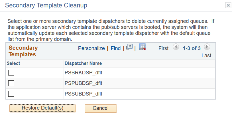

Restoring Template Secondary Dispatcher Queue Lists
Restoring a queue list deletes any changes you have made to a template secondary dispatcher queue list, and restores it to the queue list that you originally imported from the primary domain.
To restore a template secondary queue list, use the Secondary Template Cleanup page (IB_DOMAIN3_SEC).
This example illustrates the Secondary Template Cleanup page. Use this page to restore dispatcher queue lists to the default settings from the primary domain.
In the previous example, PSBRKDSP_dflt appears in the Dispatcher Name field, meaning that additions or deletions have been made to the queue. In this example, you could use the page to restore the default template secondary dispatcher list for PSBRKDSP_dflt.
To restore a template secondary dispatcher queue list, you must first inactivate all domains on the system.
To restore a template secondary dispatcher queue list:
Inactivate the domains on the messaging system:
Access the Domain Status page ().
Check the All Domains Inactive box and click the Update button.
The Force Reset button appears.
Click the Force Reset button to reset any contacts that are in a Started or Working state.
Access the Secondary Template Cleanup page:
From the Domain Status page, click the Secondary Templates link.
The Secondary Templates page appears.
On the Secondary Templates page, click the Secondary Template Cleanup link.
The Secondary Template Cleanup page appears.
Check the box next to each dispatcher process name for which you want to restore the default queue list.
Click the Restore Default(s) button.
The Domain Status page appears.
Activate the domains in the messaging system.
Check the All Domains Active box and click the Update button to activate the domains.

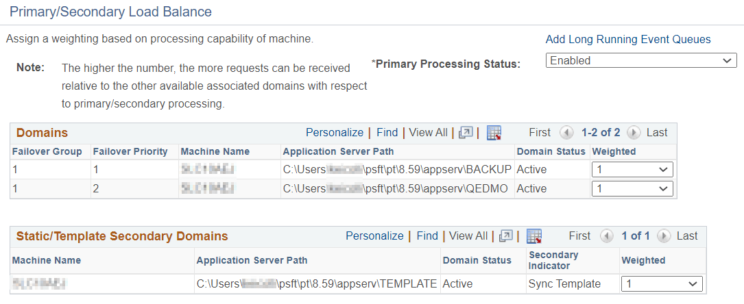

This section provides and overview of primary-secondary load balancing and discusses how to set up primary-secondary load balancing on the PeopleSoft system.
Understanding Primary-Secondary Load Balancing
You can implement primary-secondary load balancing on the integration system to compensate for processing capabilities of various machines on which primary domains and secondary domains run.
As an example, you might have a domain on machine that is also running the PeopleSoft Pure Internet Architecture. In this case, you could configure primary-secondary load balancing such that the machine that is running the PeopleSoft Pure Internet Architecture processes fewer requests than other machines on which domains reside.
Another example is a situation where the machines on which you are running domains have different processing capabilities due to the hardware installed in them. In this situation you can configure the machines with the most process power to process the greater number of requests.
To configure primary-secondary load balancing, you assign a weight between 1 and 10 to each domain to distribute request processing. A domain assigned a weighted value of 1 processes the fewest requests; a domain assigned a weighted value of 10 processes the greatest number of requests.
Setting Up Primary-Secondary Load Balancing
You set up primary-secondary load balancing using the Primary/Secondary Load Balancing page (IB_DOMAIN_SEC).
To set up primary-secondary load balancing, you assign a processing weight value to each domain. The domain with the lowest number processes the fewest number of requests and is the primary domain. The domains with the higher numbers are the secondary domains and process the greatest number of requests.
This example illustrates the Primary/Secondary Load Balance page. The example shows primary-secondary load balancing set up for the system.
The Domain section on the page lists information for the primary domain, while the Static/Template Secondary Domains section lists information about static secondary domains.
The example shows two domains configured on one machine. The domains listed in the Domains section, BACKUP and QEDMO, are the primary domains and have a load balance weight of 1 assigned to it. Given the load balance weight assigned to the domains, they processes the fewest number of requests.
The domain listed in the Static/Template Secondary Domains section, TEMPLATE, has a load balance weight of 1 assigned to it. It processes the same number of requests as the master domain.
To set up primary-secondary load balancing:
Access the Primary/Secondary Load Balance page ( and click the Primary/Secondary Load Balance link.).
For each domain select a value from the Weighted drop-down list box to assign a load balancing weight for the domain.
Click the OK button.

You use the IB Long Running Event Queues page (IB_DOMAIN4_SEC) to assign service operations to long-running event queues.
This example illustrates the IB Long Running Event Queues page.
To assign a service operation to a long-running event queue, you add the service operation queue that is currently defined on the service operation definition to one of the dispatcher queues on the page. When you click the Add/Remove Queues link for one of the dispatchers, the Add/Remove Queues page (PSIBQUEUE_SEC) appears.
This example illustrates the Add/Remove Queue page.
You use the Lookup button on the page to search for the service operation queue to which the service operation is assigned. When you click the OK button, the IB Long Running Event Queues page appears and the queue you specified appears in the dispatcher Queue field.
This example illustrates the IB Long Running Event Queues page. The example shows the service operation queue FLIGHTQUEUE added to the Broker Dispatcher queue.
The following table describes the proper dispatchers to which to assign service operation queues based on the type of processing required:
Dispatcher |
Processing |
Broker Dispatcher |
Publication Dispatcher |
Subscription Dispatcher |
Important! Do not assign service operations that contain long-running events to the same queues as those that do not contain long-running events. Processing performance for the normal high-volume service operations can be impacted.

Click the Add/Delete Queue link for the dispatcher to which to add the service operation queue.
The Add/Remove Queues page appears.
Enter a name or use the Lookup button to search for the name of the queue to which the service operation is assigned.
Click the Update button.
