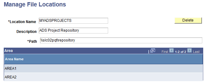

Use the Manage File Locations page to register paths to valid Project Repository locations.
Navigation:
This example illustrates the fields and controls on the Manage File Locations page. You can find definitions for the fields and controls later on this page.

Location Name |
Assign a name for your file location. |
Description |
Optionally add a description for the file location. |
Path |
The specified path must be accessible from both the application server and the process scheduler server. Absolute network paths are less prone to issues in this respect as all servers are not likely to be running on the same machine, thus may not have access to a local or relative path. If the application server is on Windows and the process scheduler server is on non-Windows or conversely, your system administrator will need to provide special setup to share files across machine boundaries. Note: On Windows, you must use a UNC naming convention, such as \\<servername>\<sharename>. On UNIX based platforms, you must use absolute path, such as /<rootdir>/<subdir/.../<subdir>. |
Area |
The area grid is populated with the sub directories in the path. |
