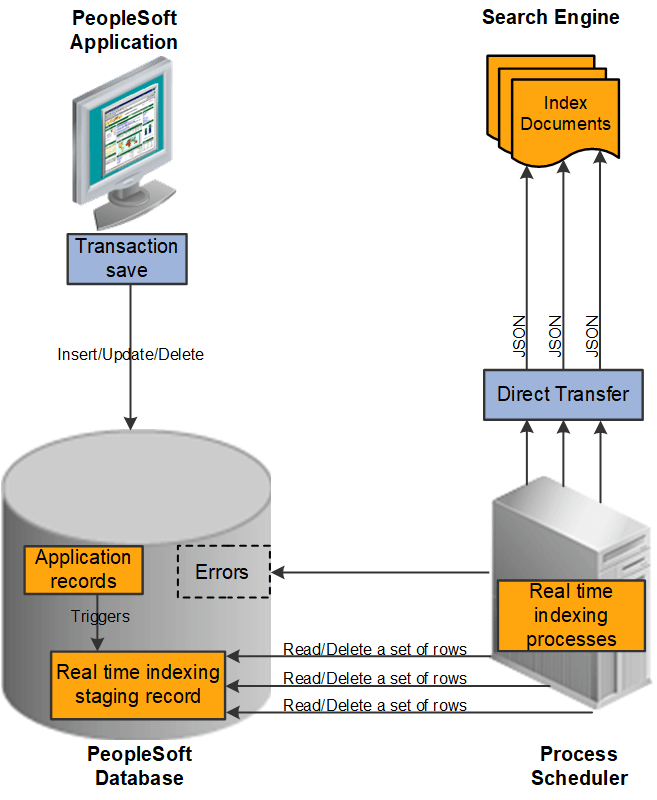

Search Framework implements set based processing in real-time indexing as shown in the following diagram.
The following diagram illustrates the process flow of the real-time indexing process.
Real time indexing process flow
Real-time indexing uses database triggers as the initializing point for the communication to the search server. As the data is inserted, updated, or deleted, the database trigger associated with the application record inserts a row in the real-time indexing staging table. The staging table acts as an interim data holder by storing the keys of the transaction.
Note: When batch processing is enabled for a search definition, updated data is not pushed to the real-time indexing staging table for the search definition. For more information, see Turning Off Real-Time Indexing During Batch Processing.
A dedicated Process Scheduler process for real-time indexing polls the staging table at regular intervals for any data to process. You can configure the number of processes in the Process Scheduler configuration properties file. By default, only one process is initiated. You may scale up the number of processes by changing the maximum number of instances. However, the current design is limited to enable real-time indexing on one domain only. Enabling real-time indexing on more than one domain causes the same dataset to be picked by both processes resulting in duplicate processing.
Real-time indexing processes the transactions stored in the staging table as a set. The size of the set is a configurable parameter in the Search Options page, which can be specified as per the available resources in the Process Scheduler server. A set can contain just one transaction or it can contain the maximum number of transactions as specified in the Real Time Indexing Set Size property based on the available data at any point in time.
Real-time indexing again processes each set for a specific search definition and begins the data retrieval process for each search definition. After the data is collected and formatted to a JSON structure, it is transferred to the search server using Direct Transfer.
