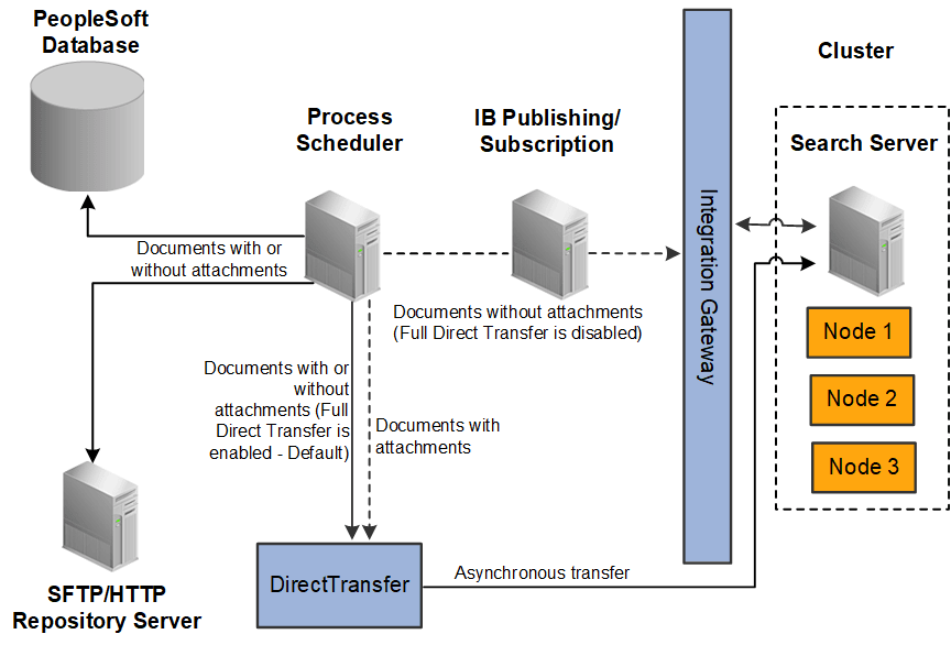

Direct Transfer is a PeopleSoft technology used to transmit search indexing data directly from PeopleSoft batch servers to the search engine. This technology sends the data directly without having the overhead of passing the data through the Integration Broker Gateway and Web server.
PeopleSoft Search Framework implements Direct Transfer technology to transfer search data (search documents with attachments and search documents without attachments) directly to the search engine bypassing the Integration Gateway. This feature is called Full Direct Transfer, which is the default option in PeopleSoft Search Framework. However, PeopleSoft enables you to choose whether you want to use the Full Direct Transfer option or not. If you choose not to use the Full Direct Transfer option, then search documents without attachments will be transmitted through the Integration Gateway but, the search documents with attachments will be transmitted directly to the search engine.
Direct Transfer technology supports search definitions that are based on Connected Query and Query.
The following graphic depicts PeopleSoft downloading search documents from database, attachment repository, and HTTP repository, and then pushing encoded data to the search engine using Direct Transfer. The search engine uses Mapper attachment plug-in to parse attachment contents for indexing.

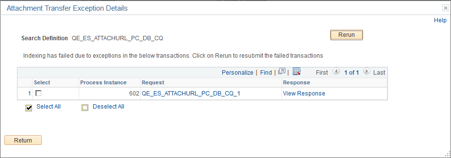

On the Build Search Index page, in the Previous schedule details section, an Error link is displayed if an error occurs while indexing ().
Full Direct Transfer is enabled — During indexing, there could be possibilities that certain data transactions may not be successful either due to temporary system situations (for example, the search engine is performing some internal maintenance operations) or due to data issues. In such cases, Direct Transfer stores the request and response of the transaction that goes into error in an error table, and proceeds with further indexing.
After the indexing process is complete, errors, if any, can be viewed on the Build Index page (Previous schedule details section).
Full Direct Transfer is disabled — During the indexing of search documents with attachments (which are transmitted directly to the search engine), if any error occurs, an Error link is displayed on the Build Search Index page.
During the indexing of search documents without attachments (which are transmitted through the Integration Gateway), if any error occurs in IB transactions, an Error link may not be displayed on the Build Search Index page. You need to check the Process Monitor whether the PTSF_GENFEED Application Engine program displays No Success status. If the status of the PTSF_GENFEED Application Engine program is No Success, administrators must review the IB monitor logs for details on the error.
Based on the type of error, an administrator can use the Rerun option to resubmit the transactions if the issue was related to temporary environment problems, or can review the data and correct the data at the source, or can determine whether the data that is causing the error can be omitted for indexing. If the data needs to be corrected at source, then the indexing process should be executed again to get the correct data indexed.
Click the Error link to display the Attachment Transfer Exception Details page.
This example illustrates the fields and controls on the Attachment Transfer Exception Details page. You can find definitions for the fields and controls later on this page.
Field or Control |
Description |
Process Instance |
The process instance ID of the PTSF_GENFEED Application Engine program that is causing the exception. |
Request |
The request sent by the PTSF_GENFEED Application Engine program to the search engine. |
Response |
The response received by the PTSF_GENFEED Application Engine program from the search engine. |
Rerun |
Use the Rerun button to resubmit the selected error transactions to the search engine. The progress of the transaction can be monitored using the Process Monitor page on PIA. When a transaction is successful, it is deleted from the error pages. In the case where the maximum exceptions limit is not reached, when you select the Rerun button:
In the case where the maximum exceptions limit is reached, the Rerun button acts as a re-submit of the PTSF_GENFEED Application Engine program. After re-running the PTSF_GENFEED Application Engine program, if the transaction is not successful, the error tables are updated with the latest error message. |

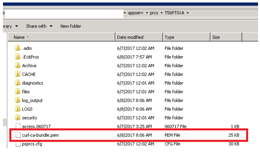

For Direct Transfer to work with SSL enabled OpenSearch, the Certification Authority (CA) certificate should be available in the Digital Certificate repository of PeopleSoft. This is to ensure that when the Direct Transfer process is run, the root certificates are obtained from the repository to create a CA certificate bundle and use it for secured communication between the Process Scheduler server and OpenSearch.
To make the CA certificate available in the Digital Certificate repository of PeopleSoft, add the CA certificate of OpenSearch to .
This example illustrates the Digital Certificates page.
When the process starts, the certificate bundle in PEM format is available in the Process Scheduler server folder.
This example illustrates the certificate bundle in PEM format.
