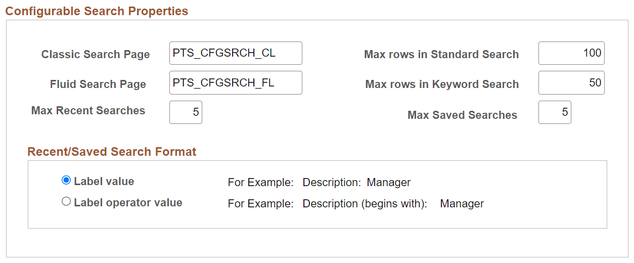

The implementation of configurable search requires you to specify system-wide search properties on the PeopleTools Options page and specify component content reference specific properties on the Manage Configurable Search page.
On the PeopleTools Options page, use the Configurable Search Properties group box to specify system-wide configurable search properties.
Access the PeopleTools Options page by selecting PeopleTools > Utilities > Administration > PeopleTools Options.
This example illustrates the properties for configurable search on the PeopleTools Options page. Descriptions of the properties appear after the example.
PeopleTools Options page: Configurable Search Properties
Field or Control
Description
Classic Search Page
The search page that you specify here acts as the system-wide search page for classic components.
Clone the delivered classic search page, PTS_CFGSRCH_CL, to create a custom search page. However, you may create your own search page without cloning the delivered search page.
Fluid Search Page
The search page that you specify here acts as the system-wide search page for fluid components configurable search.
Clone the delivered fluid search page, PTS_CFGSRCH_FL, to create a custom search page. However, you may create your own search page without cloning the delivered search page.
Max Recent Searches
Specify the maximum number of recent searches that can be stored for a component.
You can choose between 0 and 999.
The default value is 5.
Note: The value entered here is overridden when you specify a value in the maximum recent searches field for a specific content reference on the Search Configuration page.
Max rows in Standard Search
Specify the number of search results that should be displayed to an end user while performing a standard search.
The default value is 100.
Max rows in Keyword Search
Specify the number of search results that should be displayed to an end user while performing a keyword search.
The default value is 50.
Max Saved Searches
Specify the maximum number of searches that can be stored for a component.
Note: The value entered here is overridden when you specify a value in the maximum saved searches field for a specific content reference on the Search Configuration page.
Recent/Saved Search Format grid
Options:
  • Label value
  • Label operator value

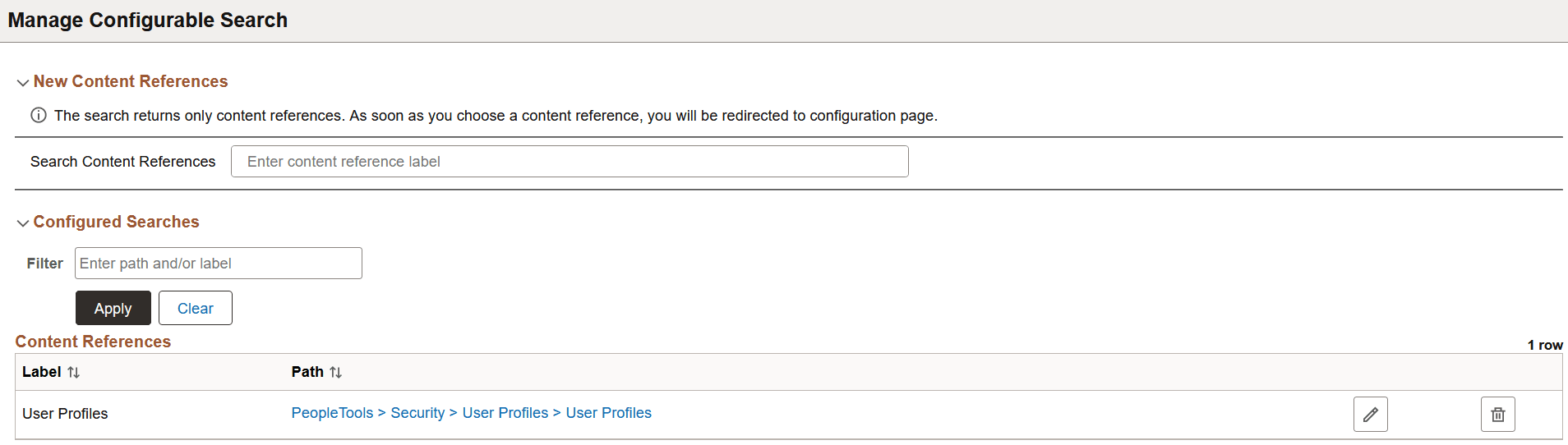

Use the Manage Configurable Search page to list configured content references, to add a new configuration, and to review, edit, or delete an existing configuration.
Access the Manage Configurable Search page by selecting PeopleTools > Utilities > Manage Configurable Search.
Note: Manage Configurable Search page requires the PTPORTALREGISTRY search definition, so you must ensure that the search definition is deployed and indexed.
This example illustrates the Manage Configurable Search page. Descriptions of the fields appear after the example.
New Content References
The New Content References section enables you to search for content references that you want to configure for configurable search. When you select a content reference, the Search Configuration page displays the details of the selected content reference if the following conditions are met:
  • Add, or Update/Display, or both action modes are enabled on the Use tab of the Component Properties dialog box in Application Designer.
  • Search record contains search keys.
See Setting Component Properties.
If any of these conditions are not met, the system does not display the Search Configuration page, but displays the following error message: Search and Add modes are not enabled for component, cannot configure the content reference.
Configured Searches
The Configured Searches section lists the content references that have been configured for configurable search. You may edit the configuration or delete the configuration. The list of configured content references could be quite long, so you can use the filter option to identify the content reference you require.

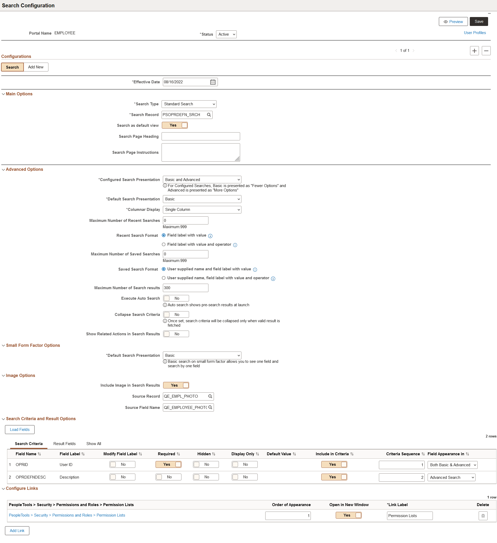

Use the Search Configuration page to configure a search page and specify how the configured search page should appear for an end user to interact with when accessing the component.
Note: In the case of a component having multiple content references, the entered value is not applicable to other content references of the same component.
Access the Search Configuration page by selecting PeopleTools > Utilities > Manage Configurable Search and then selecting the content reference for which you want to configure a search page.
This example illustrates the Search Configuration page. Descriptions of the fields appear after the example.
Field or Control
Description
Status
If you select Active, the search configuration is applied to the content reference and the configured search page is displayed based on conditions, which are described in the guidelines topic. See Guidelines on Using Configurable Search for Classic Components and Guidelines on Using Configurable Search for Fluid Components.
If you select Inactive, the search configuration is not applied to the content reference and the system displays the search page specified in the component.
Preview
Use the Preview button to view the configured search page. It opens a new window to display the newly configured search page.
In the case of multiple effective-dated configurations for a content reference, selecting the Preview button displays the current effective-dated configuration.
Effective Date
PeopleSoft's effective-dating logic enables you to configure an effective-dated configuration for a future date. You can configure multiple effective-dated configurations for a content reference and use the effective-dating logic to enable the configuration on a future date. For example, you could configure two configurations for a content reference. While one configuration is based on keyword search and is set for a future date, the other configuration can be based on standard search and set for current effective date. Or you could set any of the configurable options and specify a future date for the configuration.
Use the plus sign (+) to create a new search configuration for the content reference to which you can apply effective-dating logic.
See Using Effective Dates.

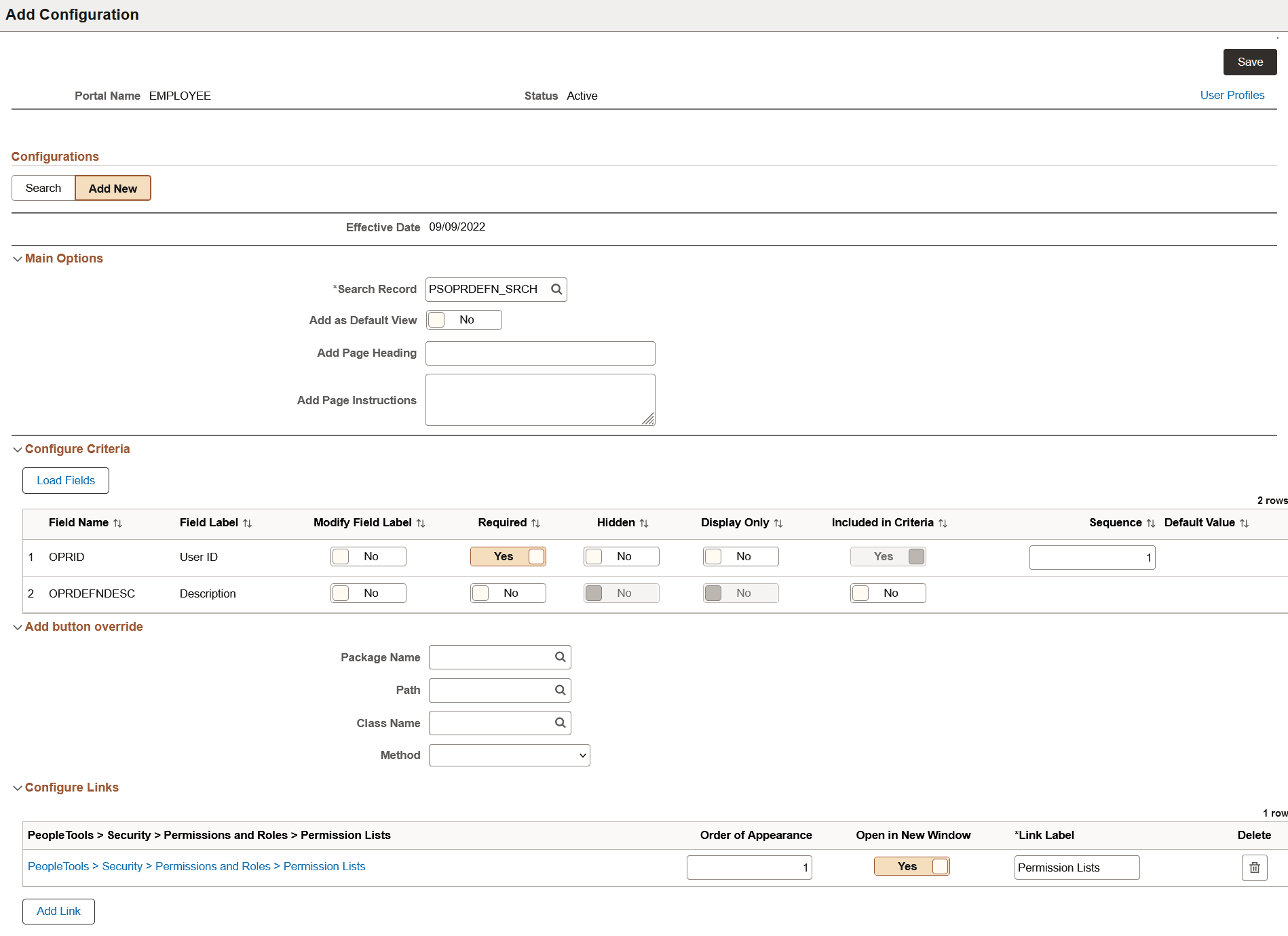

Search or Add New
The Search Configuration page displays the Search or Add New, or both tabs based on the configuration of the selected component. That is, if the Update/Display action mode is selected on the Component Properties page, the Search tab appears and if the Add action mode is selected, the Add New tab appears.
While the Search tab displays the Search Configuration page, the Add New tab displays the Add Configuration page. Search is the default tab.
Main Options
Field or Control
Description
Search Type
The system displays the search type configured for the component.
The following options are available:
  • Keyword Search: Uses a search definition to perform a search.
  • Standard Search: Uses a search record to perform a search.
If you select a content reference that has a component mapped to a search definition and real-time indexing is enabled, then the default search type is Keyword Search. However, you can change the search type to Standard Search and specify a search record for it.
Search Record or Search Definition
The Search Record or Search Definition field appears based on the search type.
The Search Record field displays the search record specified on the Component Properties page. However, you may specify a different search record for the content reference. In this case, the search record specified on the Search Configuration page is used when a user accesses this content reference provided the status of this configuration is set to active. If the status is set to inactive, the search record specified on the Component Properties page is used.
The Search Definition field displays the search definition mapped to the component. Similarly, if a search definition mapped to a component is enabled for real-time indexing, this field displays the search definition, which is enabled for real-time indexing. If a search definition is not mapped to a component, the field is blank.
You may specify a different search definition for the content reference, but you should ensure that the search definition is mapped to the component. If you select an unmapped search definition, the following error message displays: Search definition is not mapped to component.
See Mapping Components to Search Definitions.
Search as default view
Use this option to specify whether search should be the default view. If you set Yes, search will be the default view and Add as the default view is automatically set to No.
When a component is configured for Search and Add action modes, you can set only one action mode as the default view.
Search Page Heading
Specify a heading that will appear at the top of the search page. The heading should not exceed 100 characters.
If you do not specify a page heading, the page displays the default heading, Find an Existing Value.
Search Page Instructions
Enter instructions for an end-user, for example information on how to complete the process.
Advanced Options
Field or Control
Description
Configured Search Presentation
Valid values for search lookup type:
  • Advanced
  • Basic
  • Basic and Advanced
Default search lookup type is Basic and Advanced.
For descriptions of search lookup types, see Understanding Search Pages.
Default Search Presentation
This field appears when you select the Basic and Advanced option in the Configured Search Presentation field.
Valid values for default search presentation:
  • Advanced
  • Basic
See Understanding Search Pages.
Columnar Display
Specify whether search criteria should be displayed as a single or double column.
Maximum Number of Recent Searches
This field displays the value specified on the PeopleTools Options page.
However, you may specify the number of recent searches that should appear in the Recent Search Display area. Valid values are 0 to 999.
The value entered here is applicable to the selected component and overrides the system-wide configurable search property.
Recent Search Format
Select a display option for the recent search:
  • Field label with value - Displays the name of the field and the value entered in the field.
  • Field label with value and operator - Displays the name of the field along with the value entered in the field and the search operator.
Maximum Number of Saved Searches
However, you may specify the number of saved searches that should appear in the Saved Searches area. Valid values are 0 to 999.
Saved Search Format
Select a display option for a saved search:
  • User supplied name and field label with value - Displays the name of the saved search along with field name and value entered in the field.
  • User supplied name, field label with value and operator - Displays the name of the saved search and field name and the value entered in the field along with the search operator.
Maximum Number of Search Results
The recommended values for keyword search and standard search are 50 and 100, respectively.
Specify the maximum number of search results to display. The value entered here is applicable to the selected component content reference and overrides the system-wide configurable search property.
Execute Auto Search
Select Yes to display pre-search results based on the most recent search criteria.
For initial auto search results, default search criteria is used. Subsequently, the most recent search criteria is used.
Collapse Search Criteria (applicable when the Search Type is set to Standard Search)
Select Yes to collapse the search criteria fields. However, search criteria is collapsed after search results are fetched.
Collapse Search Criteria after results displayed (applicable when the Search Type is set to Keyword Search)
Select to collapse the search criteria fields after search results are displayed.
Show Related Actions in Search Results
By default, related actions are not displayed in search results even if related actions are configured for the component. To display related actions, you should ensure that related actions are configured for the component and set this field to Yes.
Small Form Factor Options
Field or Control
Description
Specify the default lookup search for small form factor devices.
Image Options
Field or Control
Description
Include Image in Search Results
Specify whether to display an image with the search results.
When you select Yes, two fields are displayed to provide the record and field information.
Source Record
The source record keys should be keys in the search record.
Source Field Name
Select a field of the record.
Search Criteria and Result Options
Select the Load Fields button to display the fields of the configured search record (standard search) or attributes of the configured search definition (keyword search).
The Search Criteria tab enables you to configure the appearance of fields or attributes and the sequence in which they should appear on the search page.
Field or Control
Description
Field Name or Attribute Name
Lists the fields of the configured search record for standard search or the attributes of the configured search definition for keyword search.
Field Label or Attribute Label
Lists the labels of the fields or attributes.
Modify Field Label or Modify Attribute Label
Set this option to Yes, which enables you to edit the field or attribute label.
Required
Specify whether the field or attribute should be marked as a required field on the search page.
The Required button for a corresponding record field is not enabled if the Required check box (on the Edits tab) and the Search Edit check box (on the Use tab) are selected in the Record Field Properties page in Application Designer.
However, the Required button is enabled if the Required check box or the Search Edit check box is not selected in the Record Field Properties page.
If you select the Required button, the Include in Criteria button is automatically selected if it was not previously selected. If you deselect the Required button, the Include in Criteria button is not automatically deselected.
Hidden
Specify whether the field or attribute should be hidden on the search page.
You can set a field or attribute as hidden if the field or attributes has a default value associated with it.
Display Only
Specify whether the field or attribute should be display only.
You can set a field or attribute as display only if the field or attribute has a default value associated with it.
Default Value
Lists the default value for a field or attribute if configured.
Include in Criteria
Specify whether the field or attribute should be used as search criteria on the search page.
The Include in Criteria button corresponding to a record field is not enabled if the Required check box (on the Edits tab) and the Search Edit check box (on the Use tab) are selected in the Record Field Properties page in Application Designer.
However, the Include in Criteria button is enabled if the Required or the Search Edit check box is not selected in the Record Field Properties page.
If you deselect the Include in Criteria button, the Required button is automatically deselected if it was previously selected.
Criteria Sequence
Specify the sequence in which the fields or attributes should be displayed on the search page.
A field or attribute with the lowest numeric value is displayed at the top.
Field Appearance in or Attribute Appearance in
Specify the search presentation for each field or attribute.
For standard search, the default search presentation is Basic and Advanced.
Note: For Keyword Search, this field is only available when the Configured Search Presentation is set to Advanced.
The Result Fields tab enables you to configure the appearance of fields or attributes and the sequence in which they should appear on the search results page.
Field or Control
Description
Include in Results
Specify whether the field or attribute should be displayed in search results.
Include in Small FF
Specify whether the field or attribute should be displayed in search results on small form factor devices.
Results Sequence
Specify the order in which the fields or attributes should appear on search results.
The field or attribute with the lowest numeric value appears from left to right.
The Show All tab displays a combined list of configurable fields from the Search Criteria and Result Fields tabs.
Configure Links
Select the Add Link button to launch the Configure a link dialog where you can specify a content reference that will appear on the search page. This functionality enables you to provide links to other components that are relevant to the current component or the next task a user needs to perform.
Field or Control
Description
Order of Appearance
Specify the sequence in which the configured links should appear when you configure multiple links on the search page.
Open in New Window
Specify whether the configured content reference should appear in a new window. If you select No, the content reference opens in the current window.
Link Label
Enter the label for the content reference.
After completing the configuration, save the changes. Use the Preview button to preview the new page, which opens a new window to display the newly configured page.
Use the Add Configuration page to configure a page to add a new value to the PeopleSoft table and specify how the page should appear for an end user.
Click Add New on the Search Configuration page.
This example illustrates the Add Configuration page. Descriptions of the fields appear after the example.
Field or Control
Description
Status
The status specified on the Search Configuration page is extended to the Add Configuration page. Therefore, you cannot set or edit the status on this page.
Main Options
Field or Control
Description
Search Record
If the search record does not contain a key or keys, the Load Fields button is disabled. Choosing a search record that contains a key or keys enables the Load Fields button.
For descriptions of the fields in the Configure Criteria and Configure Links areas, which are similar to the Search Configuration page, see Configuring a Search Page.
Configure Criteria
The Configure Criteria group box enables you to configure the appearance of fields or attributes and the sequence in which they should appear on the Add a New Value page.
Field or Control
Description
Field Name
Field Label
Displays the labels of the fields or attributes.
Modify Field Label
Required
Specify whether the field or attribute should be marked as a required field on the Add a New Value page.
The Required button for a corresponding record field is not enabled if the Required check box (on the Edits tab) and the Search Key are selected in the Record Field Properties page in Application Designer.
However, the Required button is enabled if the Required check box or the Search Key is not selected in the Record Field Properties page.
Hidden
Specify whether the field or attribute should be hidden on the Add a New Value page.
You can set a field or attribute as hidden only if the field or attribute has a default value associated with it.
Display Only
Include in Criteria
Specify whether the field or attribute should be used as search criteria on the Add a New Value page.
The Include in Criteria button corresponding to a record field is not enabled if the Required check box (on the Edits tab) and the Search Key check box (on the Use tab) are selected in the Record Field Properties page in Application Designer.
However, the Include in Criteria button is enabled if the Required check box or the Search Key check box is not selected in the Record Field Properties page.
Sequence
Specify the sequence in which the fields or attributes should be displayed on the Add a New Value page.
Default Value
Add Button Override
Use the Add button override area to override the behavior of the Add button. Specify an application class or method for the target component where you want to redirect the user when they select the Add button.
Field or Control
Description
Package Name
Specify the root package where the application class is created.
Path
Specify the path, represented by a colon (:).
Class Name
Choose the relevant application class.
Method
Specify the method to be invoked.
Configure Links
Select the Add Link button to launch the Configure a link dialog where you can specify a content reference that will appear on the Add a New Value page. This functionality enables you to provide links to other components that are relevant to the current component or the next task a user needs to perform.
Field or Control
Description
Order of Appearance
Open in New Window
Link Label
