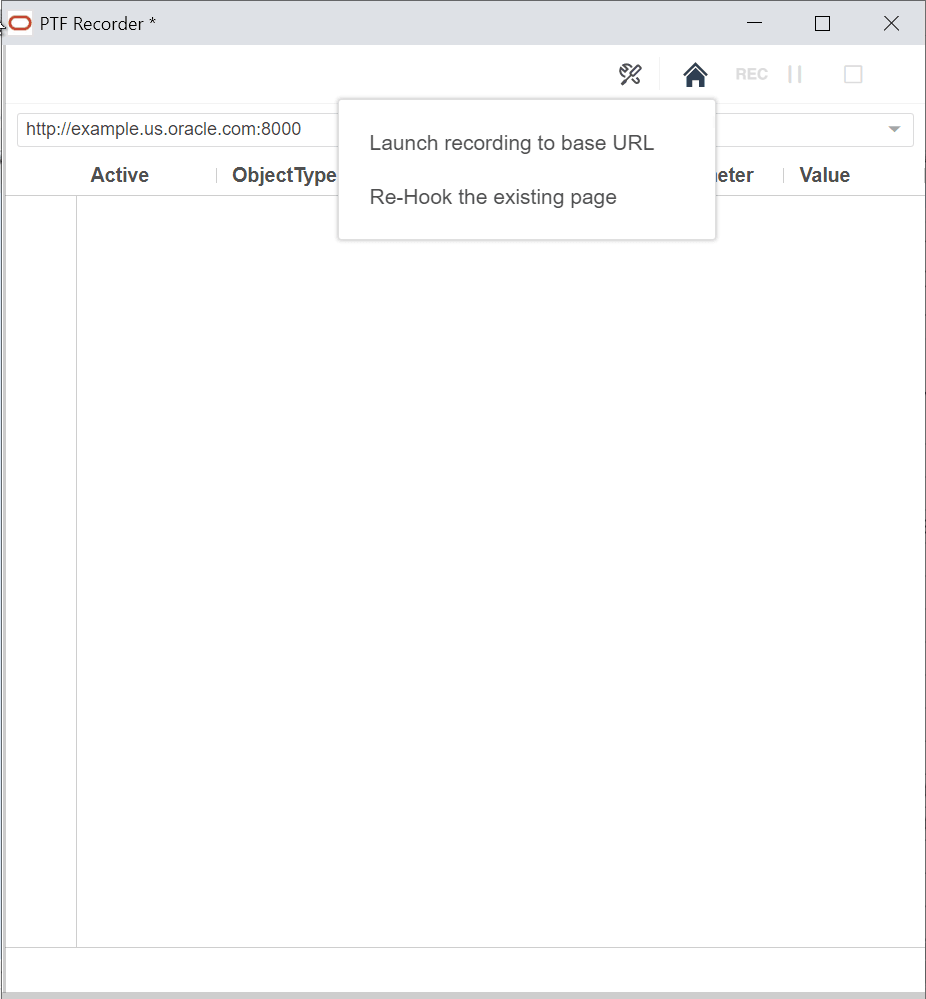

Re-Hooking an Existing Page
After recording few steps in a PIA page, you may want to record again from the point where you stopped or you may want to navigate to a certain page and then record from that page.
When user stops recording, the recorded steps gets processed and is available in the PTF client, without closing the PTF recorder and the PIA page.
You can record new steps by re-hooking the already opened PIA page, provided that the PIA page is still active, or the base URL page depending on the option selected.
To re-hook to an existing PIA page, ensure that you do not manually close the PTF Recorder and the PIA page.
This example shows the option to re-hook an existing page
                On the PTF Recorder, click the Start web client icon, and select the Re-Hook the existing page option.
When you re-hook, the browser becomes active and you can start recording. The recorded step appends to the unsaved test script.
Note: Re-hook works on the most recently opened or used PIA page instance by the PTF Recorder.

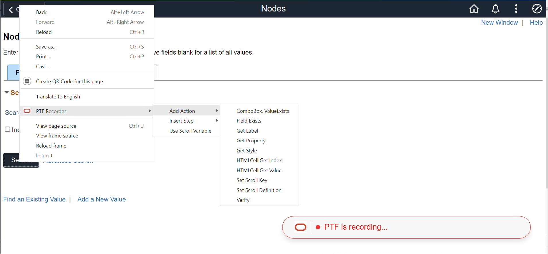

You can add actions directly on the page elements on the PeopleSoft Application pages.
You can select and add an action on a page element from the Add Action options.
            To add actions:
Right-click on the page element.
Select PTF Recorder, Add Action, then select an action.
This list describes the action options:

                                 ComboBox.ValueExists  |
                                 Adds a ComboBox.ValueExists step. You are prompted to select the value, and the variable to store the return value, and to select an expected value. Valid values are True, False, or Ignore.  |
                                 Field Exists  |
                                 Adds an Exists step. You are prompted to enter a variable name or select an existing variable and to select an expected value. Valid values are True, False, or Ignore. See Exists.  |
                                 Get Label  |
                                 Adds a GetLabel step. You are prompted for the return variable that will contain the label. See GetLabel  |
                                 Get Property  |
                                 Adds a GetProperty step. You are prompted with a list of properties for the selected page element. Enter a variable name or select an existing variable name for one or more properties. The recorder adds a GetProperty step for each property you identify. See Get_Property.  |
                                 Get Style  |
                                 Adds a GetStyle step. You are prompted with a list of style definitions for the selected page element. Enter a variable name or select an existing variable name for one or more style definitions. The recorder adds a GetStyle step for each style you identify.  |
                                 HTMLCell Get Index  |
                                 Returns the index value for an HTML table cell. You are prompted for the return variable that will contain the HTML index. See CellGetIndex  |
                                 HTMLCell Get Value  |
                                 Returns the value for an HTML table cell. You are prompted for the return variable that will contain the HTML cell value. See CellGetValue  |
                                 Set Scroll Key  |
                                 Adds a Scroll.Key_Set step. Enter a Scroll ID in the Step Modification area and click the Confirm icon.  |
                                 Set Scroll Definition  |
                                 The Step:Scroll Definition dialog box appears where you can select the definition type and other details. See Scroll.  |
                                 Verify  |
                                 Adds a Verify step. The step is automatically populated with the object ID and value of the field. See Verify.  |
Note: Chrome and Microsoft Edge-based PTF recorders allow recording of right-click, save as action on a link.
For details on SaveTargetAs action, see SaveTargetAs

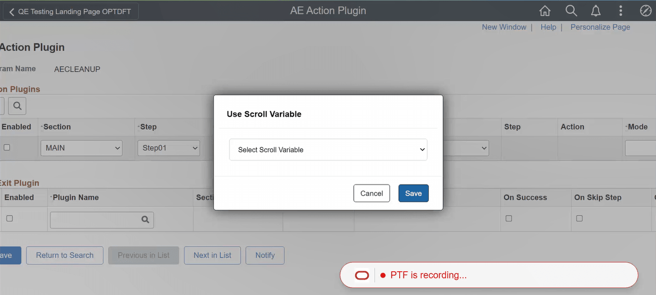

You can add scroll variables on PeopleSoft application pages.
Use scroll variable in conjunction with action or steps that utilize variables.
To add:
Right-click on the PIA page.
Select PTF Test Recorder, Use Scroll Variable.
On the PIA page, the Use Scroll Variable pop-up page appears where you can select the scroll variable.
This example shows the Use Scroll Variable pop-up page.
