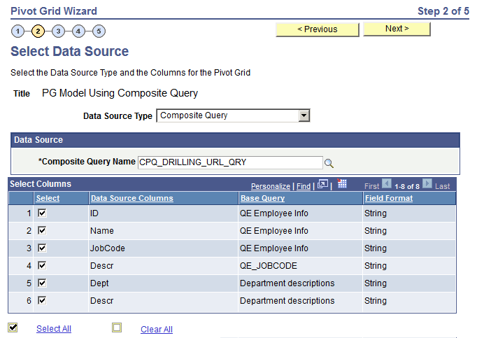

Use the Select Data Source (PTPG_WIZ_DATASRC) page to select the data source and output columns.
In the Select Data Source page, select the Composite Query option from the Data Source Type drop-down list.
This example illustrates the fields and controls on the Select Data Source page with the Data Source Type set to Composite Query. Definitions for the fields and controls appear following the example.
Field or Control
Description
Composite Query Name
This field is available if the Data Source Type is set to Composite Query.
Click the search icon to select a composite query from the list of existing composite queries.
Note: Only one composite query can be associated with one Pivot Grid model as a data source.
Select Columns
Select the output columns to be plotted in the Pivot Grid model.
Note: The Select Columns region is available after you select an existing composite query in the Composite Query Name field using the search icon or after you enter a valid query name and tab out of the Composite Query Name field.
You must select at least two data source columns.
Base Query
This column displays the descriptions of the underlying base query that correspond to each field in the Data Source Columns column.
If the base query has no description, the system displays the name of the base query.
Next
Click this button to advance the wizard to the next page.
Note: The Next button is available after you select at least two columns in the Select Columns region.
