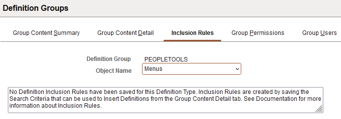

This example illustrates the fields and controls on the Inclusion Rules page for a definition object for which no inclusion rules have been defined. You can find definitions for the fields and controls later on this page
The previous example shows the Inclusion Rules page when no inclusion rules have been defined for an object name (definition type).

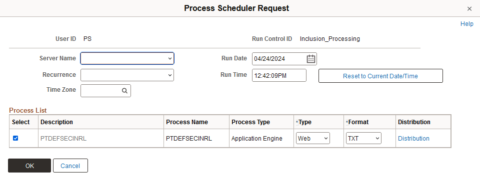

Use the Process Scheduler Request page (PRCSRQSTDLG) to initiate definition security inclusion rule processing.
To access the page select and click the Run button.
This example illustrates the fields and controls on the Process Scheduler Request page.
The system auto-populates the Process List grid with the PeopleSoft-delivered application engine program, PTDEFSECINRL, used for all inclusion rule processing.
Information about the fields and controls that appear on this page are documented elsewhere in the product documentation. See Scheduling Process Requests.
