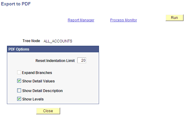

This example illustrates the fields and controls on the Export to PDF page. Definitions for the fields and controls appear following the example.
Field or Control |
Description |
Tree Node |
Displays the name of the node that you selected to export to a PDF file. Note: This node and all its descendants will be exported to a PDF file. |
Reset Indentation Limit |
Indicates the visual position of tree objects in the PDF file. Tree objects will be positioned at the beginning of the page if set at a position beyond the reset indentation limit. |
Expand Branches |
Select to export the tree with branches expanded. If you do not have access to the branch, it will not be expanded. |
Show Detail values |
Select to export the tree with detail values. |
Show Detail Descriptions |
Select to export the tree with detail value descriptions. |
Show Levels |
Select to export the tree with level information of the tree shown. |
Note: The Expand Branches, Show Detail Values, Show Detail Descriptions, and Show Levels options are not active for Query Access trees.
