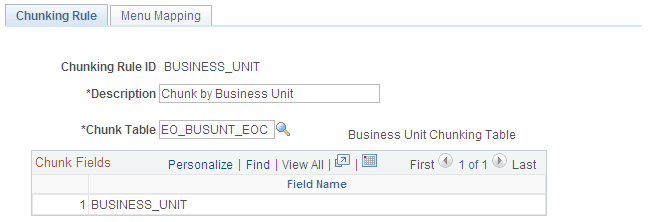

Use the Chunking Rule page (EO_CHUNKRULE) to define the chunking rule description.
Navigation:
This example illustrates the fields and controls on the Chunking Rule page. You can find definitions for the fields and controls later on this page.
In message chunking, all data within the message contains the same break field. For example, if the break field is business unit, all transactions in the message are for the same business unit.

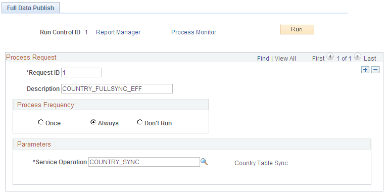

Use the Full Data Publish page (EO_FULLDATAPUB) to create the run control for the Full Data Publish utility.
The run control associates publish rule definitions with the scheduled Full Publish process run. For example, you can set up a run control to publish both customer and sales order full messages at the end of each day.
Navigation:
This example illustrates the fields and controls on the Full Data Publish page. You can find definitions for the fields and controls later on this page.
Use this page to create the run control for the Full Data Publish utility.
Field or Control |
Description |
Request ID |
Enter request IDs to group the Description, Process Frequency, and Message Name parameters under one unique process request. A single run control ID can encompass multiple request IDs. |
Parameters |
Select the name of the message to publish. |
The PeopleSoft system adds a run control for the currently effective FullSync message that is chunked by the setID CUSTOMER_FULLSYNC_EFF_SETID.
Note: If you insert a new row, the same run control component can publish more than one message, so you can produce both the full message and the current effective-dated full message from the same PeopleSoft Process Scheduler run.
Note: You must set up the run control parameters to start the Full Data Publish program.

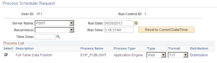

Performing Full Table Replication
Access the Full Data Publish page ().
Click the Run button on the Full Data Publish (EO_FULLDATAPUB) page to access and select the Full Table Data Publish check box and perform a full table replication.
This example illustrates the fields and controls on the Process Scheduler Request page showing the Full Table Data Publish option. You can find definitions for the fields and controls later on this page.
