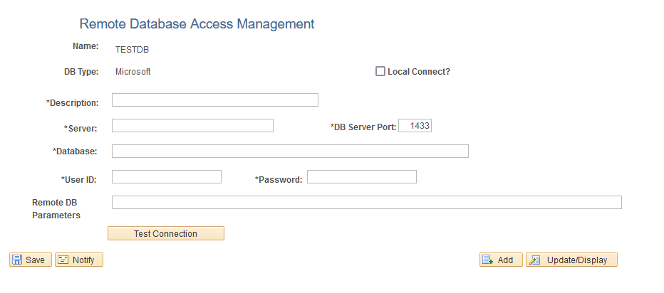

Use the Remote Database Access Management page (REMOTEDB) to define remote database connections.
Navigation:
This example illustrates the fields and controls on the Remote Database Access Management page.
Important! Different fields may appear on the page based on the database DB type.
This table illustrates the page variance by database type:
Database Type |
Required Information |
Db2 z/OS |
Enter a description, server, database, userID, and password. |
Microsoft |
Enter a description, server, database, userID, and password. Note: If the SQL Server database is set up for encrypted connections, the Remote Database Parameters field should contain the following data: encrypt=true;trustServerCertificate=false |
Oracle |
For Oracle and a Connection Type of TNSNames, enter a description, TNS Entry, user ID and password. Note: TNS Names is a preconfigured file (tnsnames.ora) with previously defined database connection information. Select a connection type of Specific if you want to set up a database that does not already have a TNS Entry defined, or when you don't want to use the TNS entry. |
All fields and definitions can be found in PeopleTools documentation. See PeopleTools Data Management, Configuring Remote Data Access, Defining Remote Database Connections.
