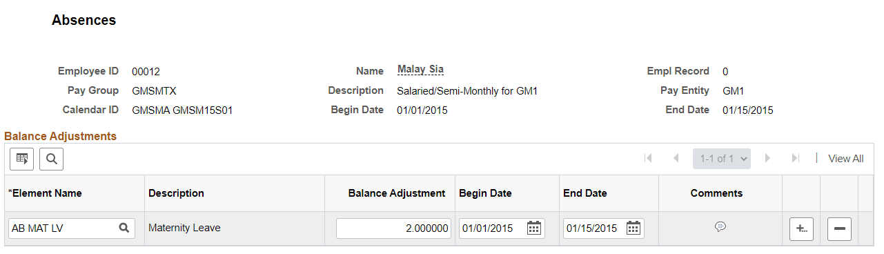

Use the Adjust Balances - Absences page (GP_PI_MNL_AE) to adjust a payee's frequency-based entitlement for a single calendar period.
Before you can enter an adjustment, you must set up the corresponding absence calendar.
Navigation:
This example illustrates the fields and controls on the Adjust Balances - Absences page.
The Absence Entitlement process follows the instructions you enter on this page.
Note: You can also enter one time adjustments to a per-absence entitlement when entering an absence event.
Note: You cannot adjust or delete entitlement elements inserted through the Leave Donations process on this page. Use the Adjust Leave Program Balances page to adjust leave donation balances.

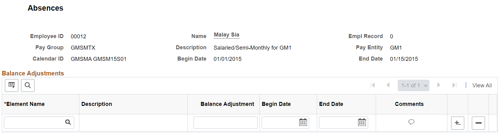

Balance Adjustments
Enter each adjustment that applies to this payee for the selected absence calendar. You cannot enter more than one adjustment for the same element.
Field or Control |
Description |
Element Name |
Select the entitlement element for which you want to enter an adjustment. The prompt table displays only frequency-based entitlement elements that are defined for positive input overrides on the Element Name page. |
Balance Adjustment |
Enter the adjustment units. You can enter a positive or negative number. The amount is added to or subtracted from the beginning entitlement balance when you run the Entitlement process. Generation control for the adjustment is ignored. |
Begin Date and End Date |
These dates determine in which segment the adjustment is made, if the calendar period is segmented.

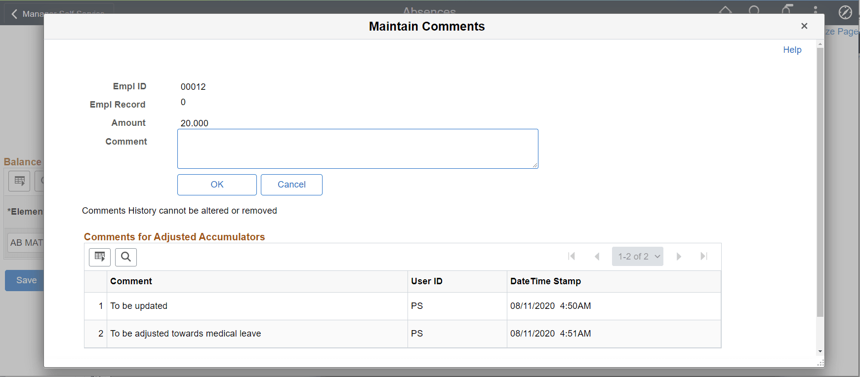

Use the Adjust Balance Comments Modal (GP_ADJ_COMABS_SCF) to enter the comments for the balance adjustments. You can manage multiple comments according to the need.
The following video provides more information on comments added to Balance Adjustments:
Video: Image Highlights, PeopleSoft HCM Update Image 36: Comments to Balance Adjustments.
This example illustrates the fields and controls on the Adjust Balance Comments Modal.
Note: You can edit comments until you save the Adjust Balances - Absences page. The comments gets saved only after saving the Adjust Balances - Absences page.

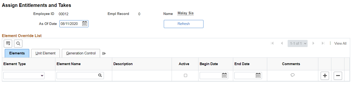

Use the Assign Entitlements and Takes page (GP_ABS_OVRD) to redefine a frequency-based entitlement rule for a payee for a specified period of time.
Specify whether a take or frequency-based entitlement element is processed for a payee.
Navigation:
This example illustrates the fields and controls on the Assign Entitlements and Takes page.
To override a per-absence entitlement rule, use the Absence Event Entry page.
Note: To override an entitlement or take element, the Payee override option must be selected on the Element Name (GP_PIN) page.
Elements
Field or Control |
Description |
Element Type |
Specify the type of element to override: Absence Entitlement or Absence Take. |
Element Name |
Select the name of the element to override. Only elements that allow payee overrides are listed; the system does not check payee eligibility. If you selected Absence Entitlement as the entry type, you can select a frequency-based entitlement element only. |
Active |
Selected by default. Clear if you don’t want the system to resolve this absence element for the payee. |
Enter the date that the override instructions become effective and the last date to which the override instructions apply. |
Select to open Assign Entitlements and Takes Comments Modal |

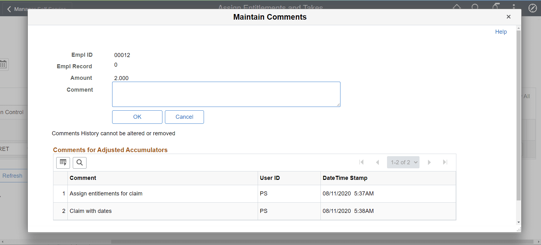

Use the Assign Entitlements and Takes Comments Modal (GP_ADJ_COMAET_SCF) to enter the comments for the element override list. You can manage multiple comments according to the need.
This example illustrates the fields and controls on the Assign Entitlements and Takes Comments Modal.
