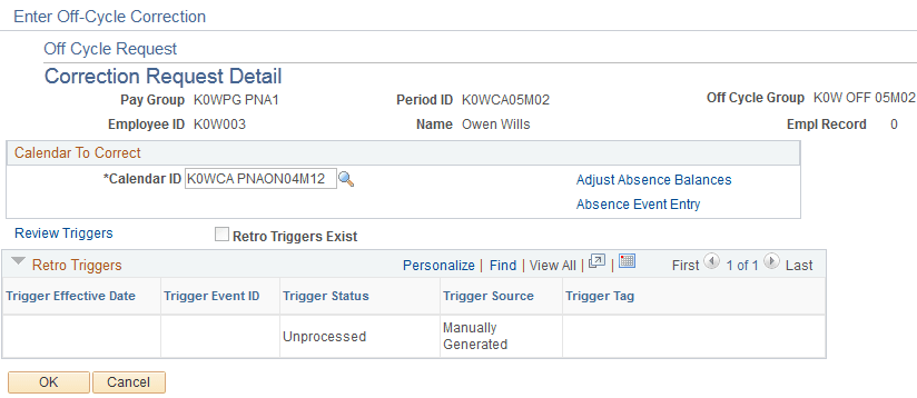

Use the Correction Request Detail page (GP_OFFCYCLE_C_SEC) to enter instructions for processing absence corrections.
Navigation:
Click Correction Details button on the Corrections - List Payees and Calendars to correct section of the Off Cycle Request page.
This example illustrates the fields and controls on the Correction Request Detail page.

Calendar ID |
Select the calendar that needs a correction made to it. |
Adjust Absence Balances |
Use this link to enter any adjustments to absence balances. |
Absence Event Entry |
Click to access the Absence Event Entry page. |
Review Triggers |
Click link to view, edit, and add retroactive triggers. |
Retro Triggers Exist (retroactive triggers exist) |
This system will select this check box if a trigger exists that falls on or before the period end date of the calendar to be corrected, and if the trigger represents the same country as the country associated with the pay group of the off cycle group. If the check box is cleared, you must manually create the trigger or make the correction to data that will cause the trigger to be generated. |
Retro Triggers |
Displays a list of retro triggers associated with the same country as the correction. |
