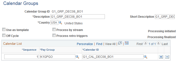

Use the Calendar Groups page (GP_CALENDAR_RUN) to define a group of calendars to process together.
Note: When accessed from the Global Payroll & Absence Mgmt, Absence and Payroll Processing, Define Calendars menu, the page name is Calendar Groups. When accessed from the Global Payroll & Absence Mgmt, Absence and Payroll Processing, Off Cycle menu, the page name is Off Cycle Calendar Group. Other than the title, the pages are the same.
Calendars are processed in the order listed.
Navigation:
This example illustrates the fields and controls on the Calendar Groups page.
Note: After processing begins for an on-cycle run, you should not edit the fields on the Calendar Groups page. To modify this page, cancel the absence run.
Field or Control |
Description |
Use as template |
Select to use this calendar group to run the online Absence Forecasting or Balance Inquiry process. This option is not available for off-cycle processing. |
Process by stream |
Select to use stream processing for this calendar group. This feature is typically not used for off-cycle processing. |
Off cycle |
Select if this calendar group is to be used for off-cycle processing. |
Process retro triggers |
Select to process retroactive triggers for this calendar group. For on-cycle processing, the default value is based on the Process Retro Triggers field on the Run Types page. If any run type indicates that retroactive triggers should be processed, the default is to select this option. For off-cycle processing, you must select this check box if any of the off-cycle groups that you add to this calendar group include correction transactions. |
Calendar List
List the calendars to process together. The number that you enter in the Sequence field determines the calendar processing order. This grid is hidden when you select the Off cycle check box.

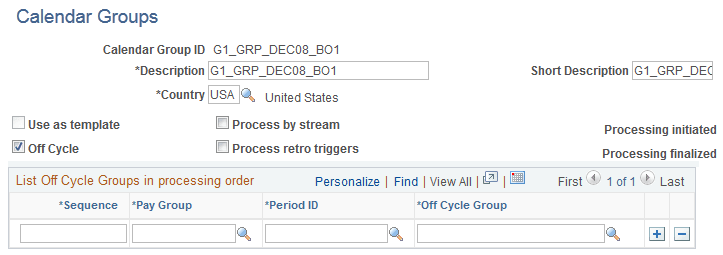

List off-cycle groups in processing order
The following grid appears only when you select the Off cycle check box. List the off-cycle groups to process. An off-cycle group identifies the off-cycle transactions to be processed for a specific pay group and period.
This example illustrates the fields and controls on the Calendar Groups page when entering values for off-cycle groups.
