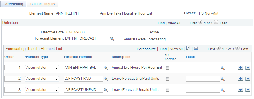

Use the Forecasting page (GP_ABS_TAKE6) to specify which forecasting result elements to display in the Forecasting Results grid.
Also specify whether to display a customized label from the HR Text Catalog as the description or the element description as defined on the Element Name page (GP_PIN).
Navigation:
This example illustrates the fields and controls on the Forecasting page.
This page displays the forecasting rules defined for a Take element on the Absence Take - Forecasting page. The Forecast Element field at the top of the page shows the formula that the system resolves during the Forecasting process. The Forecasting Results Element List grid shows what appears on the Absence Forecast Results page (in the Absence Event Entry component) after you run the Forecasting process. You can have all or a subset of these results display to self service users after they run the forecasting process.
Note: To enter information on this page, the Allow Forecasting check box must be selected on the Forecasting Messages page, as well as the Forecasting Used check box on the Absence Take definition page.
Field or Control |
Description |
Self Service |
Select to have the forecasting results for this element display to self service users. |
Label |
Specify the label for the Forecast element that displays in self service. If no label is specified, it will display the element's description. |

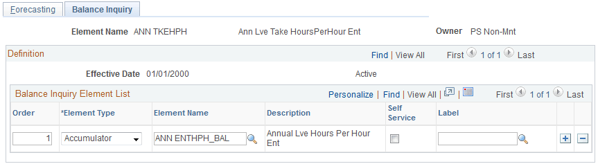

Use the Balance Inquiry page (GP_ABS_TAKE7) to specify which entitlement balances the Balance Inquiry process is to display and whether to display a customized label from the HR Text Catalog as the description or the element description as defined on the Element Name page (GP_PIN).
Navigation:
This example illustrates the fields and controls on the Balance Inquiry page.
This page is similar in function to the Forecasting page but applies to rules for the Balance Inquiry process.
