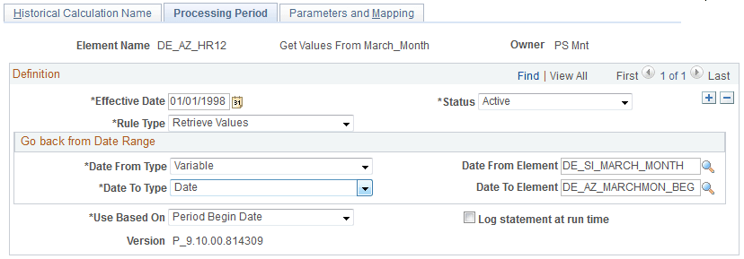

Use the Processing Period page (GP_HIST_RULE1) to define the details of the processing period for the historical rule.
Depending on what you select as the rule type, some fields may not be available for entry.
Navigation:
This example illustrates the fields and controls on the Processing Period page.
Note: On the Processing Period page, you create the periods from the date from to the date to date. You then map the selected result data to the processing periods. If no data exists for an element in a period, it is set to spaces for character and date elements and to zeros for numeric and monetary elements.
Field or Control |
Description |
Rule Type |
Select the type of historical rule from these options: Use in Fictitious Calculation: This is not used with Absence Management. Retrieve Values: Select when you want to use a historical rule element in a formula to retrieve previously calculated values. |
Go back from Date Range |
Define the date from, date to type, date from element, and date to element to establish the rule's date range. If you select a Retrieve Values rule type, this field appears as Go Back From Date Range. Select from the following values in the Date From Type and Date To Type fields: Bracket Cal Date (calendar date) Enter a date instead of an element that resolves to a date. In the next field, specify the date to start going back from. Date Formula SystemElem (system element) Variable |
Use Based On |
Select a date that tells the system which data values from the GP_RSLT tables are processed by a historical rule. Select from these values: Period End Date, Period Begin Date or Payment Date. |
Log statement at run time |
Select this check box to see the text of the SQL statement dynamically generated by the array module during batch processing. You can direct the output display into a file by selecting the Redirect Output option in PeopleTools Configuration Manager. |
Example
You want to determine three months of salary (element SALARY) for the period between March 28 and June 27. This table lists the GP_RSLT table values:
Period Payment Date |
Result |
Period Begin |
Period End Date |
Payment Date |
January 2003 |
100 |
January 1, 2003 |
January 31, 2003 |
February 2, 2003 |
February 2003 |
100 |
February 1, 2003 |
February 28, 2003 |
March 2, 2003 |
March 2003 |
100 |
March 1, 2003 |
March 31, 2003 |
April 2, 2003 |
April 2003 |
100 |
April 1, 2003 |
April 30, 2003 |
May 2, 2003 |
May 2003 |
100 |
May 1, 2003 |
May 31, 2003 |
June 2, 2003 |
June 2003 |
100 |
June 1, 2003 |
June 30, 2003 |
July 2, 2003 |
July 2003 |
100 |
July 1, 2003 |
July 31, 2003 |
August 2, 2003 |
If you select Period Begin Date, the historical rule processes only June, May, and April. It does not process July, because July 1, 2003 (the period begin date) is later than the date from date of the historical period (June 27, 2003). It also does not process March, because March 1, 2003 (the period begin date) is before the date to date of the historical period (March 28, 2003).
Note: Historical rules start from the date from date and look at periods and segments in the reverse order in which they were originally processed and go back to the date to date.
If you select Period End Date, the rule processes May, April, and March. It does not process June, because June 30, 2003 (the period end date) is later than the date from date of the historical period (June 27, 2003). It also does not process February, because February 28, 2003 (the period end date) is before the date to date of the historical period (March 28, 2003).
If you select Payment Date, the rule processes May, April, and March. It does not process June, because July 2, 2003 (the payment date) is later than the date from date of the historical period (June 27, 2003). It also does not process February, because March 2, 2003 (the payment date) is before the date to date of the historical period (March 28, 2003).

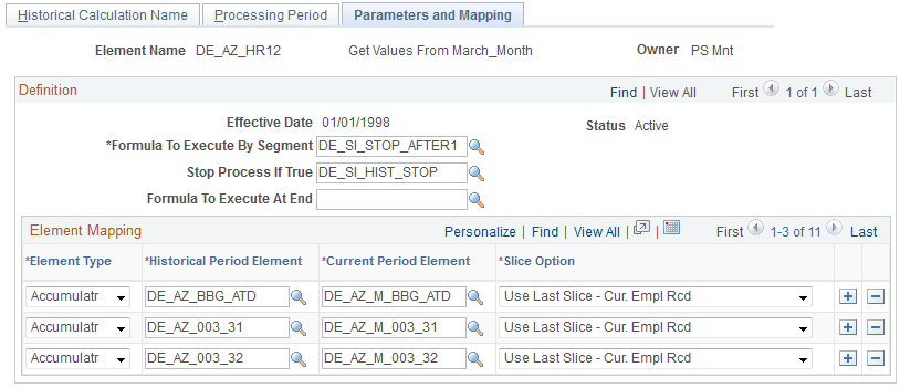

Use the Parameters and Mapping page (GP_HIST_RULE2) to define the formula for a historical rule.
Navigation:
This example illustrates the fields and controls on the Parameters and Mapping page.
When you run an absence run, the system resolves the Formula to Execute by Segment field per historical period until the Stop Process If True variable is not equal to zero or the last historical period is processed. The system then resolves the formula specified in the Formula To Execute at End field.
Field or Control |
Description |
Formula to Execute By Segment |
Enter the formula to be resolved for each segment or period. |
Stop Process If True |
Enter a variable. The process keeps looping through periods, resolving the formula for each period, until this variable doesn't equal zero, the date to date is reached, or no more data is found. |
Formula To Execute At End |
Select the formula to resolve when period processing is completed. |
Use Period If True |
This field appears for Use in Fictitious Calculation rule types only. This is not used with Absence Management. |
Element Mapping
The grid in the Element Mapping group box lists the elements for retrieval from the Absence Management result tables for a historical rule.
Field or Control |
Description |
Element Type |
Select the type of element—such as the earning, deduction, or variable—to retrieve. |
Historical Period Element |
Enter the element that you want to retrieve. |
Current Period Element |
Enter the variable in which the retrieved value is to be stored. This variable becomes available for use in the Formula to Execute By Segment field. |
Slice Option |
Specify how the system resolves multiple instances of an element in the historical period. Values are:
