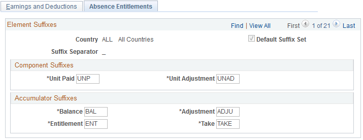

Use the Absence Entitlements page (GP_SUFFIX2) to define suffixes for absence elements in the base language that you’ve selected.
Navigation:
This example illustrates the fields and controls on the Absence Entitlements page.
Component Suffixes and Accumulator Suffixes
Field or Control |
Description |
Unit Paid and Unit Adjustment |
Define the suffixes to be appended to the components and accumulators that the system generates for absence entitlement elements. |
