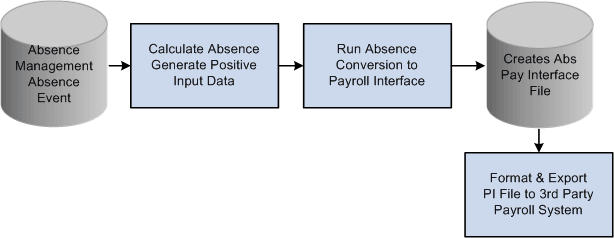

Integrating with Payroll Interface
This diagram illustrates the flow of information from Absence Management to Payroll Interface.
This topic discusses how to:

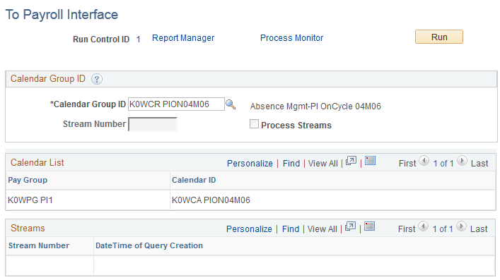

Use the To Payroll Interface File page (GP_ABS_PI_RUNCTL) to run the process that sends the generated positive input from the absence process to a new table from which Payroll Interface extracts data for use in the payroll system.
Navigation:
This example illustrates the fields and controls on the To Payroll Interface File page.
Use this page to transfer generated positive input from Absence Management to Payroll Interface. After this process is completed, the Absence Management data resides in new table, Absence Management to Payroll Interface - Output File (GP_ABS_PAY_INTF), from which Payroll Interface extracts data for use in the payroll system.
