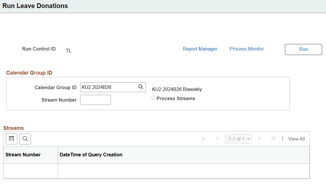

Run Leave Donations Page
GP_ABS_LVDN_RUNCTL
Run the Leave Transfer process to process all approved leave transfer requests.
Use the Run Leave Donations page (GP_ABS_LVDN_RUNCTL) to process all approved leave transfer requests.

This example illustrates the Leave Donations tile.
Select the required Calendar group to process the approved leave transfer requests for that calendar.
