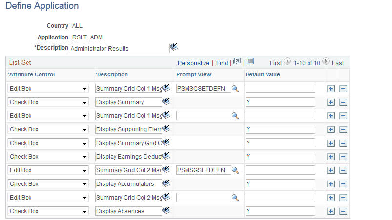

Use the Define Application page (GP_ELN_APP) to define attributes attached to a list set, an element group, or an element.
Navigation:
This example illustrates the fields and controls on the Define Application page (1 of 2).
Note: PeopleSoft delivers an application of RSLT_ADM with a country of ALL (shown in the preceding exhibit), designed to work in conjunction with the Administrator Results component. . You should not modify this delivered application. Link this delivered application with a list set of your choosing, and use it to control the appearance of the Administrator Results component.
See Defining Administrator Absence Results.
See Viewing Administrator Absence Results.

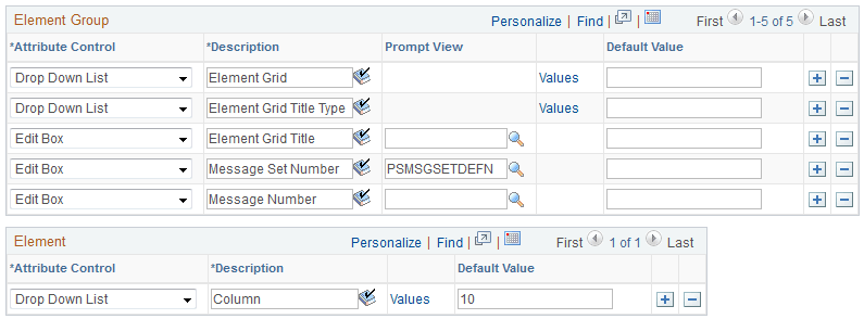

There is no minimum number of attributes required for each level (represented by the three group boxes). An application definition can be created without specifying attributes. This may be done for applications for which you intend to use the list set solely to group multiple element groups. There is a maximum of ten attributes for each level.
Attributes defined at the list set level apply to all of the element lists in the set.
Field or Control |
Description |
Attribute Control |
Specify how to display the attribute on the Define List Set page. Options are: Check Box: This attribute is displayed as a check box. Drop Down List: This attribute is a character field that only accepts input from a list of values that you can create on the Define Values for Attribute page. Edit Box: This attribute is a character field that accepts any character value. Translate: This attribute is a character field that only accepts input from a prompt list of translate values. |
Description |
Enter the field label name to appear on the List Set Definition page. |
Prompt View |
Select a record from which to create a prompt table. The input will be validated against this table. This field is available only if the Attribute Control is Edit Box. Important! This is straight prompting on the record specified. There is no additional security utilized nor any relationship prompting (for example, using SetID logic, and so on). |
Values |
Select this link to record the available values on the Define Values for Attribute page. This field is available only if the Attribute Control is Drop Down List. |
Field Name |
Enter an element that contains translate values. The system presents these translate values in a drop down list on the Define List Set page. This field is available only if the Attribute Type is Translate. |
Default Value |
To have the system populate a specific attribute value on the Define List Set page, enter a valid default value. The default value must be valid for the associated attribute control. |

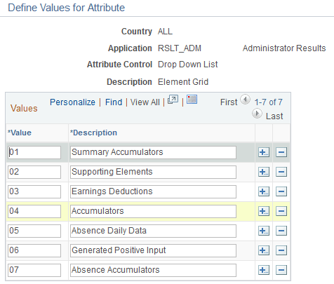

Use the Define Values for Attribute page (GP_ELN_LIST_SET) to set up the specific attribute values available for a list set, element group, or element.
Navigation:
On the Define Application page, click the Values link for attribute controls with a value of Drop Down List.
This example illustrates the fields and controls on the Define Values for Attribute page.
For attributes with an attribute control of Drop Down List, you must specify the drop down field values. The system displays these values as options on the Element Group Attributes page during list set setup. You can use any value in the Value column as a default value.
