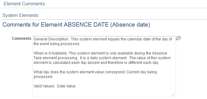

For each system-computed system element that is delivered by PeopleSoft, you can view detailed comments including a general description, when the system element is available, and where the element is used by clicking the Comments link. This is useful information when you want to learn more about how the system uses a specific system element.

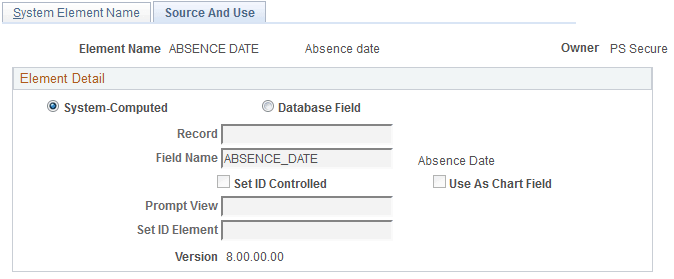

Use the Source And Use page (GP_SYSTEM_PIN) to displays whether a system element is a system-computed element or a database system element.
For a database system element, it also displays the record and field that populates it and indicates whether the field is SetID controlled.

This example illustrates the fields and controls on the Source And Use Page.
Field or Control |
Description |
Record |
Displays the record that the system element populates. |
Field Name |
Displays the field from which the system element obtains its information. |
SetID Controlled |
Selected if the field is controlled by SetID. Elements that are controlled by SetID have field name and prompt view values. |
Use As Chart Field |
This check box is not applicable to Absence Management. |
Prompt View |
Elements that are controlled by SetID have a prompt view specified. If a SetID-controlled system element is used as a supporting element override for positive input, it also requires a prompt view. |
SetID Element |
Displays the SetID field name for the system element. |
Use the Comments for Element <name> page (GP_PIN_SEC) to view detailed comments about system-computed system elements that Absence Management delivers.
Navigation:
Click the Comments link on the System Element Name page.
This example illustrates the fields and controls on the Comments for Element <name> page.
For each system-computed system element that is delivered by the PeopleSoft system, you can view detailed comments including a general description, when the system element is available, and where it is used by clicking the Comments link on the System Element Name page. This is useful information when you want to learn about what a specific system element does.
