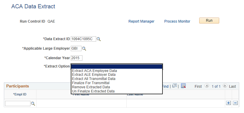

Use the ACA Data Extract page (ACA_DTEX_RUNCTL) to extract, clean up, or finalize data needed for forms transmittal.
Navigation:
This example illustrates the fields and controls on the ACA Data Extract page.
Field or Control |
Description |
Data Extract ID |
Enter the Data Extract ID that defines data to be extracted. |
Applicable Large Employer |
Select the ALE Member for the data extract. |
Calendar Year |
Enter the tax filing year. |
Extract Option |
The options available are:
Note: If an extract has already been run for an ALE/Calendar Year, the same extract ID should be used for that calendar year. Otherwise, an error message will be generated.

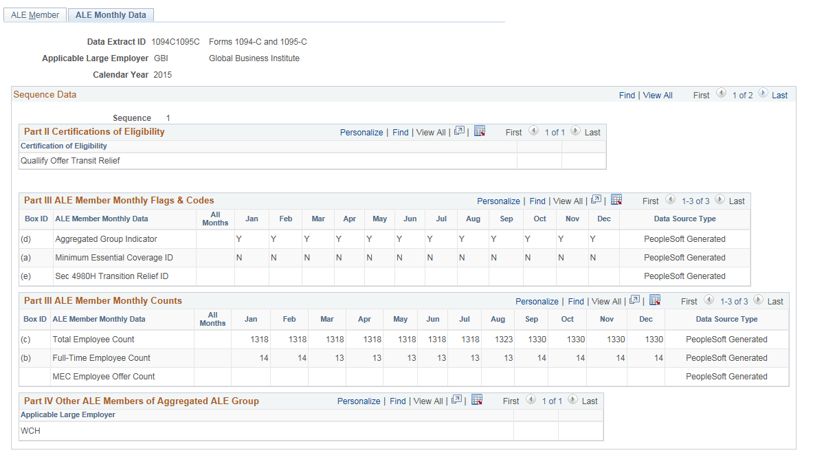

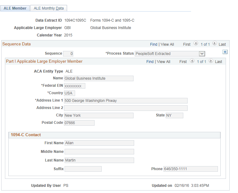

Use the ACA Employer Transmittal Data page (ACA_ALE_XMIT_PART1 and ACA_ALE_XMIT_PART2) to view or modify the employer transmittal data after the data extraction process.
Navigation:
This example illustrates the fields and controls on the ACA Employer Transmittal Data page - ALE Member tab.
Field or Control |
Description |
Process Status |
Defines the status of Data Extract, such as, PeopleSoft Extracted, User Modified, Merged with Data Load, VOID, Finalized for Transmittal, and Transmittal Created. You can add a ‘User Modified’ row to modify data before creating the 1094-C transmittal file. |
Note: Address is extracted based on the country format.
This example illustrates the fields and controls on the ACA Employer Transmittal Data page - ALE Monthly Data tab.

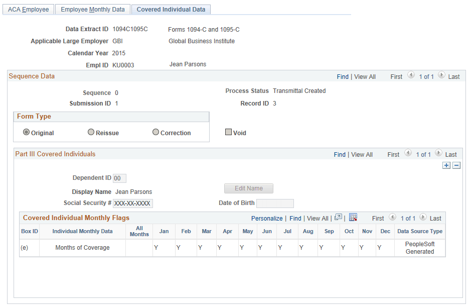

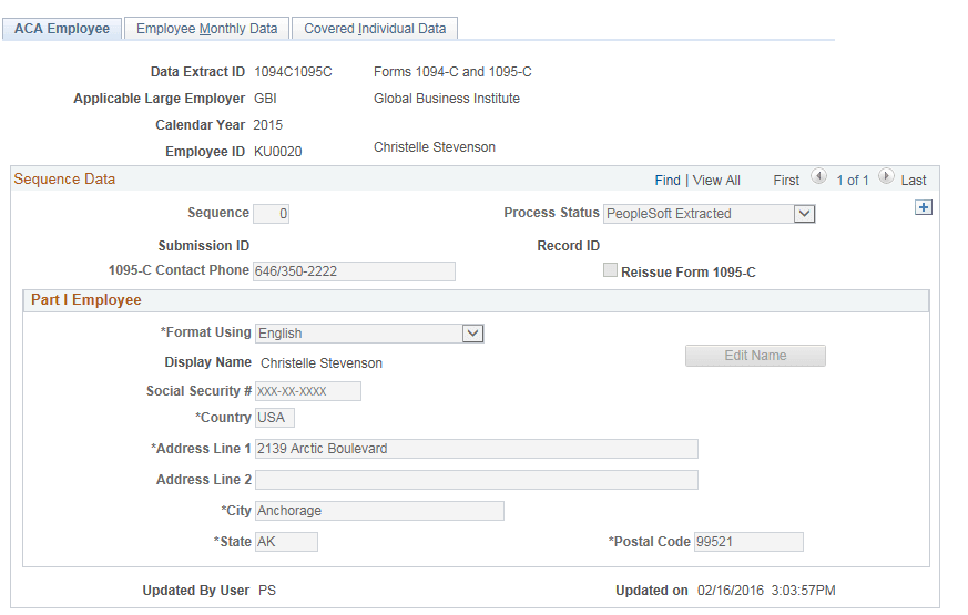

Use the ACA Employee Transmittal Data page (ACA_EMP_XMIT_PART1, ACA_EMP_XMIT_PART2 and ACA_EMP_XMIT_PART3) to view or modify the employee transmittal data after the extraction process.
Navigation:
This example illustrates the fields and controls on the ACA Employee Transmittal Data page – ACA Employee tab.
Note: Employee Address is extracted based on the address type table order (ADDR_TYPE_TBL component) that you have set up.
Field or Control |
Description |
Reissue Form 1095-C |
Between the time when Form 1095-Cs is furnished to employees but the Transmittal File has not been submitted to IRS, administrator can reissue Form 1095-C to their employees. Add a user modified row with the changes required and select the Reissue check box to indicate this data row is for issuing a reissue form. Once changes are verified, set the Process Status to Finalized for Transmittal and run the Create XML File (Reissue) process. |

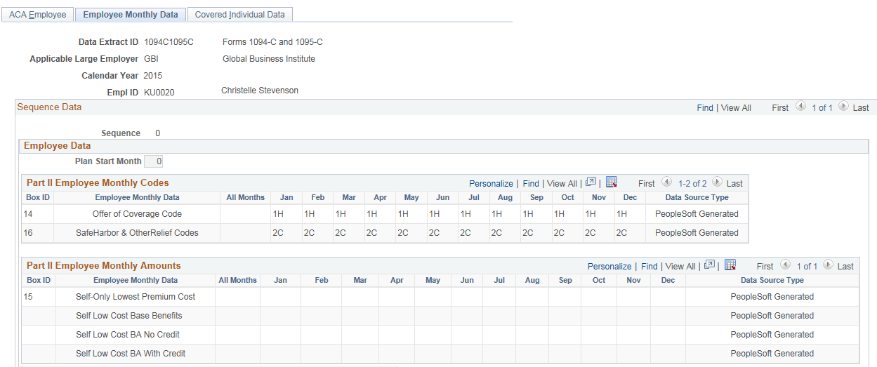

This example illustrates the fields and controls on the ACA Employee Transmittal Data – Employee Monthly Data tab.
Field or Control |
Description |
Plan Start Month |
This is an optional field for 2015. The system defaults it to ‘00’. |
Box ID 15: Employee Monthly Data |
The data from the first row Self Only Lowest Premium Cost populates the corresponding box in the Form 1095-C. The Self Low Cost Base Benefits, Self Low Cost BA No Credit and Self Low Cost BA With Credit are three working rows used to calculate cost and credits. |
This example illustrates the fields and controls on the ACA Employee Transmittal Data page – Covered Individual Data tab.

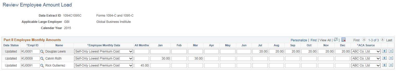

Review Employee Data Load
Review Employee Amount Load
Review Covered Individual Load

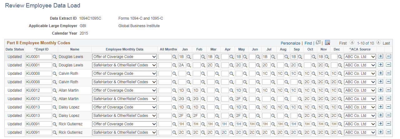

Use the Review Employee Data Load page (ACA_EMP_DATA_LOAD) to review/modify employee CI loaded monthly codes.
Navigation:
This example illustrates the fields and controls on the Review Employee Data Load page.
Field or Control |
Description |
Data Status |
Display/modify the status of the data reviewed. The options available are Error, Initial Load, Merged, Updated, Void, and Warning. |
ACA Source |
Display/modify the source of data loaded using Excel-CI Load. |
Use the Review Employee Amount Load page (ACA_EMPMDATA_LOAD) to review/modify employee share of lowest cost monthly premium for self-only minimum value coverage.
Navigation:
This example illustrates the fields and controls on the Review Employee Amount Load page.

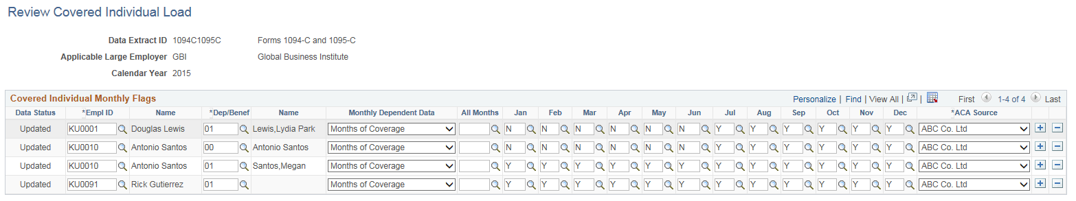

Use the Review Covered Individual Load page (ACA_DEP_DATA_LOAD) to review/modify data for employee or covered dependent enrollment to employer-sponsored self-insured health coverage.
Navigation:
This example illustrates the fields and controls on the Review Covered Individual Load page.
