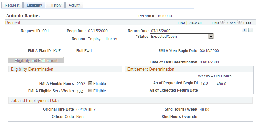

Use the Request/Authorize/Track Leave - Eligibility page (FMLA_LV_REQUEST2) to determine FMLA leave eligibility and entitlement.
Navigation:
This example illustrates the fields and controls on the Request/Authorize/Track Leave - Eligibility page. You can find definitions for the fields and controls later on this page.
Field or Control |
Description |
FMLA Plan ID (family medical leave act plan ID) |
Attach the FMLA leave request to a specific FMLA leave plan. The system uses the parameters defined for the chosen plan to calculate eligibility and entitlement values. You cannot edit the FMLA plan ID after the request has been approved, denied, completed, or canceled. If you change the FMLA plan ID when the approval status is open and the Eligibility and Entitlement process has been run, the system resets all fields associated with eligibility and entitlement to their default values and displays a warning informing you that eligibility and entitlement must be reexamined. Note: The default value for this field comes from the employee's benefit program, but you can override it here. |
Eligibility and Entitlement |
Click to start the eligibility and entitlement processes. These processes use employee job history, the FMLA plan parameters, payroll data, and data on the Request page to populate all of the other fields on the Eligibility page with the exception of the Std Hours Override (standard hours override) field. Note: The Eligibility and Entitlement button is not available if the prerequisite data for the leave request is not entered in the Request page. It is also unavailable if the request's status is completed, denied, or canceled. |
FMLA Eligible Hours |
Displays the results of the system's determination of the employee's FMLA eligible hours. The eligible hours are defined as the hours worked during the 52 weeks before the leave effective date. Depending on the rules that you've established for the associated FMLA plan, the system determines the eligible hours using either the employee's job history or Payroll data. The system selects the Eligible check box if the employee has worked enough hours to be eligible for FMLA protected leave. Note: The Eligible check boxes are indicators of the system's determination based on the FMLA Plan rules, and are informational only. They have no effect on your ability to approve or deny the request. |
FMLA Eligible Serv Weeks (family leave medical act eligible service weeks) |
Displays the results of the system's determination of the employee's FMLA-eligible service weeks. FMLA Administration determines service weeks using information from the employee's job history and the rules for the associated FMLA plan. The system selects the Eligible check box if the employee has worked enough service weeks to be eligible for FMLA-protected leave. |
As of Requested Begin Dt (as of requested begin date) |
Displays the weeks and hours of FMLA protected leave that the employee is entitled to as of the leave's begin date. To determine whether the request can be approved, compare the values displayed here to the time requested in the employee's FMLA-protected leave request. |
As of Expected Return Date |
Displays the weeks and standard hours of entitled protected leave remaining for the employee in the current FMLA year as of the leave's expected return date. This value is used only for leaves requested under plans that use a Roll-Backward calendar year. The Roll-Backward calendar is dynamic, such that a leave request using it might appear to demand denial based on an apparent lack of entitlement; however, the employee in question could gain the necessary entitlement during the course of the leave. |
Original Hire Date, Officer Code, and Stnd Hours / Week (standard hours per week) |
The Job and Employment Data group box displays basic job and employment information for the employee as of the leave effective date and the last determination of eligibility and entitlement. The system enters the average number of hours that the employee works per workweek as of the leave effective date in the Std Hours/Week field. |
Stnd Hours Override (standard hours override) |
Sometimes system-computed standard hours values are not accurate. Employees often request leave well in advance of their leave's begin date, and part-time employees' weekly hours can be variable. Enter a new value when appropriate. Note: This field does not affect eligibility or entitlement—the system uses it only to more accurately convert between the display of weeks and hours. |
