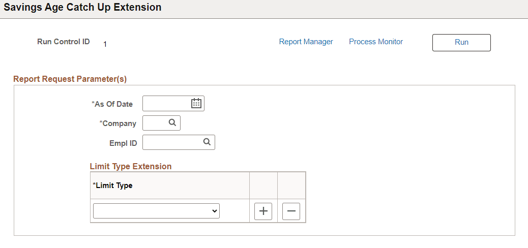

Use the Savings Age Catch Up Extension page (BN_AGE50_RUNCTL) to run the age catch up extension process for the specified limit types.
For each limit type, a single savings age catch up extension record is produced for each year for each eligible employee in PeopleSoft Payroll for North America. The process changes the extension election by default.

This example illustrates the fields and controls on the Savings Age Catch Up Extension page.

As Of Date |
Enter the last day of the calendar year for which the age catch up extension applies. |
Limit Type |
Select the limit type extension that you want to run. Delivered options are 402(g) Limit, 415(c) Limit, 415(c) Limit for 403(b) plans, and 457 Limit. You can run multiple limit types at the same time and produce age extension records for each limit type. |
