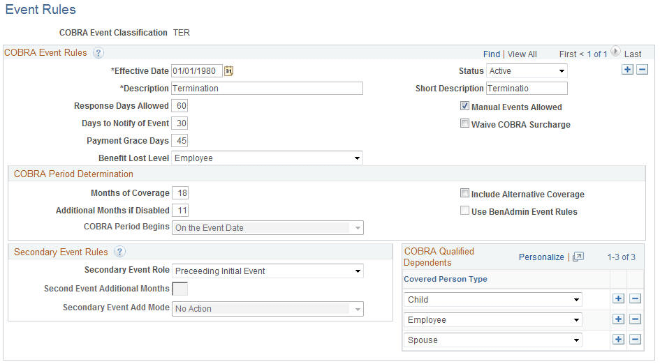

Use the Event Rules page (COBRA_EVENT_RULES1) to identify the events that result in the loss of health plan coverage for a qualified beneficiary.
Navigation:
This example illustrates the fields and controls on the Event Rules page. You can find definitions for the fields and controls later on this page.
COBRA Event Rules
Field or Control |
Description |
Effective Date |
Enter or select the date on which this COBRA event goes into effect. The system always uses the record with the effective date that is closest to but not past the current date. |
Status |
Select whether this COBRA event is Active or Inactive. |
Description |
Enter a description of the COBRA event using up to 30 characters. |
Short Description |
Enter a brief description of the COBRA event using up to 10 characters. |
Response Days Allowed |
Specifies the maximum number of days that a beneficiary has to elect coverage from the date of notification. COBRA eligibility expires after the response period. |
Days to Notify of Event |
Identifies the number of days an employee or dependent has to notify the organization following a qualifying COBRA event. |
Payment Grace Days |
Enter the number of payment grace days employees will be given to submit a payment after they send in an election. |
Manual Events Allowed |
Select if you want to allow manual entry of the event. |
Waive COBRA Surcharge |
Select if, for this event classification, you want the system to disregard the COBRA surcharge percentages defined in the Benefit Program Table. |
Benefit Lost Level |
Define whether the COBRA event affects the employee only, the dependent only, or both. Values are Employee, Dependent (a COBRA-qualified beneficiary), and neither. |
COBRA Period Determination
Field or Control |
Description |
Months of Coverage |
Identifies how long coverage will extend for a particular qualifying event. COBRA coverage generally extends for 18 or 36 months following a qualifying event. |
Additional Months if Disabled |
Enter the extension for disabled participants. Regulations allow an extension up to 11 months past the original 18 months for termination of employment and reduction in work hours events for disabled participants. |
Include Alternate Coverage |
Select to set up a grace period. |
COBRA Period Begins |
Select a value to define when COBRA coverage begins. Values are: On the Event Date: The COBRA period begin date is the same as the day of the event. COBRA coverage actually begins the day after the event date or the day after the grace period ends. On Month-Begin After Event: The COBRA begin date is on the first day of the month after the event. On PayPeriod Begin After Event: The COBRA begin date is on the first day of the pay period after the event day. |
Secondary Event Rules
Field or Control |
Description |
Secondary Event Role |
Indicates whether the displayed COBRA event classification can be considered a secondary event. Values are: Succeeding Second Event (S): This indicates that the COBRA event classification is a secondary event. Preceding Initial Event (P): If this field has a value of P, then the other two secondary event rules fields will be unavailable for data entry. |
Second Event Additional Months |
If Secondary Event Role is selected, the Second Event Additional Months field defines the number of months that the original COBRA coverage will be extended. |
Secondary Event Add Mode |
Defines whether the system adds second event additional months to the original coverage begin date of the initial event or to the COBRA event date of the secondary event. In the event classifications that the PeopleSoft application delivers, the Death, Divorce, Married Dependent, and Overage Dependent events have a Second Event Add Mode value of E (Extended) while the Medicare Entitlement event has a Second Event Add Mode value of A (Added). Note: For the Divorce COBRA Event Classification, the sole-defined COBRA qualified beneficiary is X (Ex-Spouse). |
COBRA Qualified Dependents
Field or Control |
Description |
Covered Person Type |
Select from the following values to define the relationship you have to the dependent. Child, Domestic Partner, Employee, ExSpouse, Non-Qualified Dependent, Other Qualified Dependent, Spouse. |
