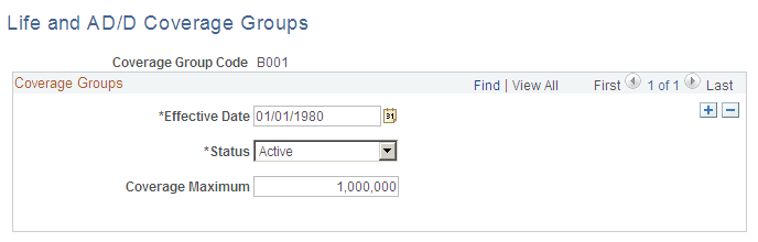

Use the Life and AD/D Coverage Groups page (COVERAGE_GROUP_TBL) to enter the coverage group code information that sets the maximum total life and AD/D coverage for a group of life and AD/D benefit plans.
Navigation:
This example illustrates the fields and controls on the Life and AD/D Coverage Groups page. You can find definitions for the fields and controls later on this page.

Effective Date |
Enter the effective date for the coverage maximum. Payroll uses the effective date to determine which coverage maximum to use for a particular processing cycle, according to the pay period end date. |
Coverage Maximum |
Enter the maximum total life and AD/D coverage. This amount applies to all the life and AD/D benefit plans that you associate with the coverage group code and that you associate with one benefit program. You connect a life or AD/D plan with a coverage group code using the Life and AD/D Plan table. |
