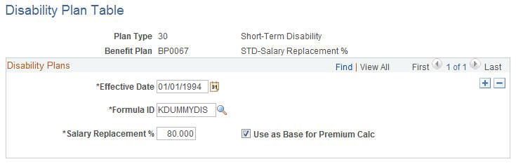

Use the Disability Plan Table page (DISABILITY_PLN_TBL) to define details for disability benefit plans.
Navigation:
This example illustrates the fields and controls on the Disability Plan Table page. You can find definitions for the fields and controls later on this page.

Salary Replacement % (salary replacement percentage) |
Enter the percent of employee salary that this plan will replace, limited to the maximum monthly benefit. |
Use as Base for Premium Calc (use as base for premium calculation) |
Select for the system to use the employee covered salaries to calculate disability plan premiums. When this option is selected, disability plan premium calculations are based on the salary replacement percentage of the employee's disability benefit rather than the employee's covered salary. This amount is still limited to the specified maximum monthly benefit. |
