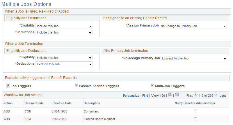

Use the Multiple Jobs Options page (BAS_MJ_OPTIONS) to define employee-level multiple jobs options to use automatically whenever a new job is entered into the system, or whenever an existing job is rehired or terminated through the Administer Workforce pages.

This example illustrates the fields and controls on the Multiple Jobs Options page. You can find definitions for the fields and controls later on this page.
When a Job is Hired, Re-Hired or Added
Field or Control |
Description |
Eligibility and Deductions |
Set default rules for whether new concurrent jobs are included or excluded during deduction processing and for Benefits Administration users to determine benefit eligibility. |
If assigned to an existing Benefit Record |
If an employee is hired into a concurrent job and the job is linked to an existing benefit record number, indicate whether the new job should be designated as the primary job. |
When a Job Terminates
Field or Control |
Description |
Set default rules for whether terminated jobs should continue to contribute information during deduction processing and for Benefits Administration users to determine benefit eligibility. |
If the Primary Job terminates |
Indicate how to reassign the primary job designation if the terminating job is the primary job. Values are: No Change: Don't reassign the primary job designation. Lowest Active Job: Reassign the primary job designation to the lowest active employee record number. If no jobs are active, the job with the lowest employee record number is designated as the primary job. Highest Active Job: Reassign the primary job designation to the highest active employee record number. If no jobs are active, the job with the highest employee record number is designated as the primary job. |
Explode activity triggers to all Benefit Records
Field or Control |
Description |
Job Triggers, Passive Service Triggers, and Multi-Job Triggers (multiple job triggers) |
For Benefits Administration users only. Select these options when you have an eligibility rule that applies to all benefit programs and that crosses benefit record numbers. For example, suppose that an employee holds four jobs, is enrolled in two benefit programs, and has two benefit records. If the employee experiences a job data change for one job, and eligibility rules cross benefit records, an event must be created for all benefit records. A change to a job in benefit record A might affect the employee's eligibility for benefits in benefit record B if any eligibility rule in the benefit program for benefit record B contains a grouping method of All Flagged. |
